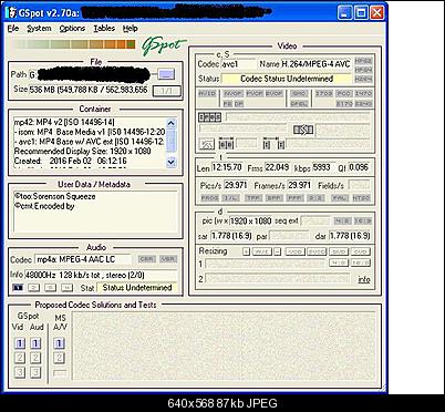

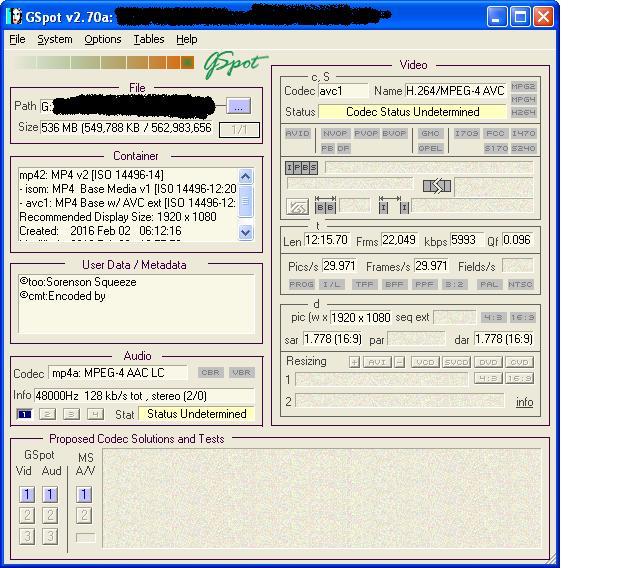

    Here is an example of a source file that I can't get to convert to the proper ration.

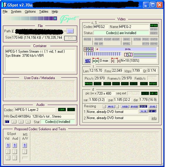

    Here is the GSpot screenshot for the first conversion attempt. In AVC, 'Basic Settings/Video Size' was 720x480 (because the purpose of the converstion is to burn the files to DVD). "Video Options/Video Aspect" was 16/9. The resulting video was fairly close to 16/9, but was obviously "squashed" from top and bottom.

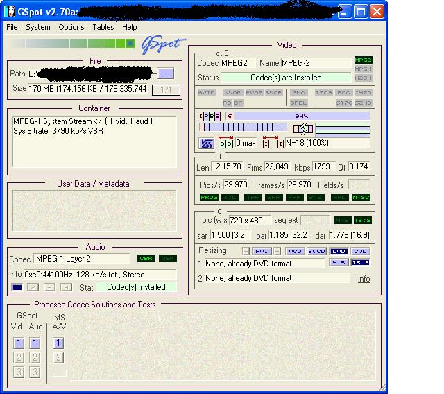

    Here is the GSpot screeshot for a second conversion attempt using the same source file. This time in AVC, "Basic Settings/Video Size' was 720x480. "Video Options/Video Aspect" was set at "AUTO". Same result - again fairly close to 16/9 but obviously "squashed" from top and bottom.
