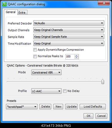

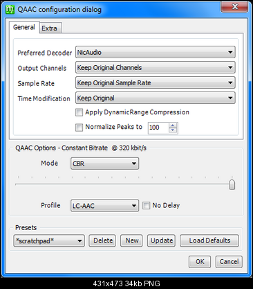

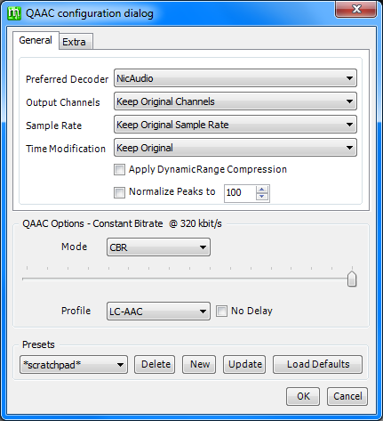

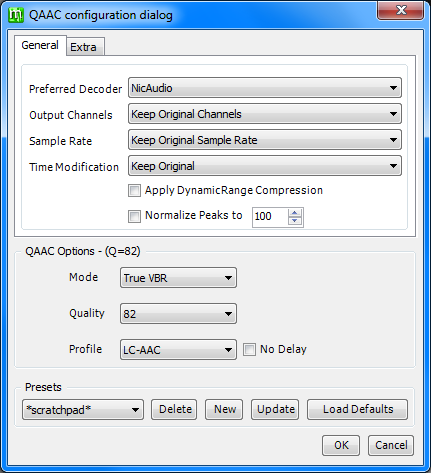

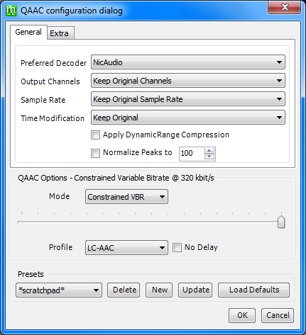

    So long story short I'm going to be encoding a bunch of movies and I want their audio to be as good as possible. The source audio is 5.1ch.
    Here are the 3 options I'm thinking about.
ID:	36922Click image for larger version
ID:	36923Click image for larger version
    Size doesn't bother me, but if one setting results in some scenes being noticeable quieter or lower in quality then that's a problem.

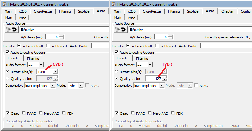

  5. This is the highest possible quality of QAAC settings
    I suggest to use Hybrid for this. This is the CVBR & TVBR settings
    If use command line, then you need ffmpeg & QAAC binary files.
    Here's the CVBR settings
    ffmpeg -y -threads 8 -i "inputfile" -acodec pcm_s32le -f wav - | qaac --no-delay --threading --cvbr 0 --quality 2 --adts - -o "outputfile.aac"
    Here's the TVBR settings
    ffmpeg -y -threads 8 -i "inputfile" -acodec pcm_s32le -f wav - | qaac --no-delay --threading --tvbr 127 --quality 2 --adts - -o "outputfile.aac"

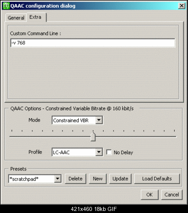

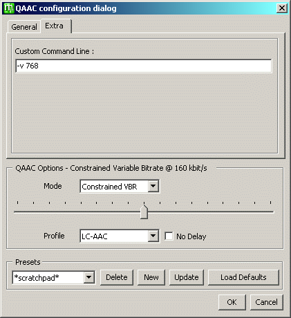

    Even though MeGUI's QAAC encoder configuration only lets you select a maximum of 320kbps as the bitrate, you can over-ride it and go higher by specifying a bitrate in the custom command line section under the "Extra" tab (anything added to the command line there should take precedence over any setting in the encoder configuration GUI, if they conflict). For example....
    -v 768 tells the encoder to use CVBR encoding at 768kbps.
    -a 128 tells the encoder to use average bitrate encoding at 128kbps.
    -c 256 tells the encoder to use constant bitrate encoding at 256kbps.
    -V 91 tells the encoder to use TVBR encoding with a quality of 91.

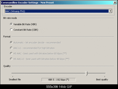

    Originally Posted by hogger129 View Post
    If you're just going with stereo, use TrueVBR -q91 (which I believe is ~192kbps). I like the Fraunhofer FDK AAC codec better which targets perceptual quality rather than target bitrate.
    As far as I know, QAAC's TrueVBR mode targets perceptual quality just as every other encoder's VBR mode does.
    ~192kbps is just a rough average you'll get from q91 when encoding stereo music.

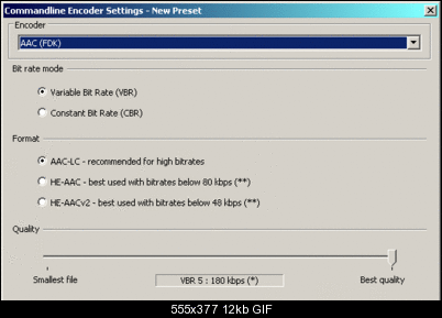

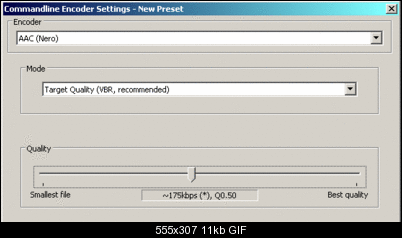

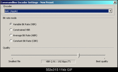

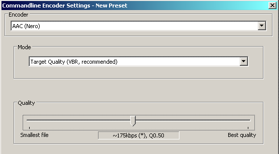

    Foobar2000 offers a similar guesstimation for each of the AAC encoders for which it has preconfigured presets.

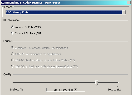

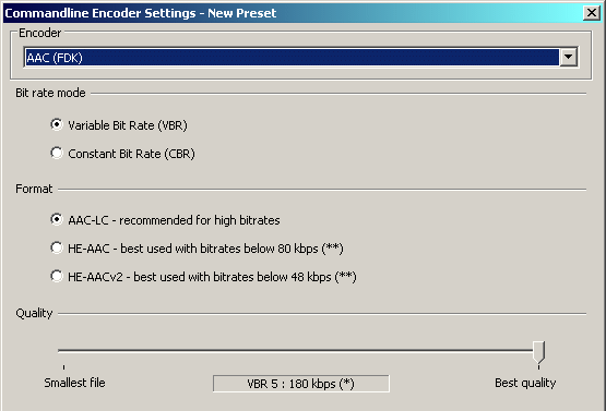

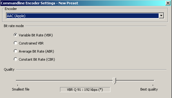

    Mind you for FDKAAC it's probably the least accurate for some reason. I find unless I change the default low pass filtering to something sensible, the bitrate for FDKAAC at the highest quality setting is generally much higher than foobar2000's guess (it's more like 225kbps).

    NeroAAC -q 0.40 = 132kbps
    NeroAAC -q 0.50 = 187kbps
