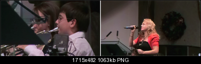

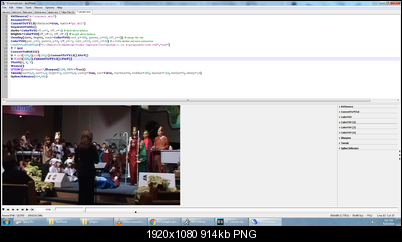

  1. Click image for larger version

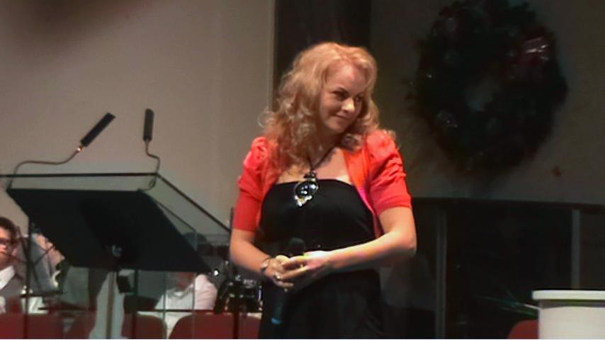

    They're everywhere in this one clip inside this room, in the other footage I have from the camera it's nowhere near as bad as this or I haven't even noticed it, over here it's in your face with yellow spots; everybody looks like they have an infection. I don't know if it's the lighting or something, the camera was dusty...but yeah.
    The script I'm using:
    AssumeTFF()
    ConvertToYV12(interlaced=true, matrix="pc.601")
    QTGMC()
    Tweak(hue=0.0, sat=1.6, bright=4, cont=0.9, coring=True, sse=False, startHue=0, endHue=360, maxSat=150, minSat=0, interp=16)
    Spline36Resize(854,480)
    A fix in Avisynth would be preferred, but I can try dabbling in Vdub filters if that'd be better.

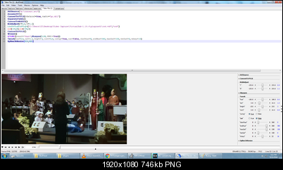

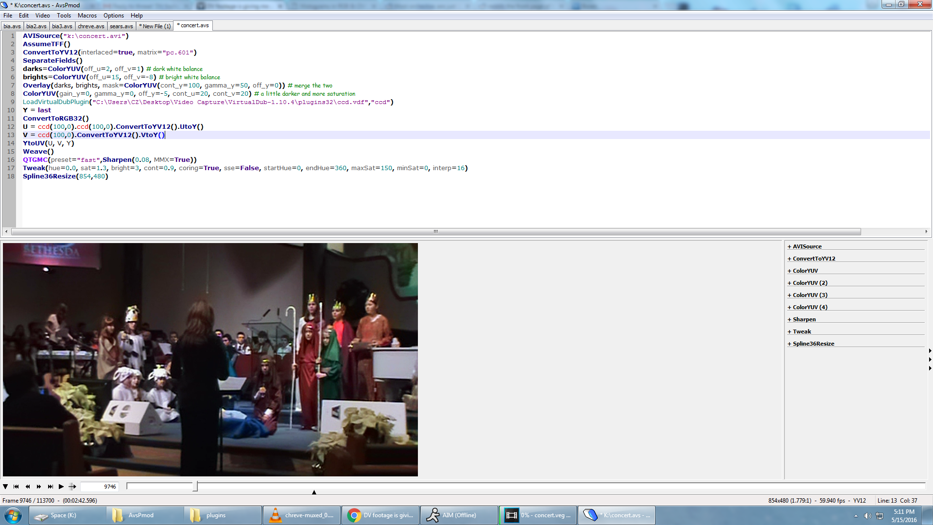

  10. Wow, thank you. Okay, here's what I came up with, let me know if it all looks good please:
    AVISource("k:\chreve.avi")
    AssumeTFF()
    SeparateFields()
    darks=ColorYUV(off_u=0, off_v=0)
    brights=ColorYUV(off_u=16, off_v=-3)
    Overlay(darks, brights, mask=ColorYUV(cont_y=100, gamma_y=100, off_y=0))
    ColorYUV(gain_y=-20, gamma_y=50, off_y=-15, cont_u=50, cont_v=50)
    LoadVirtualDubPlugin("C:\Users\CZ\Desktop\Video Capture\VirtualDub-1.10.4\plugins32\ccd.vdf","ccd")
    Y = last
    ConvertToRGB32()
    U = ccd(100,0).ccd(100,0).ConvertToYV12().UtoY()
    V = ccd(100,0).ConvertToYV12().VtoY()
    YtoUV(U, V, Y)
    Weave()
    QTGMC(preset="fast",Sharpen(0.08, MMX=True))
    Tweak(hue=0.0, sat=1.8, bright=8, cont=1.0, coring=True, sse=False, startHue=0, endHue=360, maxSat=150, minSat=0, interp=16)
    Histogram("classic")
    trim(11797,12454)
    Attached are 4 files: one of the regular script, one with the classic histogram, one with the levels histogram and one of me scrolling through it in preview mode with the histogram on. Does everything look fine with these? I'm still trying to figure out how to decipher the colors in the levels one for instance and if if it's good to be just a tad bit close to the edge in the classic view without touching the sides.
    What do you think?

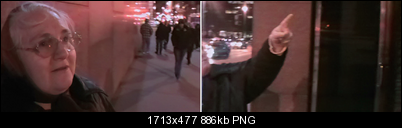

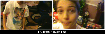

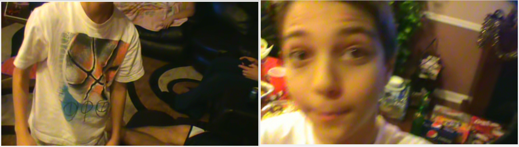

    I sometimes don't know what I should do. Would you change the hue on this? Both are from the same event, hue set at 0:

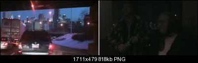

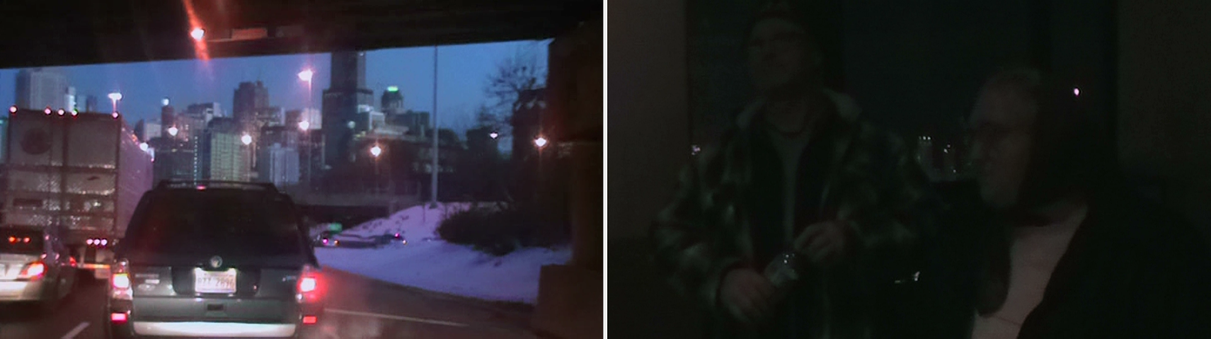

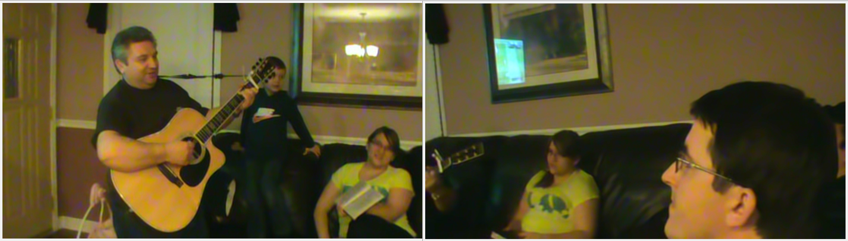

    Then these 4 are from night/outside:
    And should I add the camcorderdenoise to all the videos from this camcorder since it showed me problems with the indoor footage?
    edit: and I noticed you didn't put the ConvertToYV12() you said to put after the ccd is over in post #3, should I put that in after ccd, "YtoUV(U, V, Y)" or "weave()"?
  18. I don't think a hue=10 adjustment would be appropriate for most of those shots. The yellow cast on the earlier shot may have been from the lighting conditions. Typically incandescent lights give a yellow/red cast, fluorescent lights a blue/green cast.
    ConvertToYV12() was used on the U= and V= lines.
    Only use filters when you need them.

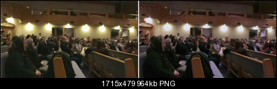

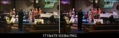

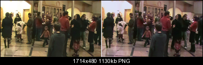

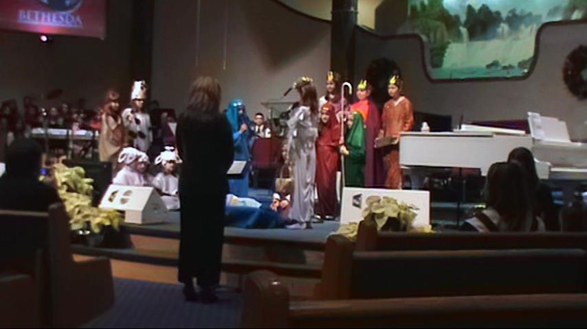

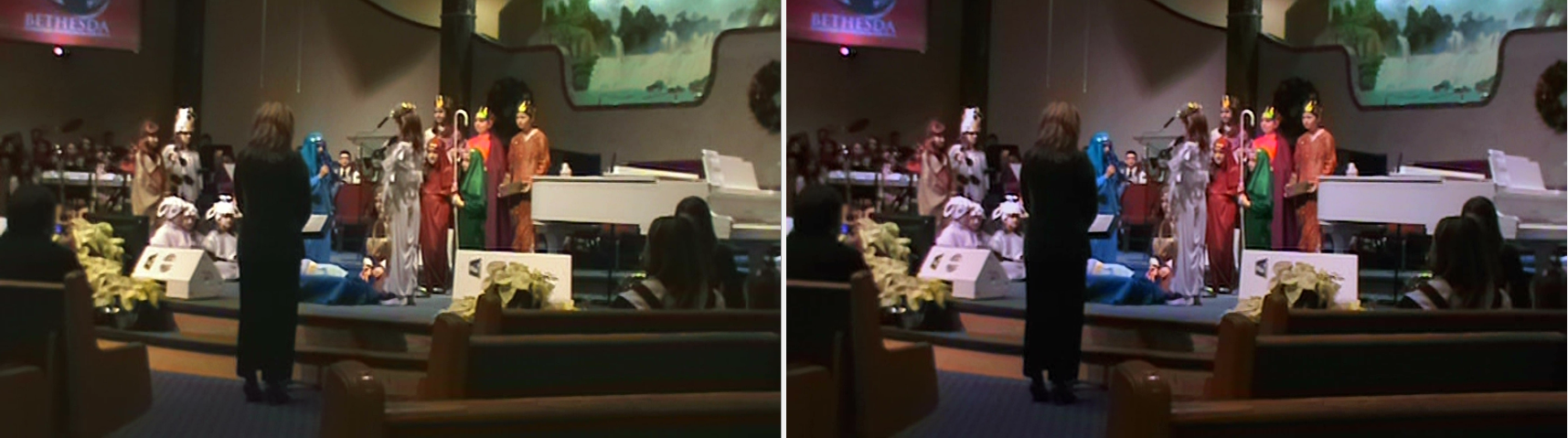

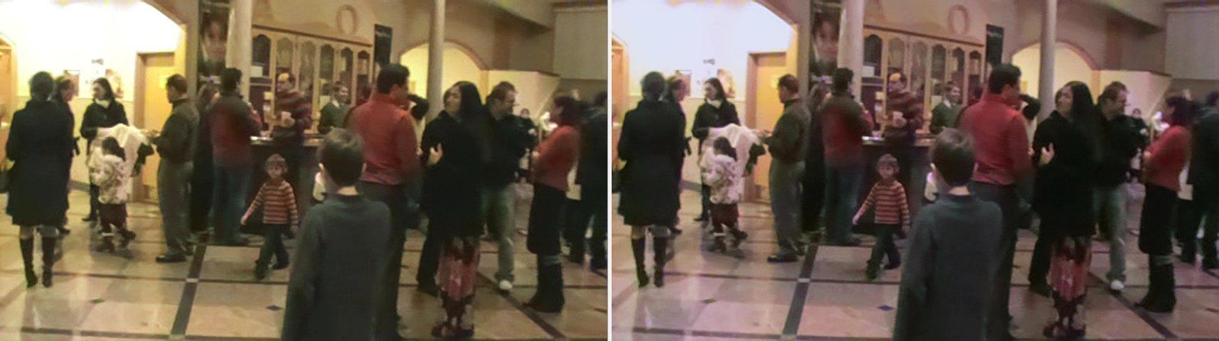

  19. So it turns out those recent screenshots aren't what they naturally were, I forgot I had added everything you sent me into everything else as I thought it was all part of the CCD effect and wasn't aware this part of your code changed the mood/tone:

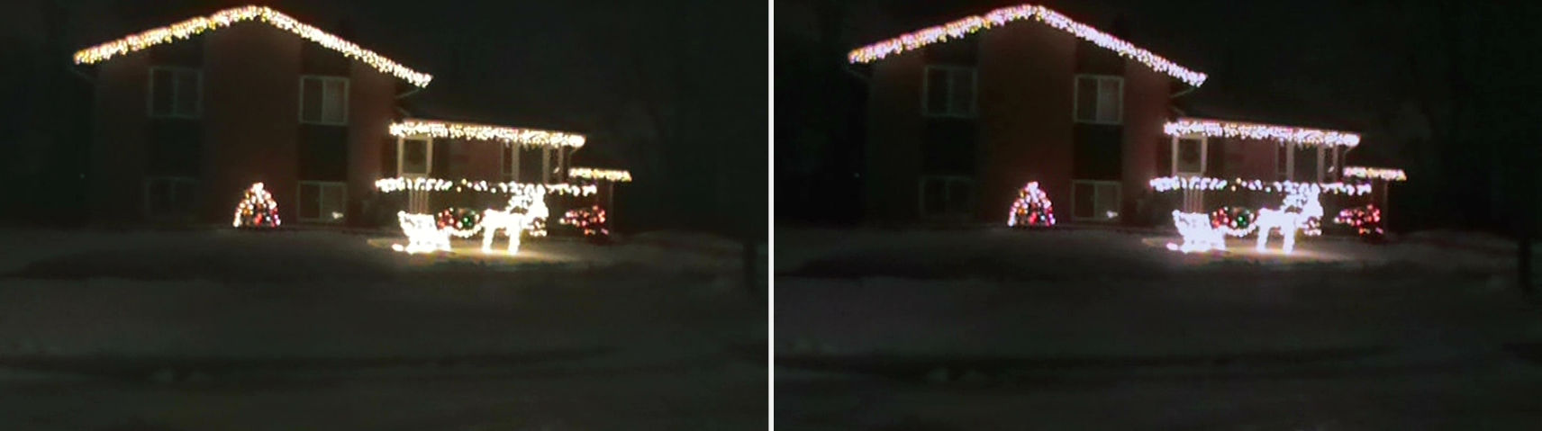

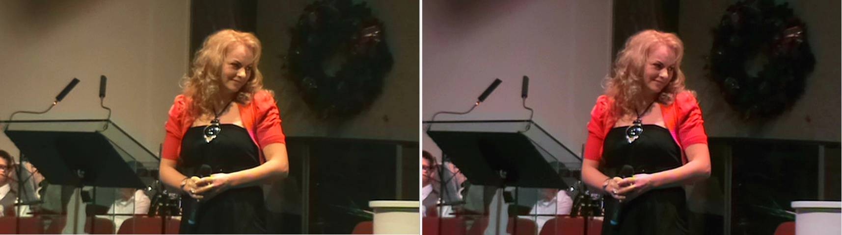

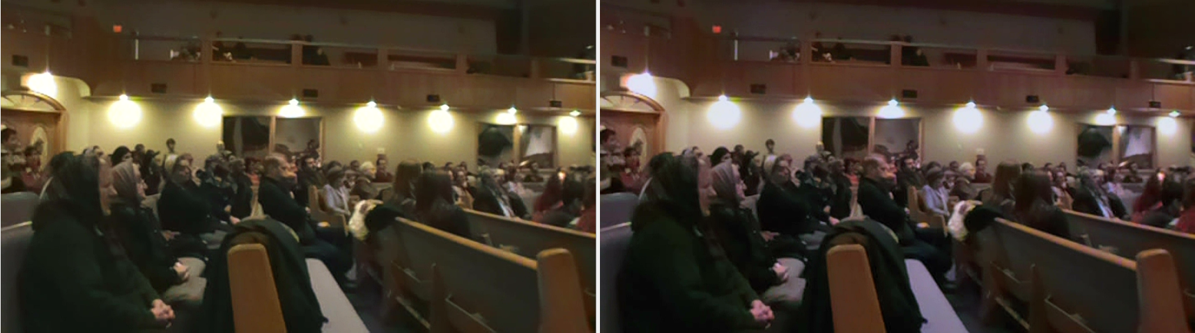

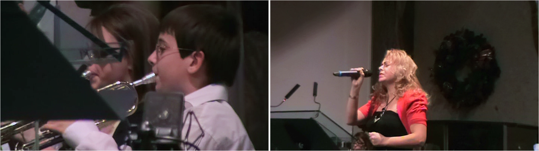

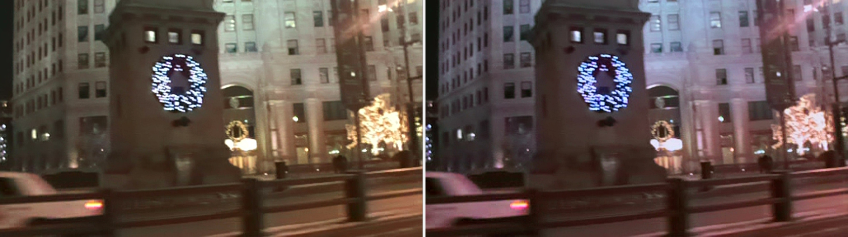

    Left is what it is with it out, right is what it is with it in:

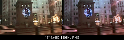

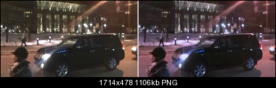

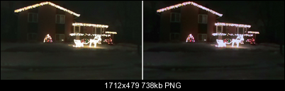

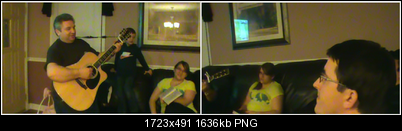

    On one hand the original looks like it's exhibiting the right colors...on the other hand the right side looks like it's more natural. But I don't know if that's just because your code seemed to make everything cooler and bluer.
    Which brings me back to what you said:
    You adjust everything as needed and desired. The original lighting, the camera that shot the video, the settings on the camera, the playback device, the capture device... all those things effect how the video looks. Then there's the issue of how YOU want it to look. Do you want natural daylight colors? The actual colors under which the video was shot? Some other colors to set a mood?
    That's thing thing, I don't know what I'm supposed to want, do or what is right... Are the actual colors under how these videos were shot...wrong because they go more towards the yellow path? I.e. the crappy camcorder shot it in the wrong, bland colors. Did that piece of the code "fix" and make it more realistic as to how the colors should be? If that's the case, that's what I want. But if not then what should I do...is there another common code for another "natural look?" Do the ones on the right seem more right because they're more on the cool side?
    Then there's the question if this is applicable to the videos filmed with this camera outside in the daylight, in the night, in another type of room...should this be used for daylight scenes too or how do I get the "natural daylight colors"? Is there a resource somewhere with codes like the one you provided for basic camcorder video 'fixes'? Or codes for like "natural daylight colors", "mood colors", etc. Trying to decipher this puzzle is a nightmare when you don't know what half of this means, all I'm doing is copying and pasting what you're giving me but I don't know other variations or what is supposed to be right...like those white clothes and piano in the first picture. On the left they look white...-tan. On the right they still look white...yet pretty blue...but still sort of normal? They both look correct though, that's the mind-numbing part. I'm going mad over here, I must have inserted these codes, taken out, altered, previewed, encoded for hours, erased, over and over 100 times.
  20. You're looking for a technical answer to an aesthetic question. How you think it should look is extremely subjective. Your "before" and "after" pictures above are well within the range of acceptable. Some people may prefer the warmer, some may prefer the cooler -- but neither is wrong. If you look at the color of most Hollywood films these days they are wildly outside the range of "natural."

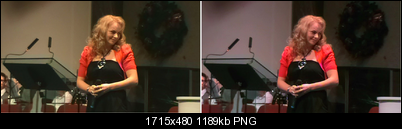

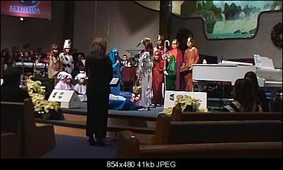

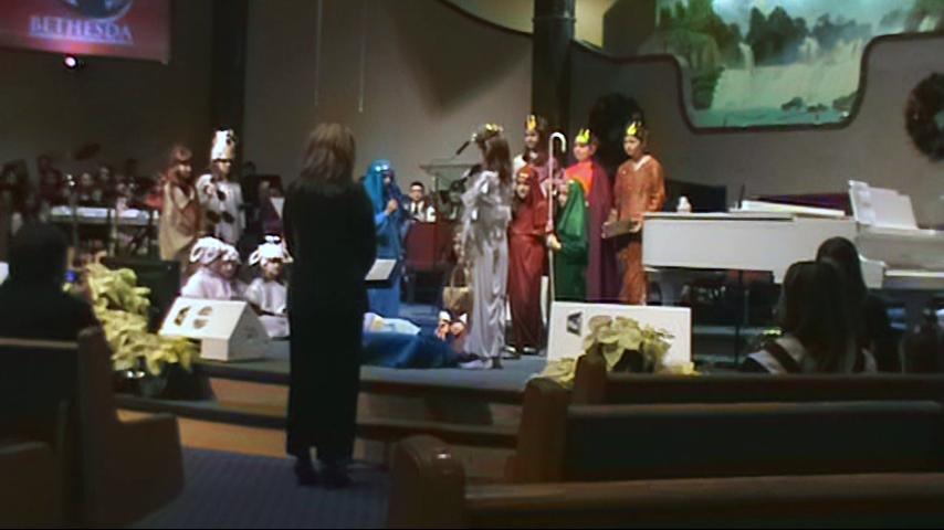

  21. If you're looking for more natural colors, in the second image I used
    darks=ColorYUV(off_u=2, off_v=1) # dark white balance
    brights=ColorYUV(off_u=15, off_v=-8) # bright white balance
    Overlay(darks, brights, mask=ColorYUV(cont_y=100, gamma_y=50, off_y=0)) # merge the two
    ColorYUV(gain_y=0, gamma_y=0, off_y=-5, cont_u=20, cont_v=20) # a little darker and more saturation

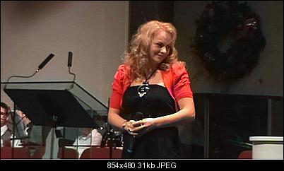

    I assumed the woman in the foreground was wearing black and the piano should be white. I think those settings looked acceptable (though a little over saturated?) for the first image too:

    If you mean holding up something white in front of the camcorder's lenses (which is what I think you're saying) then that's implying I'm using this camera for recording currently...these are videos from my uncle's old 2010 camcorder I took out of it, it's not being used for recording anymore (thank God lol).
    Okay, yeah, now that looks great and realistic! If I wanted the natural colors in everything else from this camcorder would this be the code to use? Even for say daytime scenes, night time scenes, that first scene this thread started off on about? Since it seems to make the whites actually appear white it's also doing the same for everything else, yeah?
    The saturation is set to 1.4 on the tweak in there, still seems like too much? I can provide pics of 1.1 (too dull) to 1.4 if you want since you seem to be spotting something wrong from your initial eye test.

    Okay, yeah, now that looks great and realistic! If I wanted the natural colors in everything else from this camcorder would this be the code to use? Even for say daytime scenes, night time scenes...
    No, it's specific to that shot and others like it. It doesn't work well for the outside/night shots.
    It doesn't necessarily mean the colors of everything else is correct. There are many ways the white balance could be off. The method I used to "fix" it may not have been right. Or maybe the piano and the rear walls weren't white. We don't know exactly what color anything is supposed to be -- except maybe a range for the skin tones. That said, overall the colors don't look too unrealistic after the given white balance and minor black level and saturation adjustment.
    I didn't use Tweak at all. I started with your "before" images and applied the filters I listed. ColorYUV(cont_u=20, cont_v=20) is about the same as Tweak(sat=1.08).

  25. No, it's specific to that shot and others like it.
    I used it on the first scene as well with the guitar and the boy and it seems to work well, because it also had a yellow lighting tone. So I guess those 2 shots are like each other..?
    What does work well with daytime/night time shots then, to get natural colors in those instances? If you could provide basic guideline codes you use like this white balance one for indoor shots it'd be great, unless there's an already typed out resource/link somewhere with a set of them you can send my way so I can plug in and play/experiment with a variety of codes. I have a ton of outdoor sequences, ones in the dark, etc. and want natural colors for all of them to the best of it's ability. I'd rather me insert them and see what they look like than ask you for every single shot, y'know?
    I actually asked my cousin about it and he then proceeded to...send me a picture of the piano...in his living room. Apparently that same piano was sold to him, lol. Now what are those odds? But it's safe to say it's white.
    I meant on the before images as well, I had Tweak on all of them with 1.4 saturation already, the only thing that changed from the befores and afters was me adding in your white balance code.
    So, in summary, you are chasing a dream if you think you can match real-life color. Yes, you can match what you remember that color to be, but as soon as you realize that is what you are doing, you will then understand that you are making an artistic decision -- your artistic decision -- as to what you think best represents the original color.
    Thanks for the long explanation btw.
    Then in terms of common codes (or how to make them) for natural daylight/night colors, different moods, etc. which hearkens back what I was just asking, is there somewhere that has a list of common ones so I can plug in to see what works best? I like the two that jagabo provided, but for other situations are they available somewhere for simpleton beginners like me? I don't know what I need to alter for daytime natural colors like you guys can do at will, for night time looks, different variations for all of those. If I have the options available to me, then I'll make the artistic decision on my own after inserting them one by one, but I don't know how to create these options for different looks/feels/naturalism other than the two jagabo posted here.
  26. Originally Posted by CZbwoi View Post
    There's no such thing because the colors problems differ because of what I said in post number 16.
    Find something that you think should be white. Adjust the colors to make that object is white. Using an RGB histogram will help. Let's start with your 2.png image in post #19 (cropped to just the left half) and assume the piano should be white. Crop a small portion of the image so you only have the piano: Crop(618,208,32,32). Then use HistogramRGBLevels() to view an RGB Histogram:
    At the top left is the little patch of the piano, on the right are the RGB histograms. As you can see, reds are brighter than the greens, and blues are darker. So apply the RGBAdjust() filter, decreasing the reds, and increasing the blues RGBAdjust(r=0.93, b=1.14). Now the RGB histogram looks like:
    Now remove the cropping and look at the rest of the image:
    It's not always this easy but that's a start. You can now adjust brightness, contrast, hue and saturation as necessary.
  27. Everything you did is not happening for me, whatever I try to adjust in RGBAdjust() changes the hue of the entire thing including the HistogramRGBLevels() diagram. The level meters do no move at all...
    I also had to open it up in a new script because I don't know where to insert it into my current script, I get errors if I place them both after converttoRGB32, it points to the YtoUV line (video width ratio does not match any internal colorspace)...which leaves me having to erase everything that comes after it. I don't want to erase everything I have there so I had to paste it somewhere else for the time being.
  28. Formerly 'vaporeon800' Brad's Avatar
    Apr 2001
    Vancouver, Canada
    RGBAdjust needs to come before HistogramRGBLevels, not after.

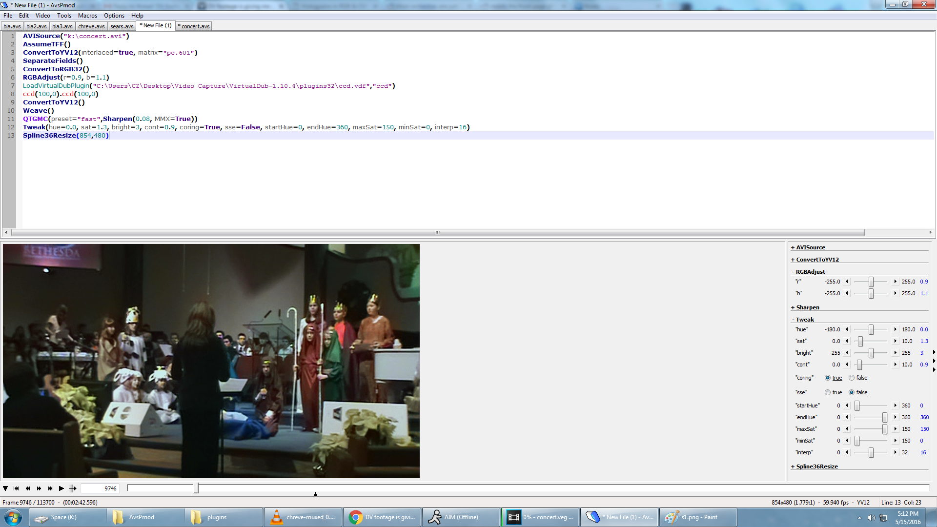

  29. What's the script you're using now? If it's like the script in post #9 the RGBAdjust is meant to replace the darks=, brights=, overlay sequence. But the video is YV12 at that point so it needs to be converted to RGB. You're converting to RGB later for the ccd filter and you want to avoid multiple YUV/RGB conversions. So I'd try changing this sequence:
    SeparateFields()
    Y = last
    ConvertToRGB32()
    YtoUV(U, V, Y)
    Weave()
    to:
    SeparateFields()
    ConvertToRGB32()
    ConvertToYV12()
    Weave()
  30. RGBAdjust needs to come before HistogramRGBLevels, not after.
    Ah, novice mistake. I was doing everything in order literally as jagabo said it.
    jagabo:
    - Alright, I did so but now it looks different/worse than the original version you had with the darks/brights, it's more bland. I'd increase the saturation tweak it's at now of 1.3 to even more, but I don't want to make people look orange anymore. Is the original method you did in YUV better than this RGBAdjust way?
    - When I want to crop only a small part of the screen that could be white, how do I so do so without mindlessly guessing random dimensions? I don't know how you could've gotten the numbers Crop(618,208,32,32) of the piano unless you were able to rectangular marquee it somehow and it generates the numbers for you...
    - If I run into a video with no definitive white parts I can work with, and I can't "fix the white color balance", what's the next cause of action to fixing the colors to get it all right? Another specific color I jump to try to guess and alter? Using RGBAdjust or some other way?
    - You always alter the red and blue part of the RGB, no green. Is this generally how it is and I shouldn't mess with the green?
    - In your post, you moved the red and blue levels to line up exactly with the green one, the goal is to always have them lined up straight, correct?
    - For my night scenes, like the last couple pics in that list of pics I provided, you said I'd have to do something different other than finding a white balance like I'm doing here in these indoor rooms. What would I need to do or look for to fix in those clips to obtain the natural colors I want?
