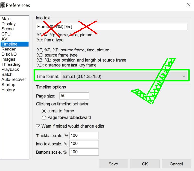

    When time permits I am using VirtualDub2 more and more, but there are a couple of disappointments that maybe I should be able to solve myself but have not succeeded.
    (1) How do I change the Info Text from Frames to Timeline hours/minutes/secs? I see format options for both Frames and Time in Preferences but not how to display the time - eg, length with time elapsed and remaining. That would be an immense help.

  5. Hi, glad it works in some way.
    Time: not sure what you ask: there is no option for remaining time but the closest you can get is "h:m:s.t / total" which shows time passed and total time.
    (h:m:s stands for hours:minutes:seconds)
    [Attachment 48518 - Click to enlarge]
    You can change it from the display itself too (right click).
    Transitions: there is really no way, possible options are avisynth or some mixture of filters and hacks, all this is not really user friendly.

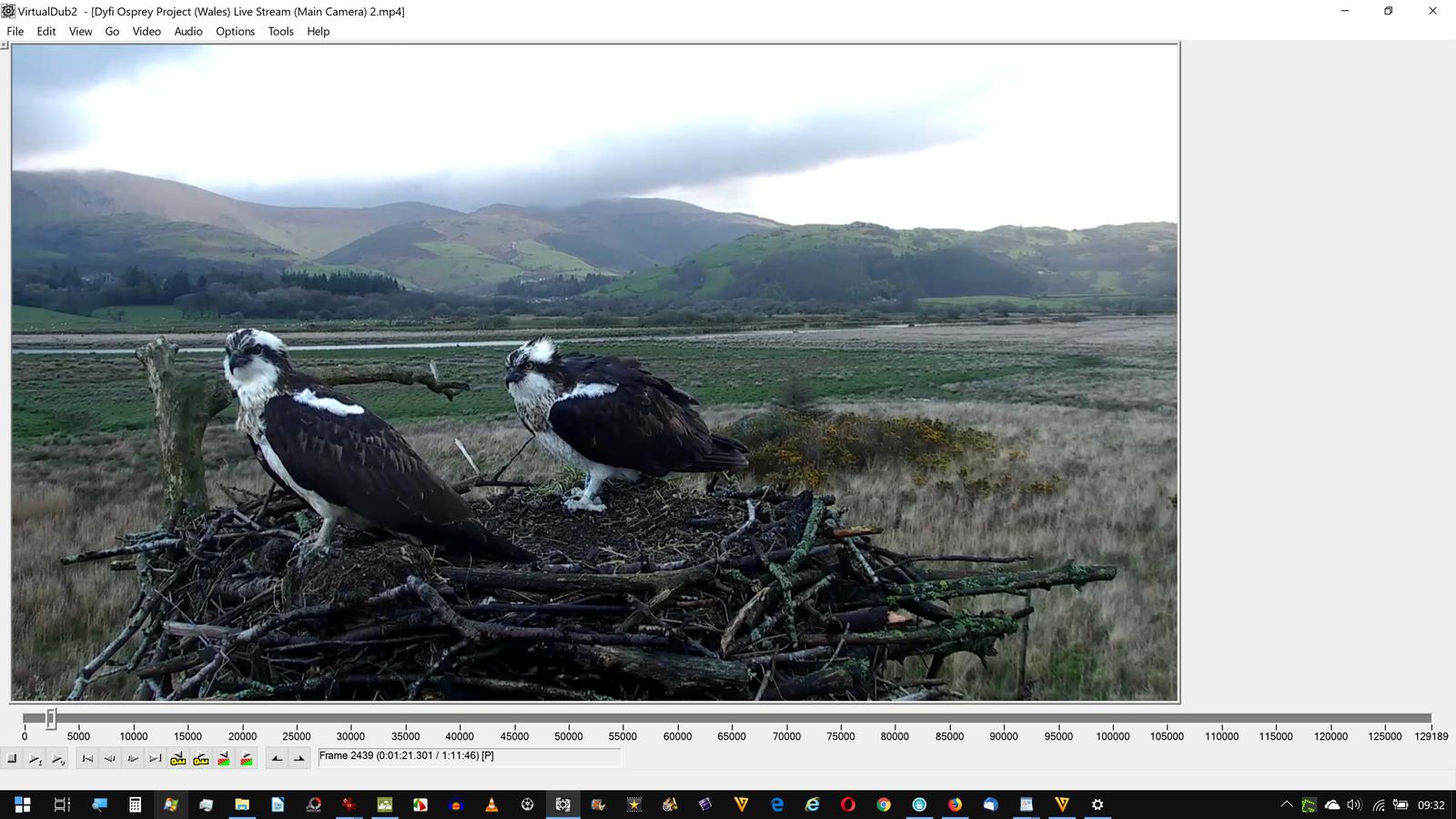

    I am working on a 3840x2160 display, and it is hell, many programs' GUI is too small to read. I have changed VD2's "high DPI settings" to System (Enhanced) and that improves it a lot but the icons are still very small. Therefore I only recently discovered that you have buttons for Start and End selection, which is super.
    Would it be possible to have a DELETE button there too? That would save having to go up to the Edit menu and select Delete. It would save a lot of time.
    This is my desktop (15" Dell XPS 9560) - you can see how small the text and icons are.
    https://forum.videohelp.com/images/imgfiles/XEliL1r.jpg

  7. Originally Posted by clemenzina View Post
    Why don't you use the hotkeys?

  8. Originally Posted by clemenzina View Post
    Actually to me this screenshot looks normal.
    But did you try to change buttons scale in preferences->timeline (at bottom https://forum.videohelp.com/images/imgfiles/3qbv9eA)
    Adding new buttons to toolbar is annoying because I need to paint buttons and then provide GUI to add/remove buttons because others may not like the bloat.
    (I would rather remove some existing buttons).
    Also using keyboard (home, end, delete) is much more productive than toolbar.

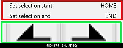

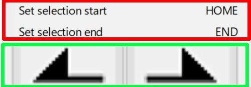

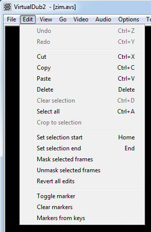

  10. Originally Posted by clemenzina View Post
    My Home and End button do not activate anything
    Home is Edit -> Set Selection Start, End is Edit -> Set Selection End. The hot keys are indicated on the menus:
    [Attachment 48565 - Click to enlarge]
    Jan 2010
    I was using the Edit menu before discovering the buttons, which I couldn't see very well (now they are enlarged, yippee).
    It's my keyboard Home and End hotkeys which do not do anything, but the Delete does work and that speeds things up a lot!
    On my keyboard I have to use Fn+Home and Fn+End, which is such a nuisance that I don't mind not being able to use them.
    Thank you for trying to guide me, Jagabo
  12. Originally Posted by clemenzina View Post
    That's the fault of your keyboard, not VirtualDub2. It might have a function lock key.

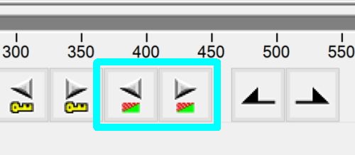

    REQUEST
    These fast-forward and -back buttons would be immensely useful for seeking if only the video would play while they are operative.
    Whether that could be implemented or not, I feel I must donate some pennies towards the upkeep of this wonderful project - despite the lack of some features which I have to use another editor for, I am so grateful to Shekh for rescuing me from a fate nearly worse than death
    But I cannot find any donate link ???
  17. These buttons on toolbar are linked to scene detection (keyboard commands Edit.GoToPrevScene / Edit.GoToNextScene)
    While the buttons cannot be redefined you can redefine keyboard keys:
    Edit.GoToPrevFast / Edit.GoToNextFast: moves frame cursor as fast as possible while you hold the key.
    Edit.GoToPrevFastSticky / Edit.GoToNextFastSticky: same but continues after you release the key.
    Edit.SeekStop: cancel any movement (scene, fast seek, preview).
    For myself I setup it this way:
    J = Edit.GoToPrevFast
    K = Edit.SeekStop
    L = Edit.GoToNextFast
    (JKL is popular controls in some programs like Vegas)
    Alt+J = Edit.GoToPrevFastSticky
    Alt+L = Edit.GoToNextFastSticky
    Donate link: I don't have it, but thanks for asking. I sent you pm.

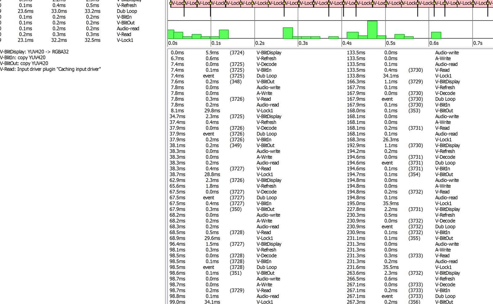

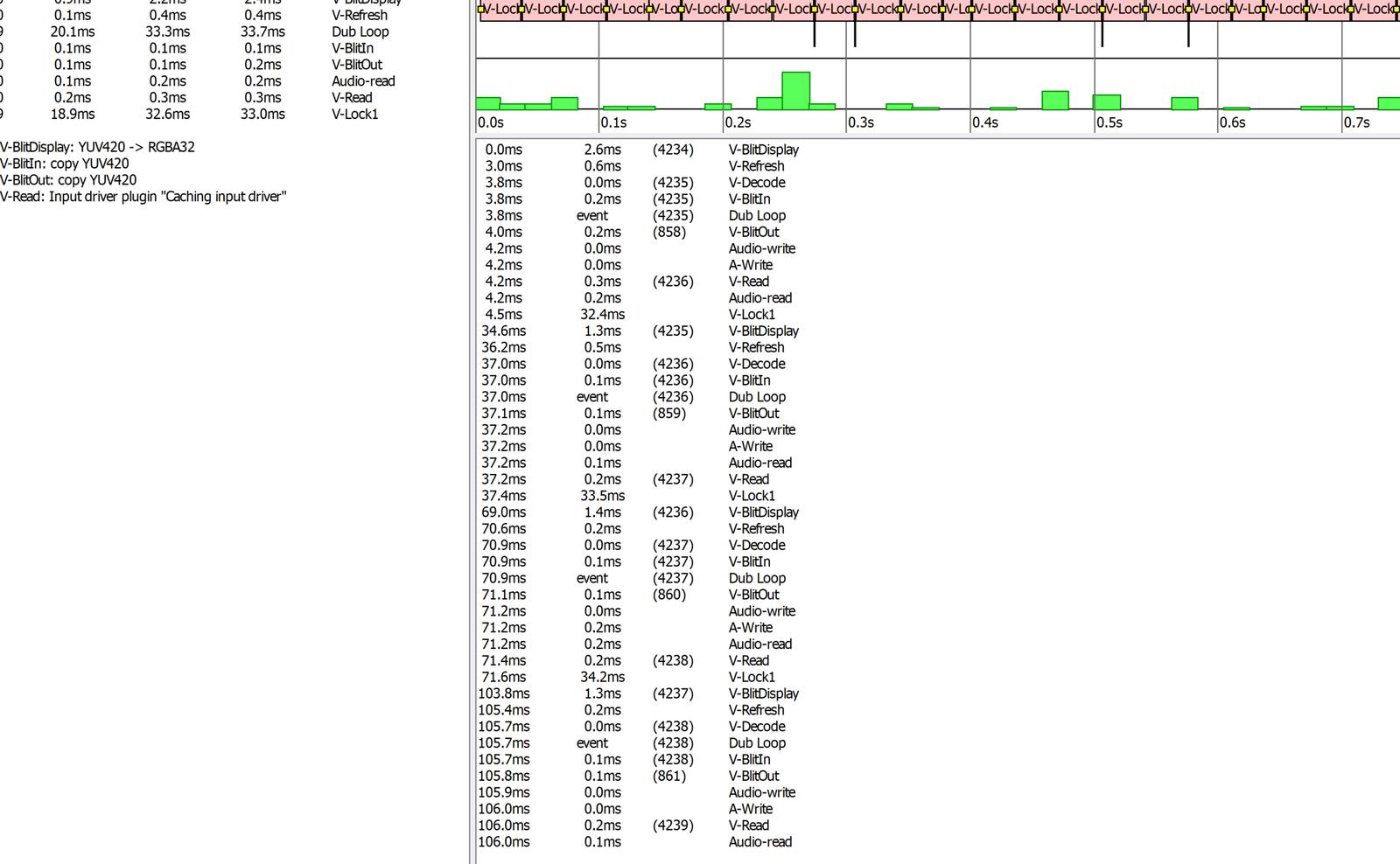

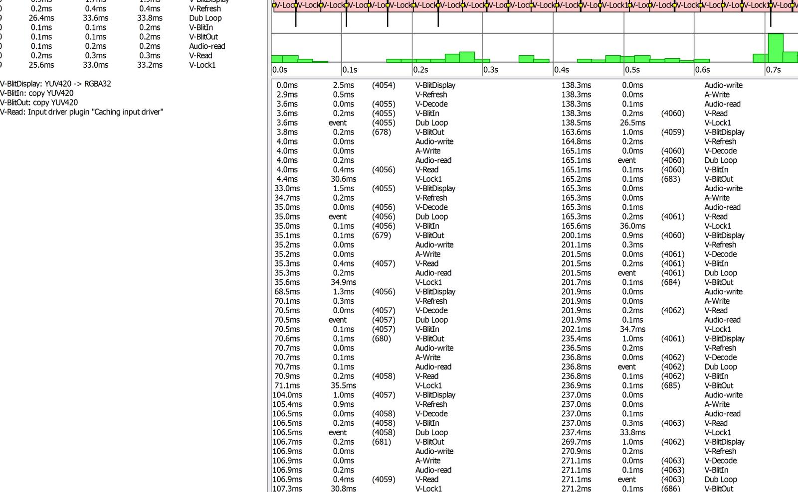

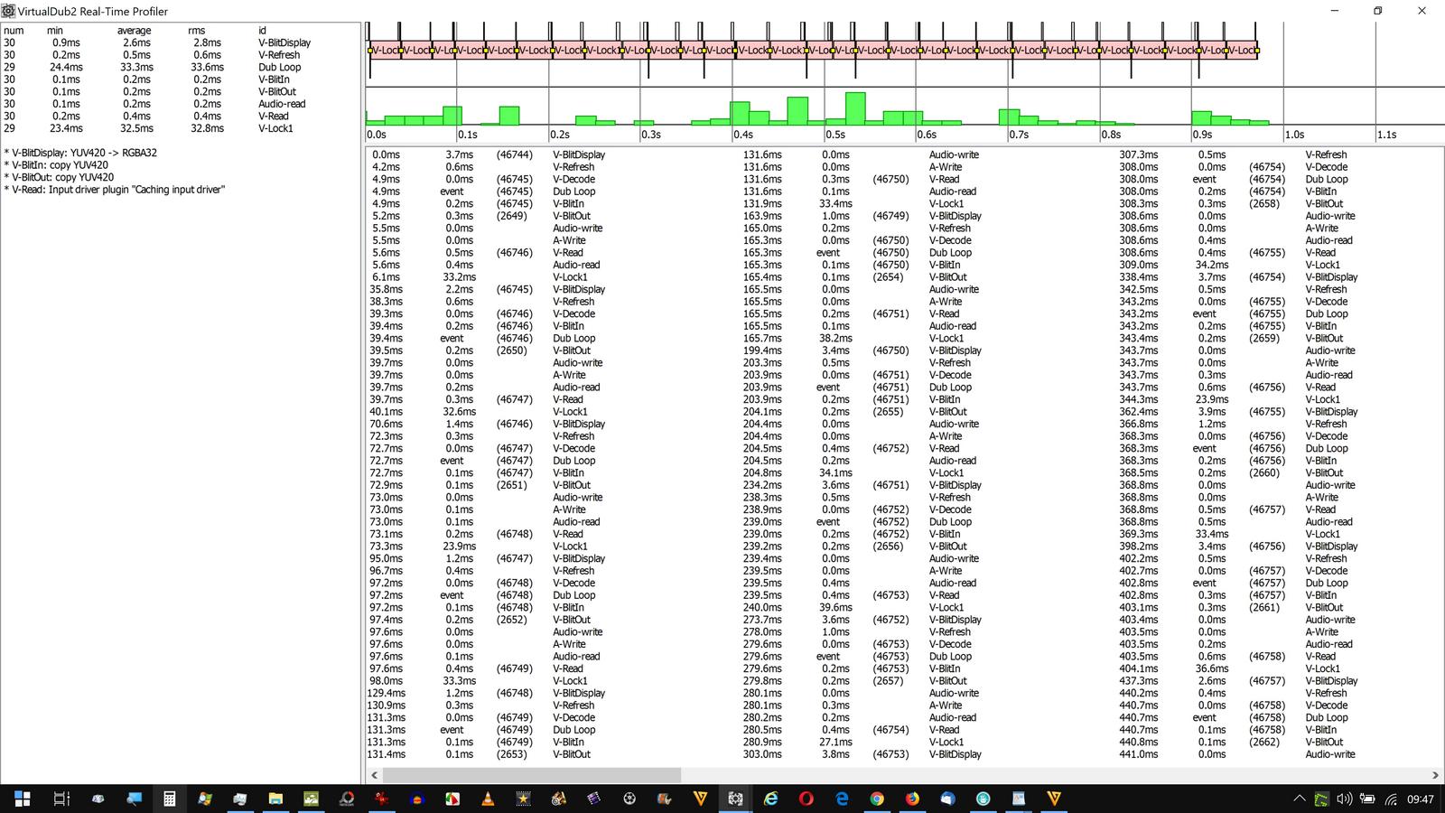

    I have hit a very serious problem, as far as the way I use VirtualDub is concerned. This is going to be difficult (for me!) to explain, so I hope you can visualise what I mean.
    Normally I work with long clips of 1 to 6+ hours. I open them in VD2 and scroll thru and mark the start and end of an "interesting bit" and save it. Then I undo the edit and continue thru the same clip repeating as necessary. (I join with fade transitions in MovieMaker.)
    When I've finished that clip, I close the video file and open the next one and repeat. I've been doing this for months.
    When I get to an "interesting bit" I need to play it @ 1x speed, so's to check exactly what's happening and accurately cut it.
    Suddenly about a week (?) ago, I can only play the video when cutting if it's the first video file that I've opened. The sound continues but the picture is still, until I click the Play button again and then it skips to the current point. I cannot play the video file any more until I close it and reopen in a new copy of VD2.
    A few days ago I updated VD2 to the latest version, 43602, it made no difference.
    This means that the 1x speed is performing the same as the FF - no picture plays but the file is playing unseen - and I need to SEE!
    I have delayed asking about this because, deep down, I feel there is no solution and I have lost this precious resource :'(

    You probably can shed some more light by doing the following:
    When you press preview and the picture does not update, open "View->Real-time profiler" and make some screenshots. Also open "View->Show status window" and make screenshot as well.

  28. It's ok with VirtualDub64.exe, I thought maybe 32-bit version develops some memory issue after long use. But that is not the case obviously.
    I try to rephrase: as soon as you get play/preview problem, don't stop preview, go to main menu, View, Real-time profiler. This will open another window with various performance data. Expand this window as large as possible and make screenshot of it. Since it is updated periodically, several screenshots can be better than one. Then maybe I will see something unusual and get any idea.
  29. Member
    Jan 2010
    I only did one at first, then noticed that you'd asked for more so I re-opened the same file and repeated for the subsequent 3 screenshots.
    https://forum.videohelp.com/images/imgfiles/hDLlg6N.jpg
    https://forum.videohelp.com/images/imgfiles/uBxEf0c.jpg
    https://forum.videohelp.com/images/imgfiles/aJRfqgg.jpg
    https://forum.videohelp.com/images/imgfiles/Rzf5Aca.jpg
    Up to the point of the first screenshot it had been performing beautifully
    Also - I had wondered if the problem occurred only when using a second copy of VD with the first still open, but that's not so, as this time only one copy is open. (This is unrelated to VD, but since Windows10 1803 I've had severe network problems and I have to keep a copy of VD open to maintain the connection with one laptop which keeps dropping off the internal network.)
    Thank you
  30. Originally Posted by clemenzina View Post
    Thanks. It looks like everything is working properly except you are using sub-optimal display (the video frames are read at proper rate and should be reaching output window, but for some reason this has no effect?).
    Check these recommended (by me) options: https://sourceforge.net/p/vdfiltermod/wiki/display/
    If you had "overlays" or "opengl" on this probably was related to issue.
    Also it seems you are using either "Input display" or "Both panes". Try switching to "Output only".
    Main menu -> "View->Pane Layout->Output pane only"
