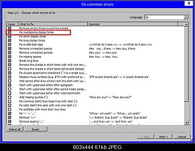

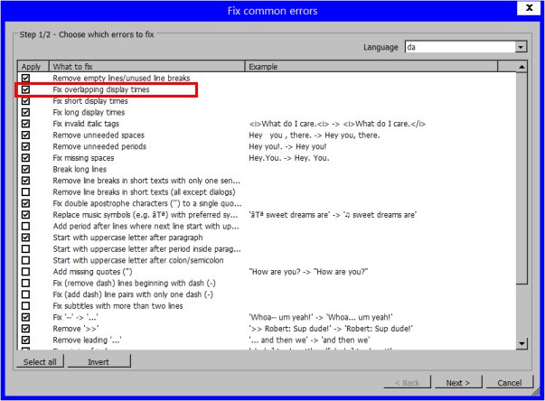

  7. Tools -> Fix common errors
  8. I tried that - it didn't work. It didn't show up on the list of recommended fixes.
  9. Can't you just tick it?

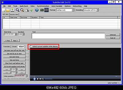

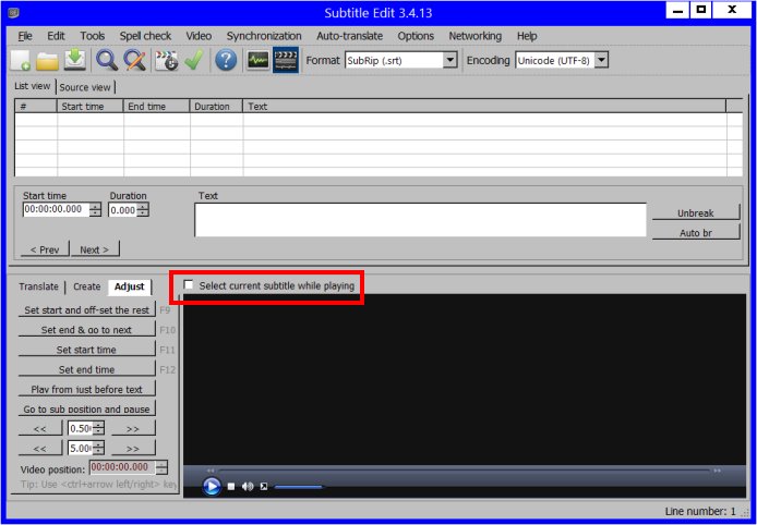

  10. I straightened that out, but now another issue - I did have it set so the text window would highlight each text line in sync with video the position , but now I have to manually select the text line. How do I change it back so that it follows the video position automatically?
  11. Tick "Select current subtitle while playing"
