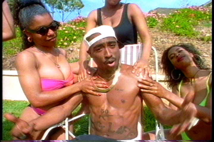

    I recently captured some video from some NTSC DV tapes. The issue I have is that the colour looks too pale. I've tried doing some colour correction using VirtualDub however it is quite subjective and I'm concerned that I'm using the wrong settings altogether. I'm unsure whether its, the colour, gamma, luminence, chroma that needs adjusting.

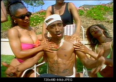

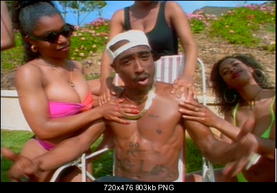

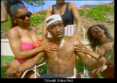

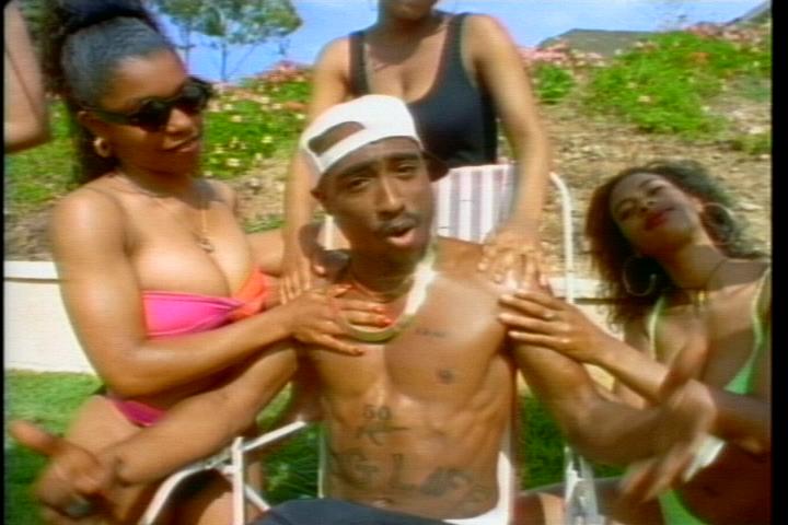

    The first pic is frame 488 from the source file. The Second pic is the same frame from an alternative version of the same video.
Name:	Frame 488 - Source.png
Name:	Frame 488 - Alt.png

    The second image is overdone, and now has too much red.

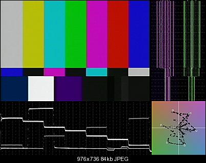

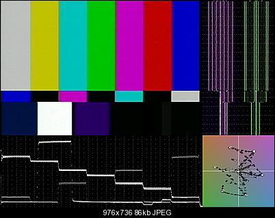

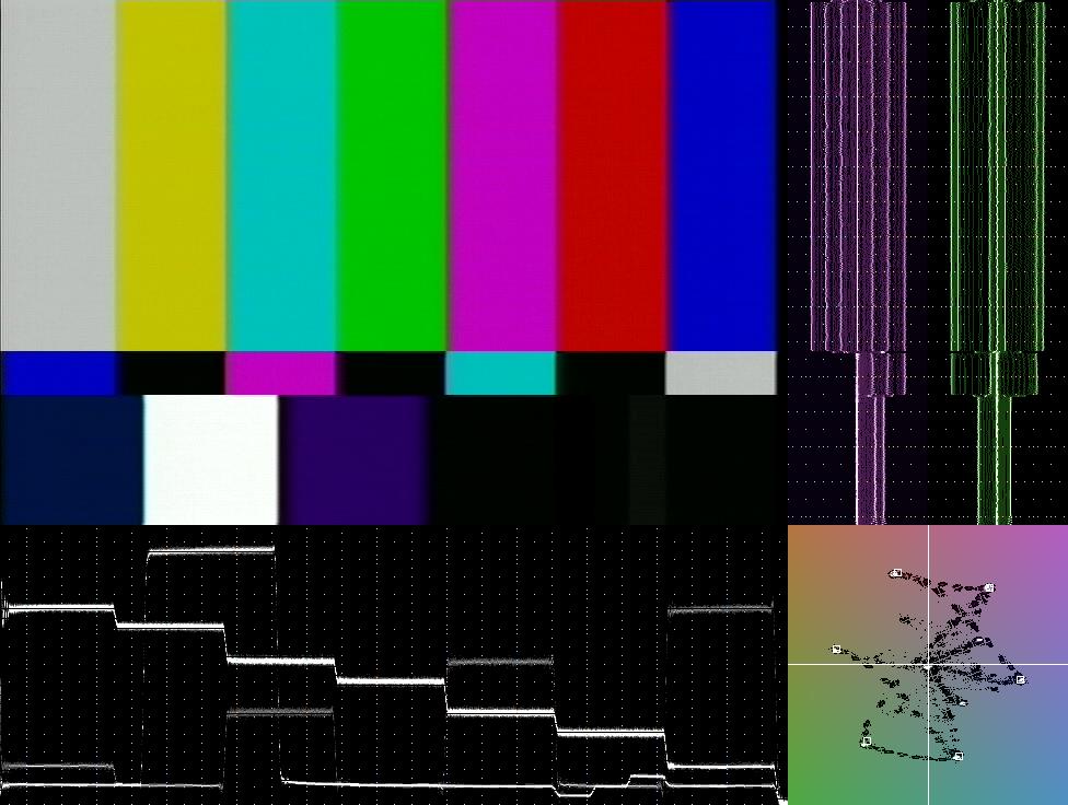

  4. Using a frame late in the cbars video (after the brightness stabilized):
    I came up with this adjustment in AviSynth:
    Tweak(cont=1.13, bright=-17, hue=2, sat=1.09, coring=false)
    Applying that adjustment to video 2.avi gives:
    That looks a little over saturated to me but that may be from some auto image processing in the capture chain.
    I used this script with the cbars video:
    AviSource("D:\Downloads\cbars.avi")
    VideoScope("both", true, "UV", "Y", "UV")
    ovr=ImageSource("vectorscope overlay.png")
    Overlay(last, ovr, width-256, height-256, ovr)
    The last two lines are to overlay the colorbars target boxes using this image:
    Name:  vectorscope overlay.png

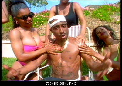

    UK

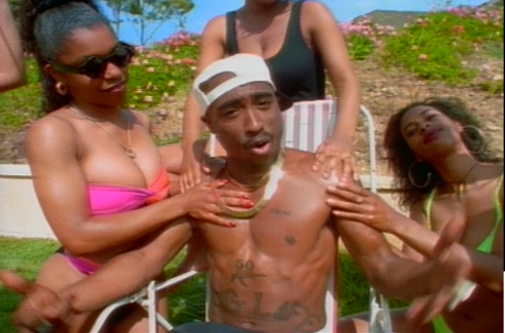

    @themaster1 @jagabo
    I've attached a screenshot of the same video and frame from another alternative source. Will this help you in identifying some suitable settings to use after comparing to the original picture (frame 488) from the original post?
  13. If you just want to match colors to your alternate images, this comes close the second image in your first post.
    Tweak(cont=1.02, bright=-14, hue=15)
    The major change is the hue.
