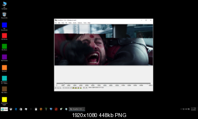

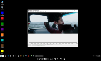

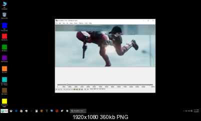

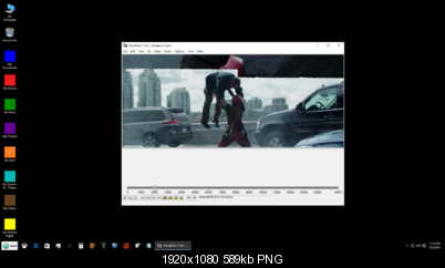

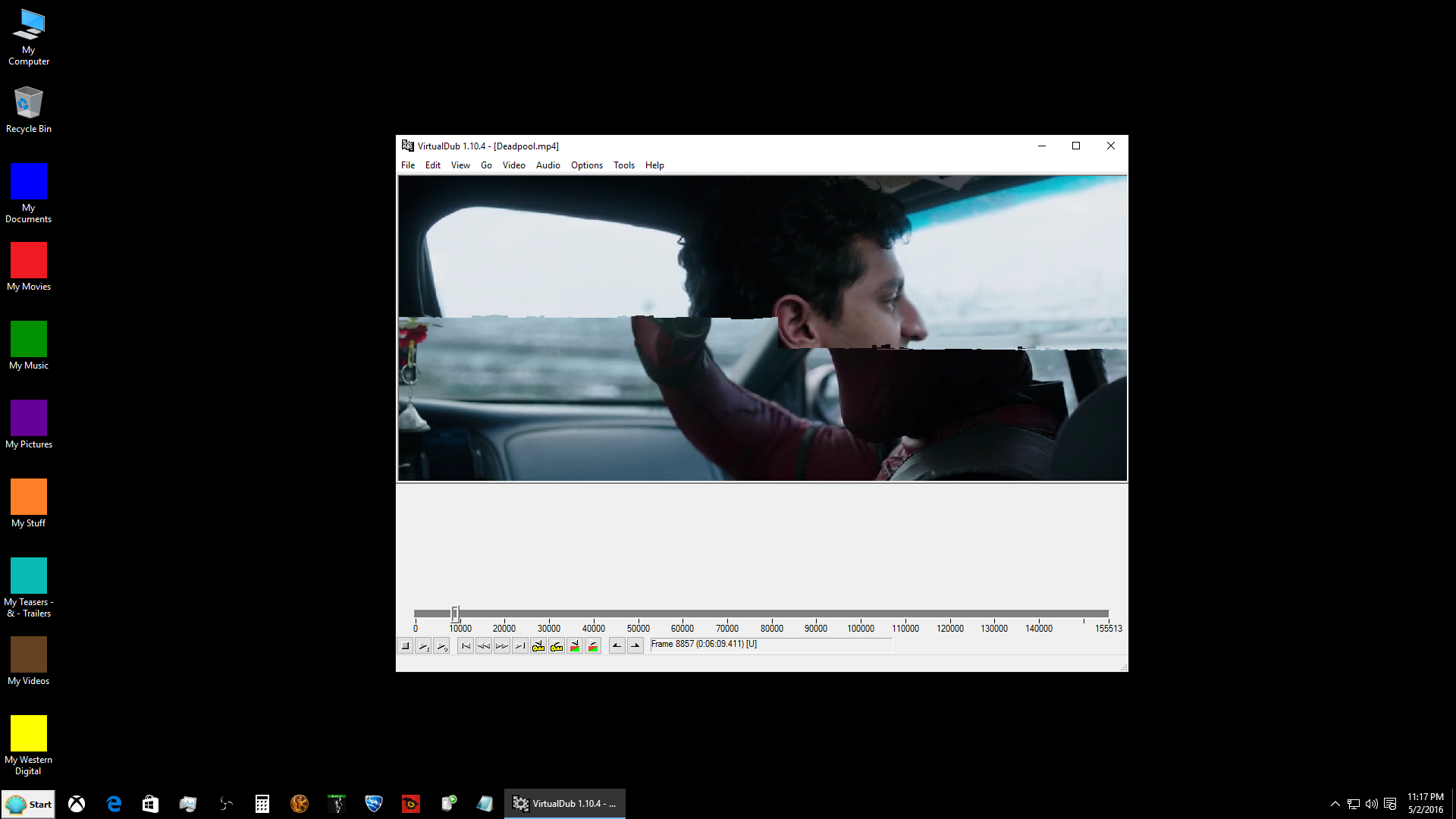

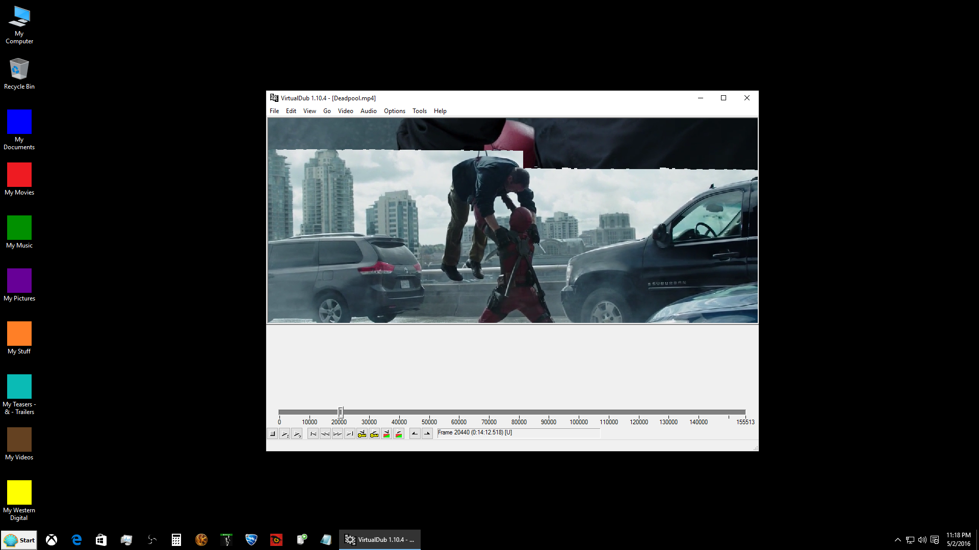

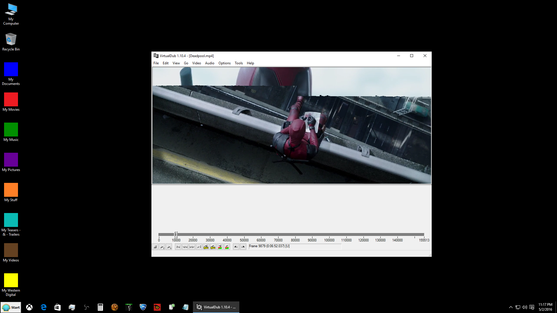

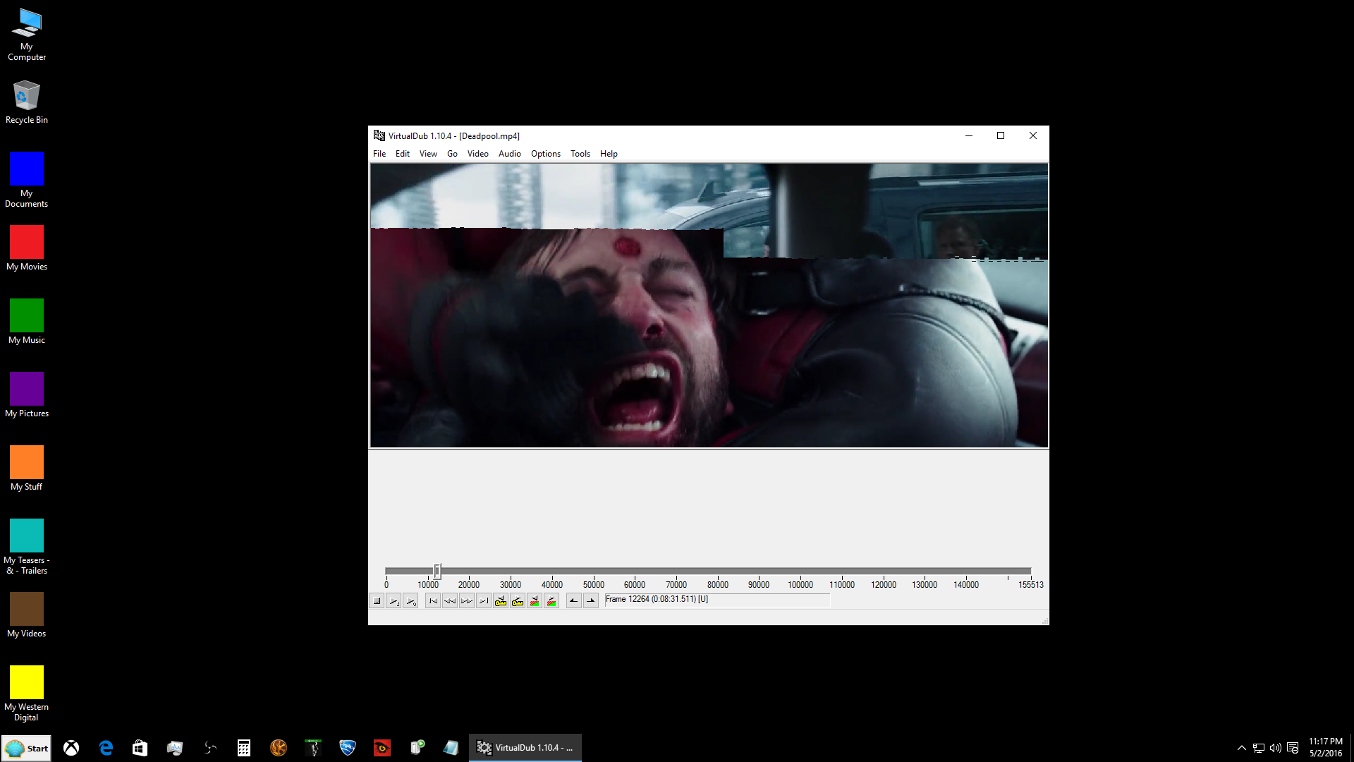

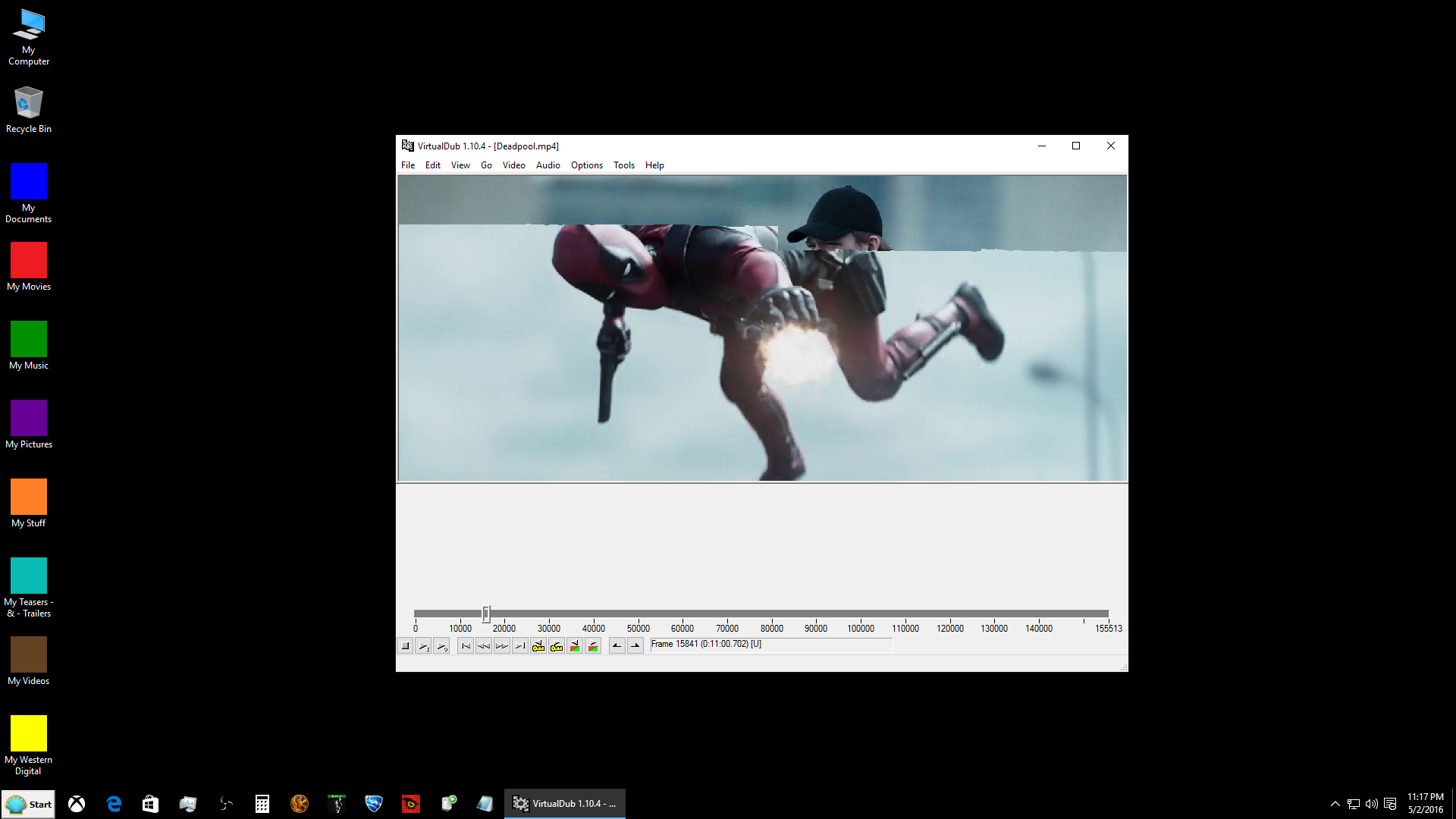

    Any way of fixing this ?

    If you are on win 10 64 bit, you can try VirtualDub-1.10.5-test7-AMD64 it worked under Intel too and I have no problem. Maybe there is 32 bit version too.

  6. I downloaded
    https://www.videohelp.com/download/VirtualDubAIO_1.0.0.9.exe
    The lines shown in the picture is still there

  9. Thanks but the AIO version linked earlier works fine but the lines in the picture are still there & like said abouve Id be curious with how 2 EXPORT 2 MKV / MP4 in VirtualDub unless thats not possible ?
  10. Yes, the ffmpeg input driver plugin tends to open just about anything. If you're not sure it's being used, when the VirtualDub File/Open navigation window opens, select "ffmpeg supported files" from the bottom "file type" drop down list. If you still have display problems, it's probably a display issue rather than a decoding one. You could try fiddling with the settings under Options/Preferences/Display. There's not many.
