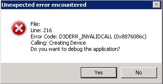

  1. Yeah, this is the tittle of the new message error i faced
    I'm using "aWarpSharp.dll" and "FFT3dGPU.dll" it was working normaly with me. But, this time i don't know why it appeared!! What should i do?!

    Maybe this time some other application in the background already used the GPU so much that there was no more space or access handles left for the filter?
    Which application do you think it could be?

    Another one who still uses DirectShowSource with a TS file. That may not be the reason for the crash ... but no experienced AviSynth user would recommend this as long as there is a native AviSynth source filter which still works reliably (e.g. DGMPGDec in case of MPEG-2 video, or FFMS2 / L-SMASH Source, maybe even DGDecNV / DGDecIM if you can afford its license). But DirectShowSource only works reliably if you know how to manage all installed DirectShow filters in your Windows system. All of them.
    __
    Sometimes I had a similar D3D error when another application used the graphic card with a 3D API (e.g. an OpenGL game was running and took so much texture memory that a DirectShow media player could not allocate another 3D environment to project the video on a 3D plane). The reason for your specific error may not be the used video memory, but maybe the access to video acceleration functions being unavailable because e.g. a DirectShow decoder filter already uses the same API to decode the video and blocks it for FFT3DGPU (and did not block with your last video because it contained a different video format which was not decoded with GPU acceleration). Or something similar.
    I would recommend you to try LwLibavVideoSource (in LSMASHSource.dll) instead of DirectShowSource. Furthermore, I usually find it suspicious when people "enjoy" frame rate conversions in DirectShowSource, usually there are better solutions; depending on your playback environment you may not even need a frame rate conversion at all because the display will adapt to the native frame rate of the video anyway.

    There's not much to explain. Since you got a D3 related error, just replace FFT3dGPU with FFT3DFilter, and see what happens.
    If I were you, btw, I'd just create my own AviSynth source file, like:
    LoadPlugin ("C:\Users\sino\Desktop\MeGUI_2418_x86\t ools\avisynth_plugin\aWarpSharp.dll")
    LoadPlugin ("C:\Users\sino\Desktop\MeGUI_2418_x86\t ools\avisynth_plugin\FFT3DFilter.dll")
    LWLibavVideoSource (r"C:\Users\sino\Desktop\Encoded\se sam.ts")
    ConvertToYV12 ()
    ColorYUV (off_y=6,gamma_u=-200,cont_y=0)
    Tweak (hue=-10,sat=1.4,bright=-10,cont=1.0)
    aWarpSharp (depth=10,blurlevel=2)
    fft3dfilter(bt=1,sigma=2,sharpen=1.5)
    crop(2, 90, -2, -92)
    LanczosResize(1280,536)
    You need to install FFT3DFilter and LWLibavVideoSource first, of course.

    It worked verry well (y) no words can describe my greetings
