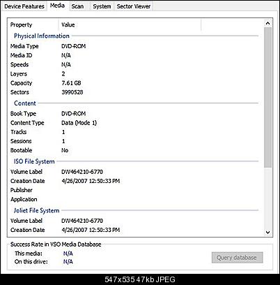

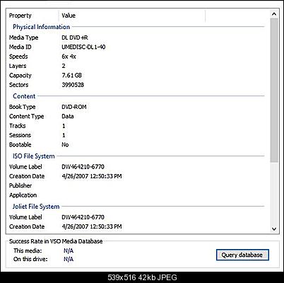

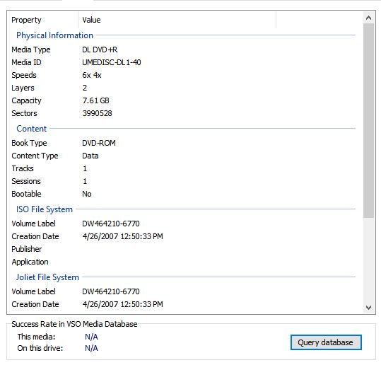

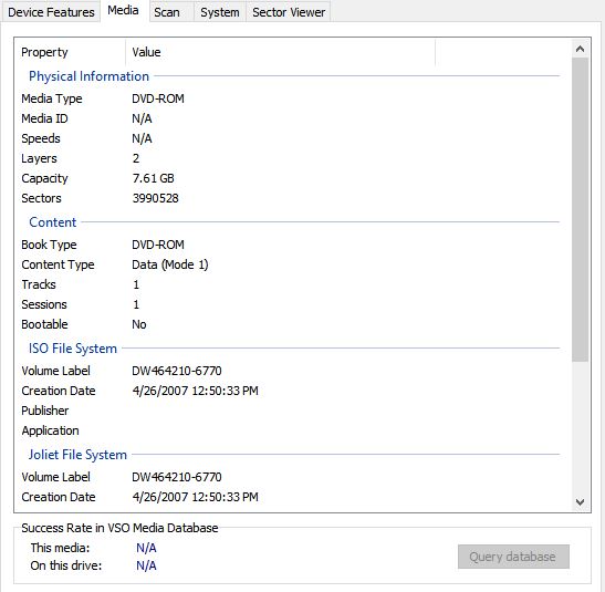

    trying to make a copy of a navigation disc for my truck. the original disc works but my copy will not play. after i burned it i loaded both into vso inspector and have these results.
    copy disc here

    original disc here

    my copy disc is showing media type as dl-dvd and not dvd-rom, could this be causing my non playing problem. anyone have a solution on how to get it to show as dvd-rom.
    burned using imgburn (booktype dvd-rom)

    The op did burn the disc as data and is set to dvd-rom booktype so it's most likely the brand of disc you used,most people here will tell you for dual layer dvd always use verbatim.
  4. I'm actually using verbatim dvd+r dl disc and still having errors. maybe my iso is corrupt.

    umedisc-dl1-40 are the low end brand of verbatim from the life series,look for the verbatim with azo made in Singapore.
