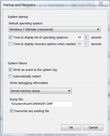

    I'd start by disabling automatic restart.
    If Windows loads during the reboot loop, try starting it in safe mode to see what happens. http://windows.microsoft.com/en-au/windows/start-computer-safe-mode#start-computer-saf...mode=windows-7
    Auto Restart was disable.
    Windows loads fine but it could be a minute later that reboots. It stays solid on safe mode.

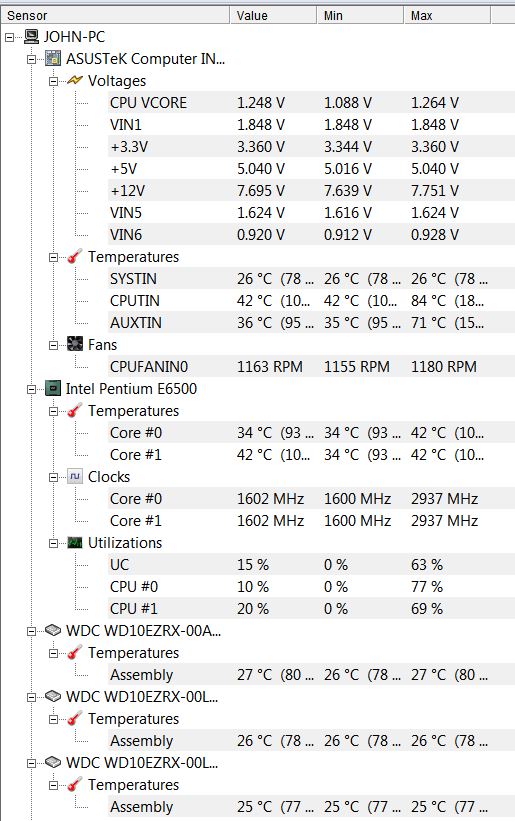

    Update: You picture shows your 12V voltage at around 7V. Usually mobo voltage sensors aren't the greatest but that looks really low/bad.
  9. aBigMeanie aedipuss's Avatar
    Oct 2005
    666th portal
    your power supply is failing badly. the 12 volt reading is only 7.7 volts. time for a new one.

    I would double check the voltage on the 12 VDC rail in BIOS. Not all aftermarket voltage monitor programs give correct readings.
    I mistakenly suggested HWmonitor earllier, which I don't trust any more.
    It also told me I had 8 VDC on the 12 VDC rail on a perfectly working PC.
    I use HWInfo now: http://www.hwinfo.com/download.php
    I doubt the PC would run with 7-8 VDC on the 12 VDC rail. But there may still be power supply problems.

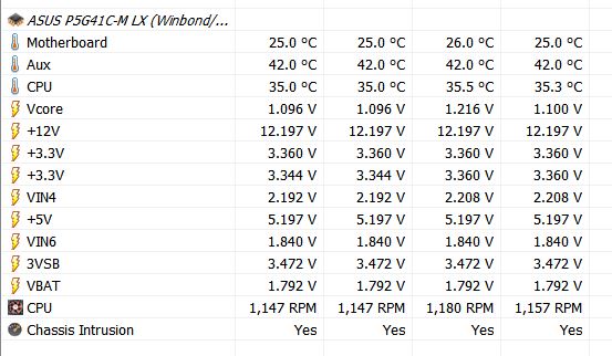

    New picture
