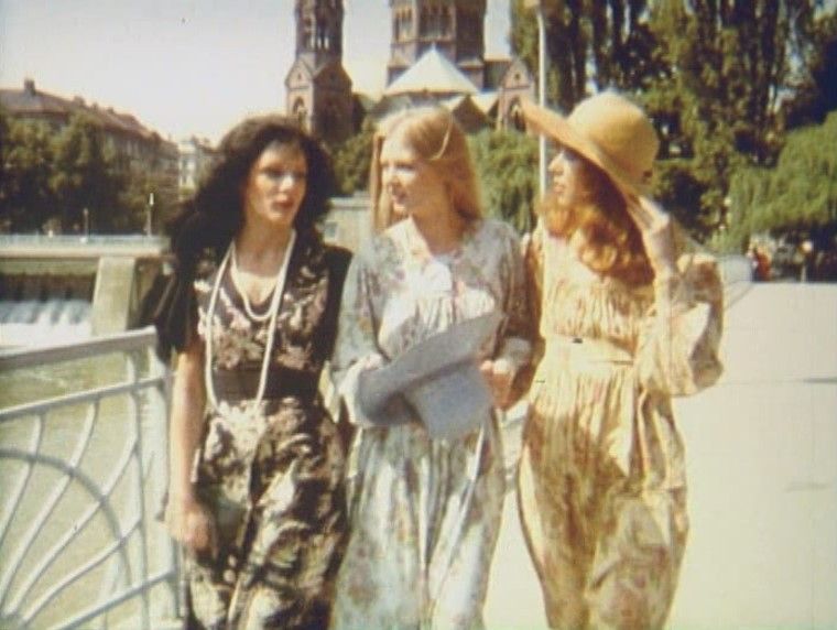

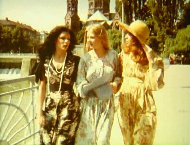

  1. Hi. I've just started to reencode a DVD using MeGui with the QTGMC and SRestore filters (thanks, manono). Elsewhere on the interweb, I found the same DVD which had been encoded primarily to improve the colour. You can see from the pics what a terrific improvement there is. I asked the guy how he did it and he says "the colors 4 filters in Virtualdub". His English is not good so I'm looking here for some help as I'd like to try this colour correction myself.
    Firstly, is there such a thing as 'colors 4'? I've read of 'Color Mill' but in my VirtualDub, video/filters/add only seems to have three filters concerning colour - 'brightness/contrast' 'chroma smoother' and 'HSV adjust'.
    If I need 'colors 4' or 'Color Mill' how do I install them? And any tips for changing my yellowy picture to something more natural?
    Thank you.

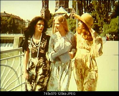

  4. One can do a lot more but this comes close to the second sample image:
    ColorYUV(off_u=26, off_v=-4)
    A video sample would be better.

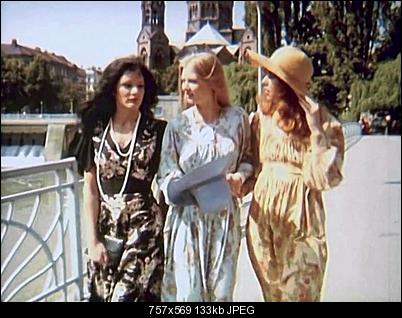

    If all the guy did in ColorMill was that, you can do similar and better within AviSynth without changing colorspaces. jagabo suggested ColorYUV. Here's what can be done using the SmoothTweak portion of SmoothAdjust:
    MPEG2Source("test.d2v")
    yadif(Mode=1)#would use QTGMC if doing it for 'real'
    SRestore()
    SmoothTweak(Brightness=-1,Contrast=0.95,Hue1=20)
    Crop(10,0,-12,-4)
    LanczosResize(640,480)
    The Hue1 setting adds blue and lessens yellow. I'm sure better can be achieved with more tweaking.

  6. This is what I did using the color corrector in my NLE (Sony Vegas). I am not at my main computer which has a calibrated monitor, so this may be a little off.
    It looks pretty similar to what others have already posted. I like doing color and gamma correction in my NLE because it is interactive, and also because I have a full suite of tools available. Many videos require several different corrections in order to get the best result.
    I purposely chose to NOT change either saturation or contrast as others did. That is strictly personal preference and there is no "right" or "wrong."

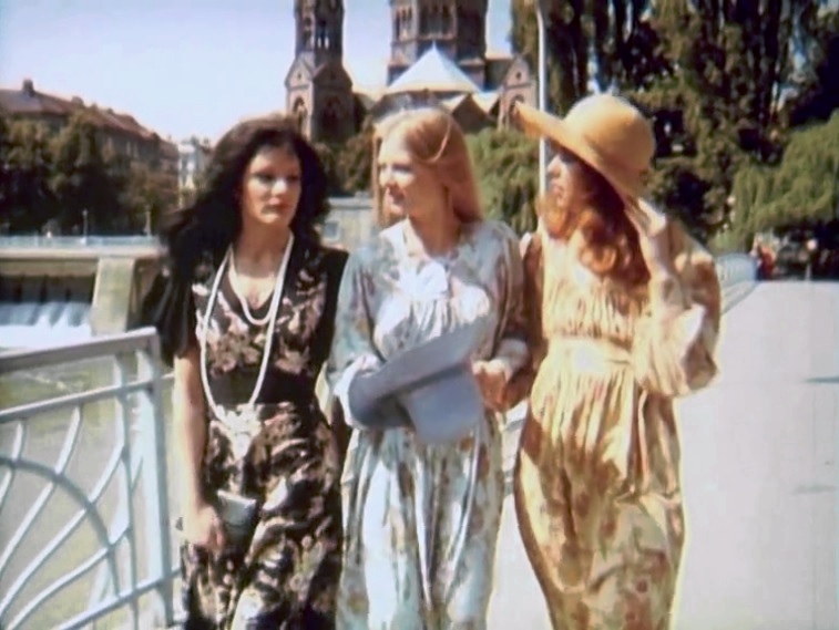

    Color was borked a long time ago and levels were blown away probably sooner. YUV won't work here, the damage is too nonlinear. You need an NLE that can work in layers. Still, don't expect much.

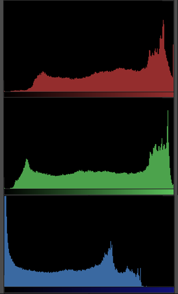

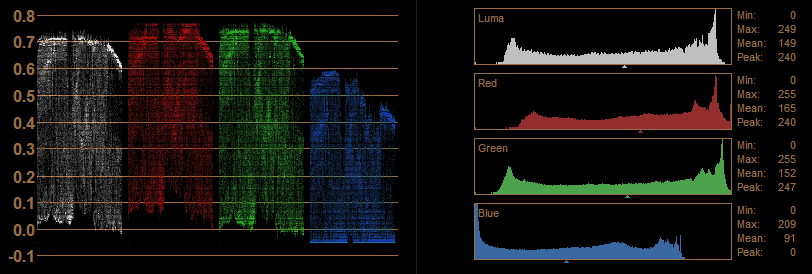

    Nice, but not very good. I opened the "corrected" RGB image in AfterEffects and played around, then emulated those settings in VirtualDub. but it's really no use. Both the original and the corrected image posted are in bad shape.

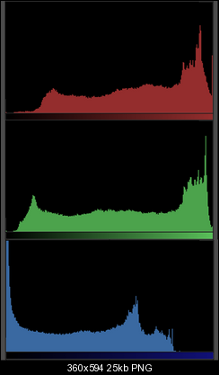

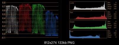

    AE histograms and waveforms of the original image show that you first have to correct some levels in YUV before you can even hope to do RGB work because there's bad clipping in the original that gets worse in RGB. Especially you'll have to apply an offset to the U channel to see if you can retrieve some dark blue. After the video gets to RGB it's too late for that. From the yellowy original:
    An enlargement of the chroma channels shows bright clipping of red and green, and blue gets submerged and crushed all to hell at the low end.

    No one can do anything with the RGB images. We'd need an unprocessed short sample of the YUV original to start with.
