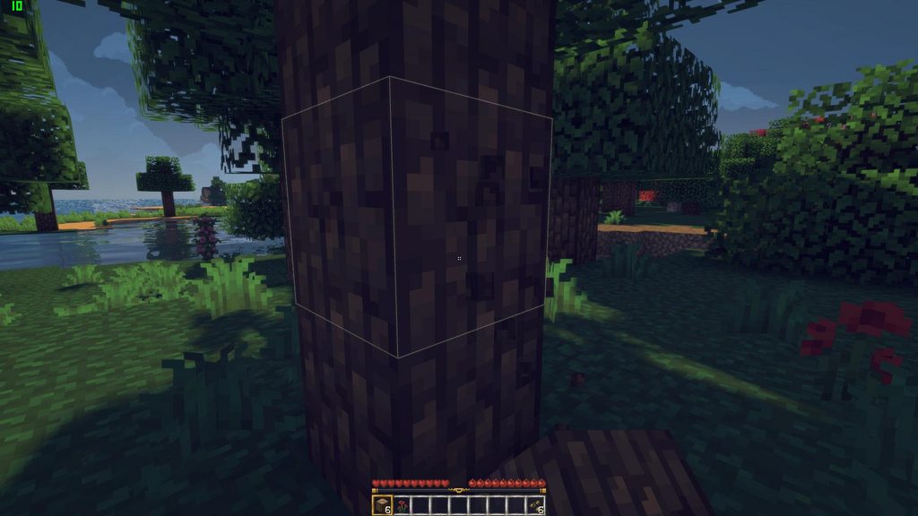

    I want to record some footage in RGB, here are the settings (bandioam+lagarith): https://forum.videohelp.com/images/imgfiles/rb9J8l6h.jpg

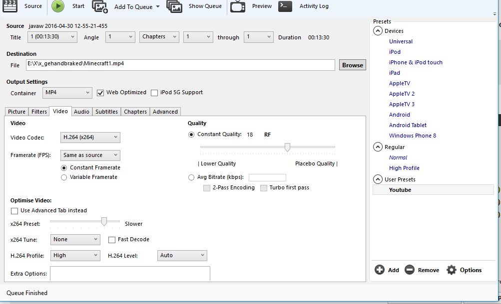

    Then I just want to shrink the size using handbrake: https://forum.videohelp.com/images/imgfiles/EJ5a3LQh.jpg

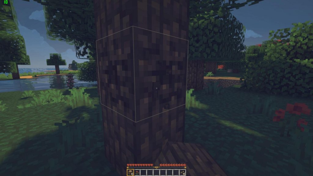

    But after handbrake it looks like this: https://forum.videohelp.com/images/imgfiles/2UCgqSnh.jpg
    And the recorded footage from bandicam looks like this (Which is the way i want it): https://forum.videohelp.com/images/imgfiles/am6eF0th.jpg
    If you look at both images you see what my problem is, the "after handbrake" one looks much brighter, which is my problem.
    The new video looks a bit brighter. I took a look at this thread (https://forum.videohelp.com/threads/304139-Color-loss-even-when-doing-lossless) but i barely understand what ppl are saying.
    Since I have no way of changing my source now, since its all recorded now, what do i need to do with handbrake that it compresses my video without changing my source?

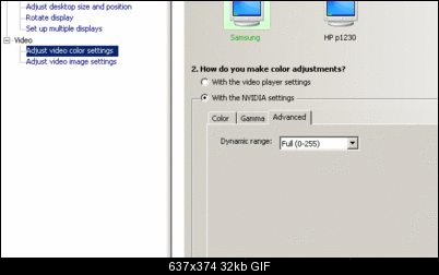

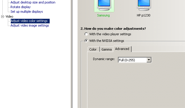

    Have a look at your video card settings. I always set the video card to expand the levels as then they should always be correct regardless of the player being used (or almost always). For Nvidia, it looks something like this:
  7. hello_hello, you are right.
    That was the problem. Nvidia sets "use video player standards" as default, now that I changed it to Full 0-255 it looks as it should.
