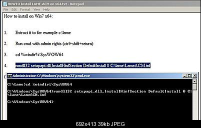

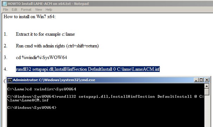

    Dec 2005
    Canada
    For 64 bit Windows , place the extracted Lame folder in c:\ and follow the instructions.
