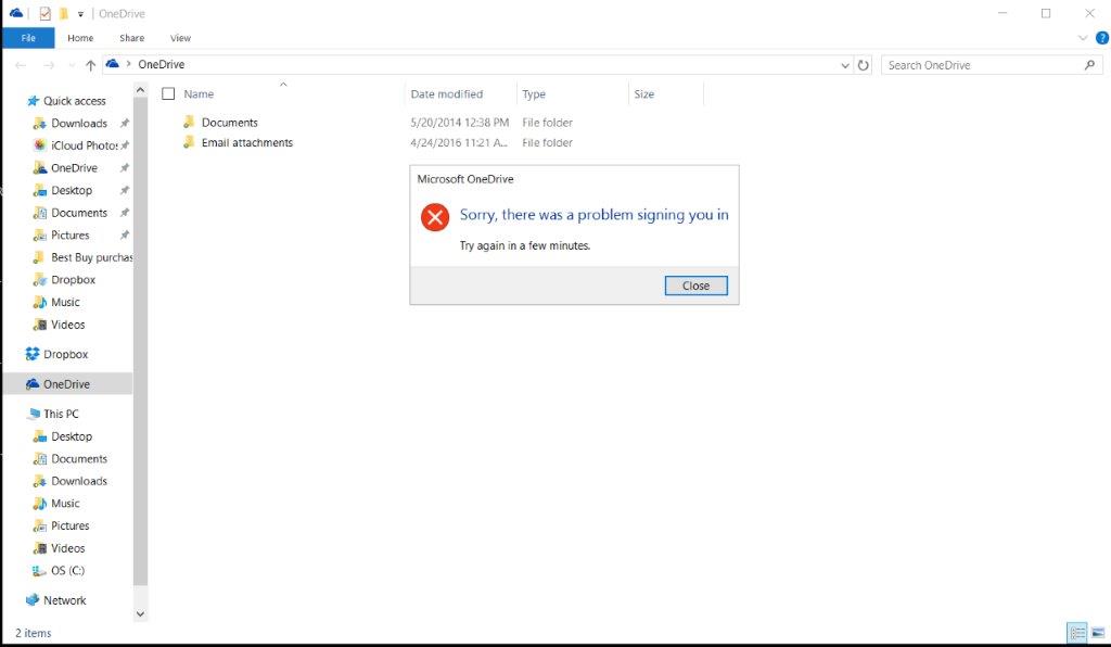

    Every time you open the OneDrive folder it does open but an error screen appears saying "Sorry, there was a problem signing you in". These folders are empty since she doesn't use them but error screens confuse her (she's 85) so I try to eliminate them when I can. Since OneDrive loads upon reboot she naturally gets the error screen whenever that happens.

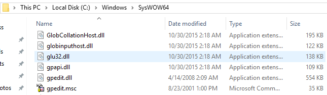

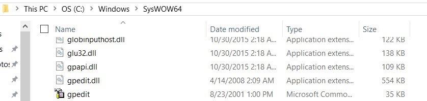

    Ok in my SysWOW64 folder it does show a gpedit.msc file but hers instead shows a gpedit file so I don't have the proper file to copy over to the System32 folder. The image attached showing a gpedit.msc file is my SysWOW64 folder after installing the Group Policy Editor compared to my Mom's SysWOW64 folder (gpedit) after installing it.

    Ok I accidently stumbled upon the fix. I opened the file location of OneDrive and there was a installer so I thought what the heck and clicked to install. When finished I could now open the folder without an error screen and I now had an OneDrive icon in the task bar. Weird something apparently happened in the Windows 10 upgrade that it did not fully install OneDrive.

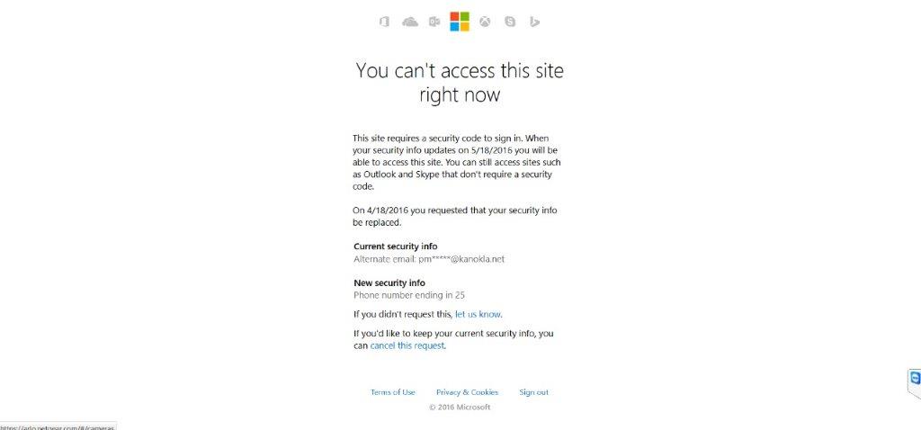

    @sum_guy I just remembered this:
    I don't quite understand how this "Verify' works but a week ago I tried to do this on her computer and I got this screen. I never looked at it again and basically forgot about it. I don't remember having a waiting period when I did the Verify on my Windows 10 can you enlighten me to as what's going on? It won't let me cancel it and start over in case it would speed things up.
    I can't remember exactly what I did going through the Verify process but I think I tried to change her alternate email address because she no longer has that email.
    I'd be willing to bet this is what's causing the WLM logging issue what do you or anyone else think? Knowing this do you still think removing and setting back up her email account will make a difference?

    I'd already been there and it will not let me do anything.

    Well never accomplished a thing chatting with Microsoft after waiting for over an hour he said Windows Live Mail was no longer supported and he couldn't help me. I then tried their help forum but that was a waste of time too. You usually get someone that can't understand your question or posts links for you to figure out yourself. The only time anyone truly gets any help there is if someone other than anybody to do with Microsoft offers their help.
    Guess I'll have to wait until 5/18 to see if the Verify goes through and clears up the situation but that's only a 50/50 thing it will fix this login thing.
