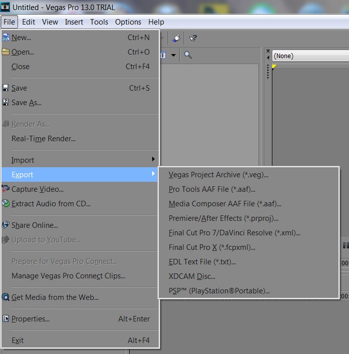

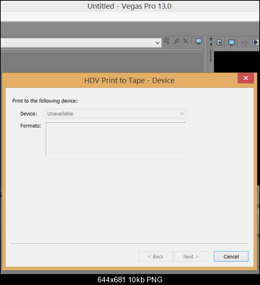

    I just installed Sony Vegas but in export tab I don't see tape option:
    Oct 2005
    666th portal

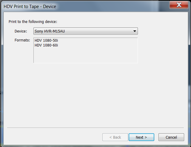

    click the tools tab/print to HDV tape

  9. Capturing Memories dellsam34's Avatar
    Jan 2016

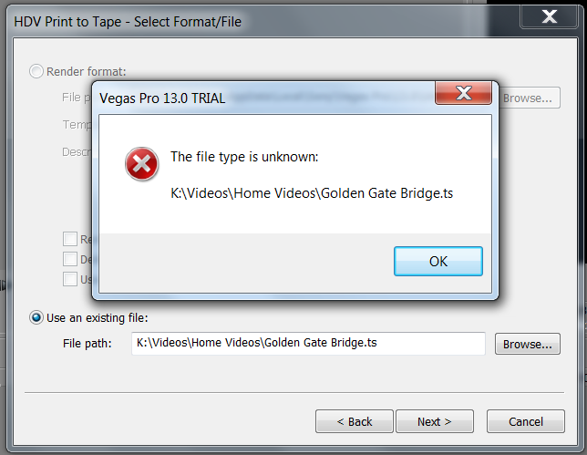

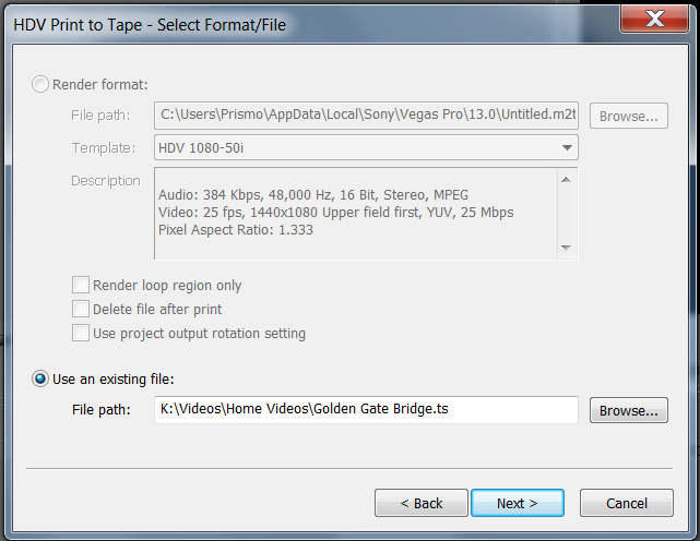

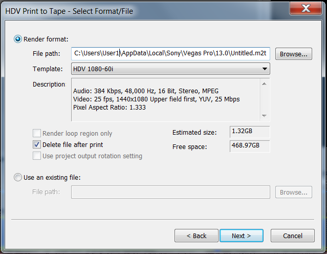

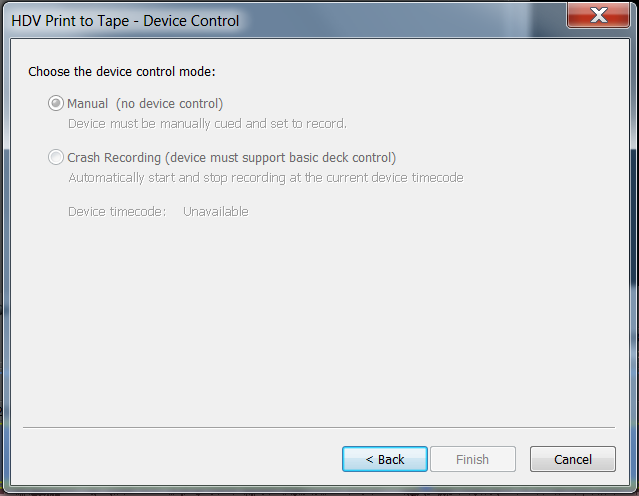

    Ok I tried this morning it didn't work; I cannot get the software to record to device even though it detects it - see screen shots, I even tried the option of selecting an existing file from a folder but it is not seeing my file, it is looking only for TS M2T files which a HDV file is not.
    Edit: I think I know why it does nothing, Looking at the file path it is looking for Untitled.m2t which I don't have, I don't know why it doesn't take the file that is currently loaded to the main page?
    Are the old versions of Vegas can print mpg HDV files, or all print only ts and m2t?
    Nope, that's not it. Vegas first has to render your project to an MPEG2 transport stream file before it can send it to tape. This dialog is just asking what you want to call the file and where to put it. Check "Delete after print" if you don't need to keep it around.
    My guess is that there is a problem with your IEEE 1394 connection. You might try switching to the legacy 1394 driver. Or it may be that your deck is stuck in output mode, which can sometimes be fixed by setting edit points and putting it into record pause.
    EDIT: Also found this bit in the manual:
    Before connecting the i.LINK cable, set [HDV/DV SEL] and [i.LINK SET] in the [IN/OUT REC] menu. If you perform the settings after connecting the cable, the computer (editing machine) may not recognize the unit correctly or may freeze.

    I picked up a file from the FX1 that I know I transferred at 1:1 now the file shows up on the browser box but when I select the file I get an error message.
    The file is from Sony camcorder, Laptop is Sony with 4pin firewire input, the deck is Sony, Vegas is Sony what could go wrong and yet nothing worked, It must have something to do with Win 7 or Sony just dropped support for HDV recording.
Name:	file selection.png

  17. Your screenshots show both 25/50 and 30/60 framerates. Are you sure your footage, your projects and your cameras are all using consistent, compatible settings?
  18. Capturing Memories dellsam34's Avatar
    Jan 2016
    Yes 60i, The screen shot above shows 50i is just a mistake, I always select 60i the files are 60i my deck is set to 60i, Looking again at the files the only thing different that I can think of is the time code, My files when they were transferred to computer had to do some losseless cut and stitch and that probably reset the time code, So Vegas looking at the file with no time code as an unknown format. Maybe?

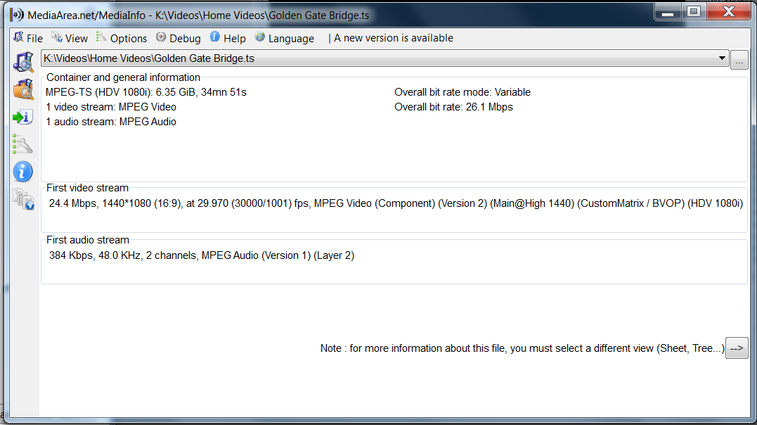

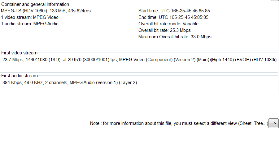

    whatever you used didn't make compliant HDV. if you look at your screenshot of golden gate bridge info it says vbr. it has to be constant bit rate not variable.
  20. Capturing Memories dellsam34's Avatar
    Jan 2016
    I did not change the files' bitrate that's how they were shot with both consumer and pro camcorders, Maybe you are talking about DV has to be constant bitrate, HDV is an MPEG2 doesn't have to be constant and if that's the case I didn't have an option to change it in the camera menu, at least in the consumer one.
    Can you try the attached sample on your end? if it works for you, It might be that the trial version has to render the files to insert the trial watermark.
    I just recaptured the rendered file by Vegas from the tape back to the computer using HDV split and it is VBR, Vegas detected the file as a valid format and printed it to tape without rendering, So we can rule out the VBR.

    I think you are referring to AVCHD camcorders, HDV camcorders are MPEG2 either TS or PS at least mine were, Here is the info from the HDV file that has been rendered by Vegas, So lets also rule out the m2t/m2ts theory.

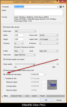

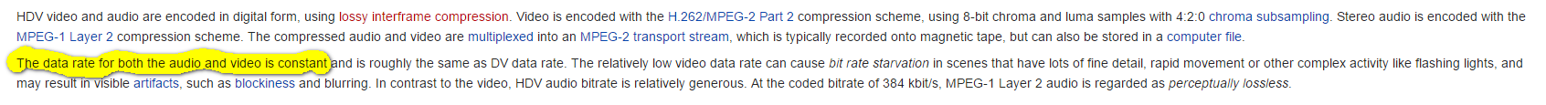

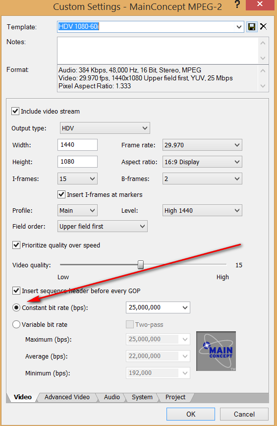

    i haven't contradicted myself once. this is the standard HDV template in vegas. don't change anything or you make non-compliant video. get it? it's has to be cbr or it can't go back to tape. i don't know what you are checking the file with but none of them are always accurate. for the last 14 years i've own and run a video production house. the HDV standard hasn't changed in all that time. i'm out. maybe someone else with more knowledge can help you.

    MediaInfo is not the Word of God. It makes mistakes. ffprobe is more reliable.
    Video stream data for HDV out from Vegas.m2t:

    Note that the bit_rate and max_bit_rate are the same. This is a CBR stream. Now look at Golden Gate Bridge_0001.ts:

    The bit_rate is missing, which means this is a VBR stream, which isn't allowed in HDV. (Read what Sony has to say if you don't believe me or aedipuss.)

    Yes, makes sense now, didn't think mediainfo is that bad, The question now is why the FX1 and HC something camcorders record VBR, was an option in the camcorder that I missed ? I know for a fact that I transferred my tapes as 1:1
