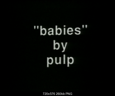

    Am experimenting with creating MKV (x264) files from VOB files that I've ripped using DVD Decrypter. Previously, I used to run the VOB files through AutoGK with a quality of 100% and it would do a straight convert and result in AVI (Xvid) files that looked great.
    I'm trying out Handbrake now and am ending up with results like below:
    There's a "combiness" on there that's on the original VOB file too. I quickly retried using AutoGK and it seems it automatically detects that the file was interlaced and did something about it. It looks much better. Handbrake isn't doing so great at the moment in comparison.
    Do you get this effect on *all* DVD files and, if so, what's the best setting to get rid of it? Handbrake is completely baffling me with all the possible settings, including one called "Bob"...?
    Help!
  2. I don't see any interlacing. I see what seems to be noise. And a short 10-second video from the source is worth way more than a picture.
    You should probably detail your Handbrake settings so those that use it can tell what you're doing incorrectly or not doing what you should be doing.
  3. There's horizontal time base jitter. The DVD was made by recording an analog tape source. There are ways of dealing with it but you may need to learn a little AviSynth. A video sample (not just titles) would be helpful.

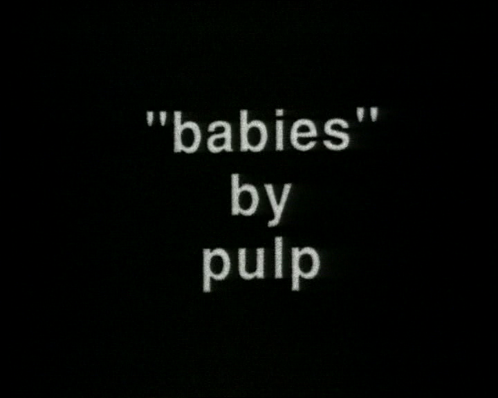

  4. Thanks guys, here's a proper sample, rather than an admittedly-unhelpful single frame:
    https://drive.google.com/file/d/0B9pCyMhIrr5UUWZsVThrOThfSVU/view?usp=sharing
    Like I said, AutoGK reckoned there definitely *is* interlacing in it and the "combing" effect looks pretty horrible, especially when I play the resultant MKV on my big plasma telly.

  7. The video contains progressive frames, encoded interlaced. As noted before, horizontal time base jitter has caused individual scan lines to shift left and right by small random amounts leaving minor combing artifacts. The methods or eliminating those all involve some kind of vertical blur.
    The best way in AviSynth is usually the vInverse() filter. Another way Blur(0.0, 1.0).Sharpen(0.0, 0.7). The Blur() blurs them away (only blurring vertically), the Sharpen() restores most of the sharpness without reintroducing the combing or creating over sharpening halos. vInverse is slightly better because it only treats areas where it sees combing, whereas the blur/sharpen method treats the whole picture. You can also downsize vertically then upsize back to the original size: Spline36Resize(width,height*2/3).Spline36Resize(width,height).

  8. To be honest, most of this is really going over my head!
    I've had a few tries using the "deinterlace" option in Handbrake while encoding and the results seem ok. Can anyone clarify, what's the difference between "Fast", "Slow", "Slower" and "Bob"(!)? All I can see is different file sizes, the results all look the same (no more of those horrible lines through everything)...
  9. Yes, there's mild interlacing from time to time. I finally saw it in the earlier picture, too. Slower but equally valid, I think, is to bob it and then remove every other frame:
    QTGMC(Preset="faster")
    SelectEven()
