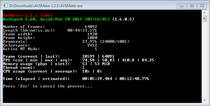

    As you can see, there is little CPU usage.
    Any suggestions on what I can do to speed things up. ie. different decoder, Avisynth versions, scripts, etc.
    If I extract the .264 elementary stream and remux to mp4 GoPro CineForm Studio can transcode it in nearly half the time with about 50% CPU usage.
    Thanx
    Just some thoughts..... higher CPU usage when decoding mightn't necessarily be ideal (ASVMeter is just measuring the Avisynth output isn't it?) because the encoding process would require a fair percentage of the CPU's time.
    I've never used AVSMeter but if it's showing an average frame rate of about 80fps I'd imagine the encoding process would be lucky to keep up.
    AVSMeter is a tool specifically designed to benchmark AviSynth scripts by requesting but ignoring its output (similar to "> NUL"). Groucho2004 took some efforts to make the results as reliable as possible.
    If you feel like your conversion is slow, but AVSMeter confirms a rather quick delivery of the video source by AviSynth, then you can be quite certain that most of the time is spent in the encoder, and trying to optimize the AviSynth script won't widen the bottleneck.

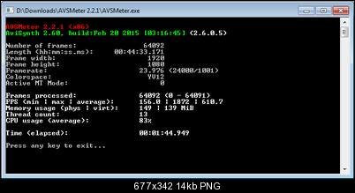

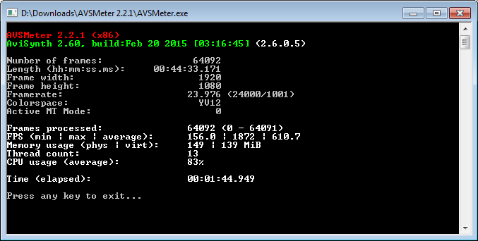

    Here is a new test with the same file, only I removed the ", fpsnum=24000, fpsden=1001, threads=1" and "SetMTMode(5, 8)"
    Obviously, the script and decoder are working much better.

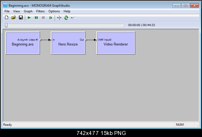

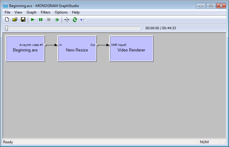

    However, just for the heck of it, I opened the script in GraphStudio and much to my surprise "Nero Resize"?
    If that's the chain the video is using for decoding, it might explain some of the slowdown. If so, how do I get rid of the "Nero Resize"?
    I don't know a lot about the graph edit thing, but I don't think Nero resize would be involved, assuming VirtualDub is encoding with a video for windows codec which I assume the CineForm encoder is? Maybe it's a limitation of VFW. Someone else might know. Are you using "fast recompress" as the video compression method for VirtualDub, just to make sure it's not doing anything like converting to RGB. I think it still does by default for the other compression methods.

    VirtualDub will certainly not use a DirectShow filter chain to serve VfW codecs with video input; GraphEdit will not show you what VirtualDub does. As long as you don't use DirectShowSource in AviSynth, this Nero filter should not be any concern during the conversion.
    How to remove it ... you would have to discover which *.ax or *.dll file contains this filter, unregister it (regsvr32), then delete it. GSpot 2.70a may be outdated as media analysis tool, but can help you identifying DirectShow filters. RadLight Filter Manager would be another tool suitable for managing your installed filters.
