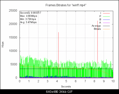

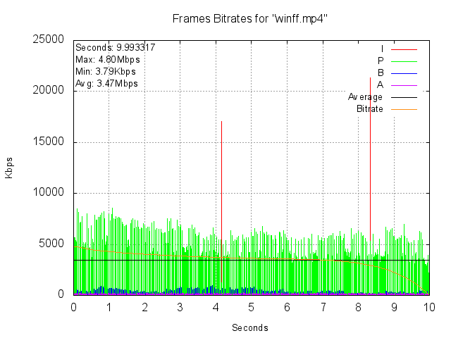

    Yes, do you see how the bitrate graph falls off ? Because the zones command overrided what x264 would have normally distributed
    I haven't really use megui for a few years, I tend to use x264.exe or ffmpeg.exe - but I know you can enter extra commandline options in MEGUI, also check the zones section. IIRC you have to checkmark/enable advanced settings to see the other parts of the GUI. If you have saved a preset with zones, that would explain what you are seeing. Or if you post some screenshots of your configuration setup I, or someone else, can try to walk you through it
    megui is one of the more complex GUI's . If you want something with a more simple interface, maybe try ripbot, or simple x264 launcher . If you want to continue using megui, then provide more information - definitely there is some zones information in the preset you were using, or extra commandline box has those zones settings . You can also post the log file if you want more info
    The finished file is 3.97gb, original was 58.4gb. Length is 2hr 3min and 46sec.
    Here's a comparison, remember that super long 24 hour AvsPmod encode with their CLI using my x264.exe? That file is just the video since no audio was added to it, but it's 890mb compared to MeGUI's 3.97gb.
    If everything else is the same in terms of the script, preprocessing, x264 settings and version, you will get exactly the same thing. So obviously something was different between them, probably teh settings

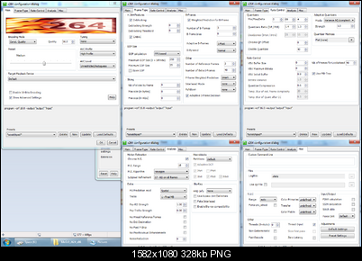

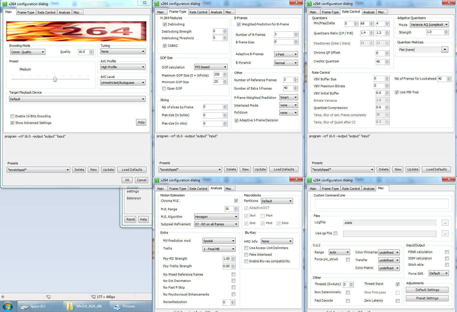

  3. poisondeathray here are the MeGUI settings, the ones you're looking for I hope. Everything is still at the default other than me selecting a different CRF with the "Quality" option. I didn't even touch the other tabs, so I don't know why my MeGUI's videos degrade towards the end like how I noticed and how your graph clearly shows...

  5. This is the encoding string of the "megui-muxed 16 cbr.mp4" file as read by mediainfo (view=>text) . (BTW it's "CRF" not "CBR" ; CRF is constant rate factor, CBR is constant bit rate)
    Encoding settings : cabac=1 / ref=5 / deblock=1:0:0 / analyse=0x3:0x113 / me=umh / subme=8 / psy=1 / psy_rd=1.00:0.00 / mixed_ref=1 / me_range=16 / chroma_me=1 / trellis=1 / 8x8dct=1 / cqm=0 / deadzone=21,11 / fast_pskip=1 / chroma_qp_offset=-2 / threads=12 / lookahead_threads=2 / sliced_threads=0 / nr=0 / decimate=1 / interlaced=0 / bluray_compat=0 / constrained_intra=0 / bframes=3 / b_pyramid=2 / b_adapt=2 / b_bias=0 / direct=3 / weightb=1 / open_gop=0 / weightp=2 / keyint=599 / keyint_min=59 / scenecut=40 / intra_refresh=0 / rc_lookahead=50 / rc=crf / mbtree=1 / crf=16.0 / qcomp=0.60 / qpmin=0 / qpmax=69 / qpstep=4 / ip_ratio=1.40 / aq=1:1.00 / zones=343,599,q=40
    On the "front page" when you open megui, there is a zones button. Push that and check if there are any entries there

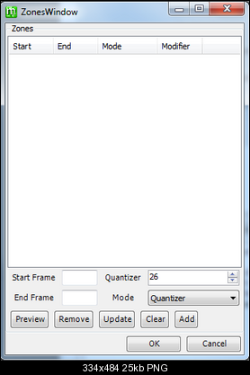

    If I look back at post#6, I know that's not megui, but you have zones specified there as well
    If there are no zones specified anywhere, post the log file. There will be a folder "logs" , inside will be a record of all your encodes by date

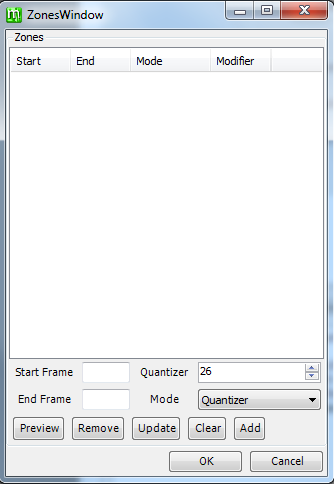

    Here is what I got:
    I *may* have been seeing things, but I could've sworn the first time I opened that up before I closed it and opened it again it said 24. But it's the morning, so unless that's normal, nvm.
    It's empty in there, only thing that is in the Log folder is Versions and Update detection. All the jobs are still posted in the Queue tab but I can't seem to pull out any sort of log from any of them. The Priority tab when the encode is happening is always to LOW or BELOW NORMAL for what it's worth.
    I also just ran the encode again to pull up a new log for you and this time there's nothing wrong with the video. It's set at CRF 16. This time the file is 9.27mb, my original CRF 16 of the same file is 5.65mb. I'm just getting confused now, something was up last time.

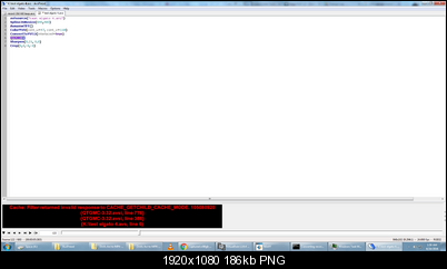

  7. windows 7,8,10 don't like you writing anything on the c: drive, so if you have the megui folder on the c: drive, it might be a permissions issue writing log files to the log folder
    For the FLV, post the script used, and if you preview the script, can you see the errors ? Post mediainfo (view=>text) on the source AVI file. This looks more like a decoding issue, but glitches, and mixed up frames can also occur with MT. The probably increases the more temporal filters you use. But QTGMC alone is usually pretty safe with MT
    Try to narrow down the issue to see if it's repeatable. For example use Trim() to specify a segment to encode around that error and see if you can repeat the issue, or if the error is completely random. Or if it's related to something else like maybe high temps, corrupted memory

  9. Reduce the thread count (16 is probably a bit crazy), if that doesn't help, comment out the setmemorymax
  10. Okay, so in WinFF I had to drop the thread count all the way down to 6 to make it stop in it's ffplay source preview.
    In MeGUI, with the threads staying at 16 as it originally was, if I click Reopen Video Preview (equivalent to what I'm doing in WinFF, that's how I play it w/ ffplay in here, right?) and press play the video plays flawlessly in slow motion there (albeit there's no sound whereas in WinFF there is frame by frame sound).
    What exactly is happening here?

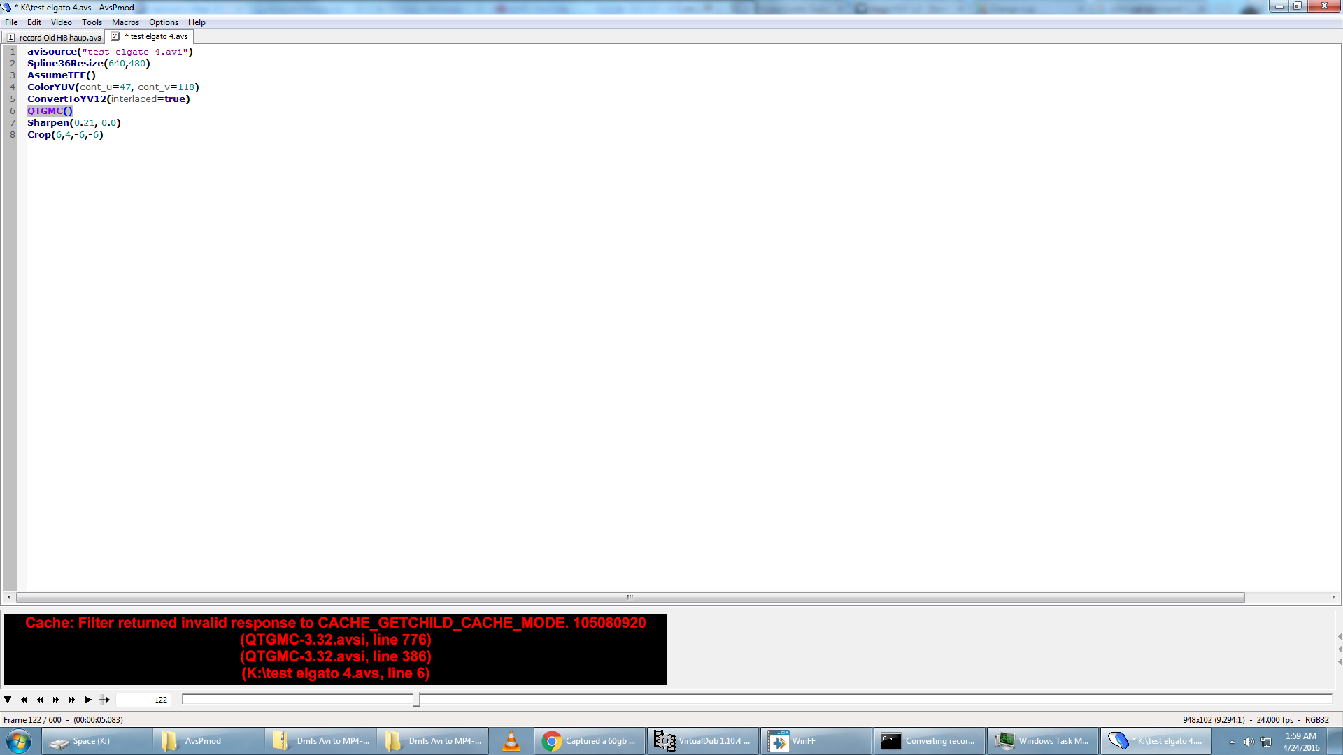

    Yeah, I don't think it works for me that way. I get ride of the MT Mode lines and QTGMC starts giving me errors:

  25. Re the MT error, I get the same thing with some filters. Just at SetMtMode() with no arguments at the start.
    In UT YUV 4:2:2 BT.601 is the same as huffyuv.
  26. Originally Posted by CZbwoi View Post
    I don't get that error with set's MT avisynth 2.6
    http://forum.doom9.org/showthread.php?t=148782
    Must be some differences in the .dll's we're using. It can be difficult tracing differences in .dll's, sometimes ones that aren't even called directly in the script are the culprit, because they are loaded at runtime. This is my least favorite part of avisynth....trying to debug ".dll hell"
    But I have run across similar errors with other scripts, that are fixed when I swap the .dll back. So I'll keep that SetMTMode() workaround in mind , thanks jagabo
    As an aside, when I use that script on "test elgato 4.avi", those values give "illegal" values Y<16 , Y>235 . I'm assuming it's the same one uploaded earlier
