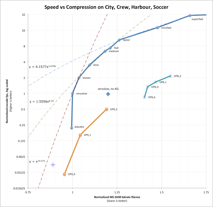

    Recommended preset? As slow as you are willing to accept. The speed difference between them is enormous:

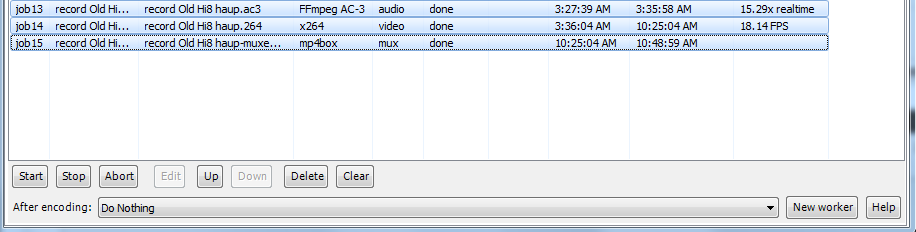

  5. There is a 100 fold difference in encoding speed between x264 fastest (ultrafast) and slowest (placebo) presets. With SD material I usually work at --preset=slow -- crf=18. If there are no other bottlenecks that gives me about 100 percent CPU usage and 35 fps. On an Intel i5 2500K.
    Of course, if you're using lots of slow filters like QTGMC and TemporalDegrain that will contribute to the encoding time. If AviSynth is a bottleneck using a multithreaded build of AviSynth can speed things up if you have a multicore CPU.

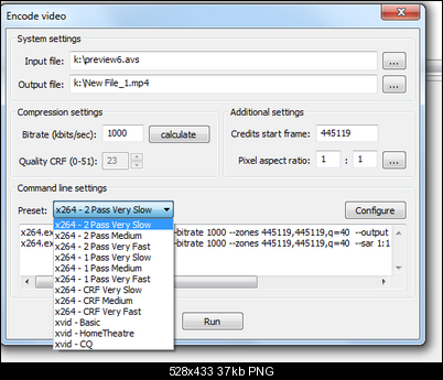

    What should the settings here be (I also see that I can't select the CRF like you guys are)?

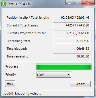

    x264 is telling me that it's currently at 11.07 fps with an eta of 7 and a half hours still...and I don't even know if it's a good idea to start another capturing test while this thing is running. It's like I'm simply stuck here waiting a day for it to finish.

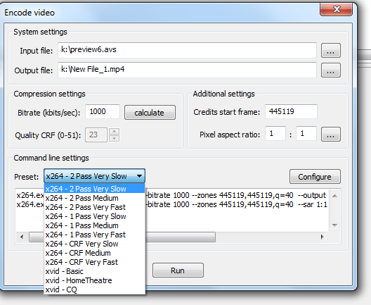

    I can see the CRF modes in your screenshot.
    If your system is already being used for a different job it won't make sense to test speed. Wait until your system is idle again.
    Just realized I had to click the 3 options on the list that say CRF after the x264 to make that option un-grayed out...

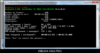

  11. A very useful diagnostic tool is avsmeter. It can tell you many thing including cpu usage, min/max/avg FPS ,GPU usage for GPU based filters, etc... it can help determine bottlenecks, help arrange /optimize scripts etc...

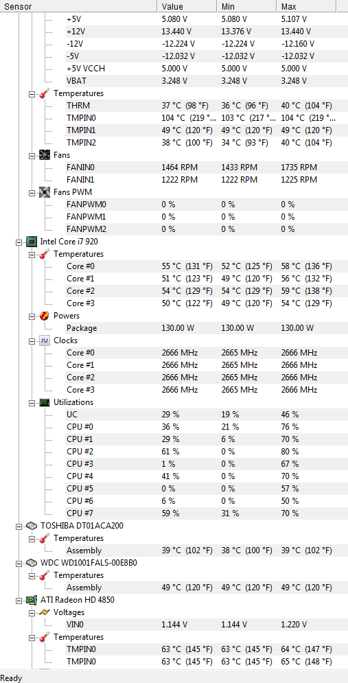

  13. My system is Intel Core i7 - 920 @ 2.67GHz, Ram is 11 GB
    The i7 920 paired with its stock cooler is known to overheat in some cases, check your cpu temperature with hwmonitor or an equivalent while running an encode, it might explain some slowdowns. Anything over 90°C is a problem.
  14. A very useful diagnostic tool is avsmeter. It can tell you many thing including cpu usage, min/max/avg FPS ,GPU usage for GPU based filters, etc... it can help determine bottlenecks, help arrange /optimize scripts etc...
    I opened up both AVSMeter and AVSMeter64 and they both flashed on the screen closed in a millisecond...so I don't know what's happening there. Meanwhile x264 is still running with an eta 3hr5min.
    Here is what I got: https://forum.videohelp.com/images/imgfiles/dP7UQZn.png
  15. Originally Posted by CZbwoi View Post
    RE: avsmeter
    It's a command line application
    But you can use it as a drop & drag (drop and drag your avs script onto avsmeter.exe), if you edit the configuration.ini file. There should be an avsmeter.ini file in the avsmeter directory if you've run it once. Open that in notepad and where it says "PauseBeforeExit=0" set it to "1" instead of "0", save it . Then drop & drag your avs onto it again. 32bit avsmeter is for 32bit avisynth. You probably need a decent length test for results to be valid (10 sec clip might not be long enough, but go ahead and try)

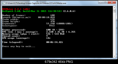

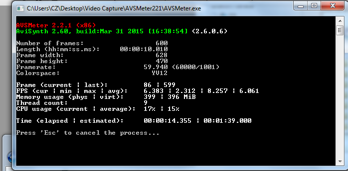

  16. Alright here is what I got with the 10 second script clip (that I also attached in my last post). Note that the x264 long encode is still running in the background, but that might not do anything to this.

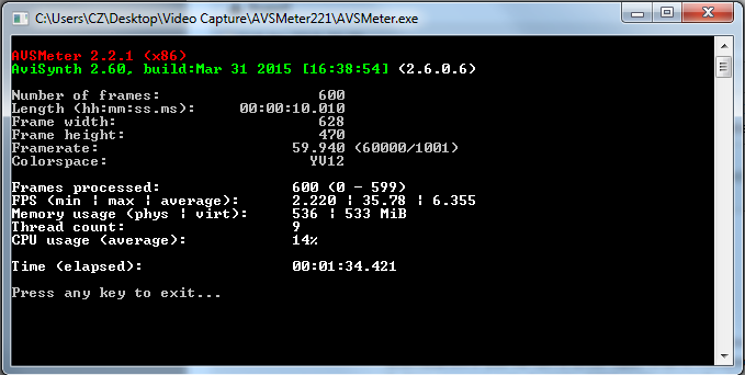

    And in the process it looked like (ran it again):

  18. Not sure how valid those numbers are when running x264 in the background , but it matches your observations. It certainly suggests your script is the bottleneck. You're getting ~6 to 6.3 FPS, but have 59.94 FPS footage, so approx 1/10 realtime speed with the script only , and low ~15% CPU usage. Typically you can get about 2-3x speedup with QTGMC using MT
  19. QTGMC() running single threaded would explain 15 percent CPU usage on a 8 thread CPU.
  20. @ziggy1971: Did you read the rest of the thread? I think everything you asked about was answered other than the HD's. It's being stored and saved on a new 2tb hard drive, 300gb left. All the converters, programs, etc. are on the main C drive.
    How would I do this? I need to uninstall everything, or just QTGMC, or Avisynth and get another version again?

  22. Originally Posted by CZbwoi View Post
    How would I do this?[/QUOTE]
    Download a multithreaded build of AviSynth. Copy AviSynth.dll over the one in your System32 or SysWow64 folder. Maybe this one:
    http://forum.doom9.org/showthread.php?t=148782
    You'll need to add SetMtMode command in your script. Usually something like SetMtMode(5,8) at the start, SetMtMode(2) after AviSource().

  25. In AVSMeter the fps is currently an average of 15-16 with an eta of 7 and a half hours (and nope, now it went up to 8hr). I see the CPU usage is at about 50%, how do I smack it up to like 90% or nearly 100% to make it go even faster?
    I do not know why WinFF is giving me it half as fast, and it frustrates me because the files comes out looking so much better over there than in MeGUI where it turns blocky at the end. If I could get MeGUI to match that preset's settings (possible?) it'd be great. Or if someone has a better preset they have for something like this for MeGUI, beautiful.

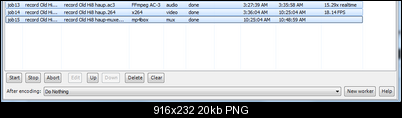

    It's currently about to finish taking a total of 7 hours:
    - scratch that, another window opened up with 'importing tracks' and 20 more minutes...

  26. Originally Posted by CZbwoi View Post
    Here are my takeaways: why does the MeGUI pair look worse than the WinFF one? You can notice it in the face at the end of the clips, the MeGUI ones degrade and add so much noise and blockiness on the face at the end, WinFF does not. I also don't even see a difference between the 2 MeGUI ones despite it being 16 versus 20.
    Because you set zones 343,599 q40 . This overrides x264 to increase the quantizer to 40 for frames 343-599 inclusive. It's inverse relationship (higher quantizer results in lower quality) . Open mediainfo (view=>text) and the meta data will show some of the encoding settings used
    zones=343,599,q=40
    It might be that you saved or used an old preset or something in megui and didn't know about it

    I put 24 in the threads section at the bottom because someone online told me I have a possible number of 32 threads because I have 8 possible cores.
    The i7 920 has four hyperthreaded cores. So the CPU can run 8 simultaneous threads. You sometimes need more software threads to keep all CPU threads busy. Start with 8, if that doesn't give you near 100 percent CPU usage try bumping up to 10 or 12. Running more threads than necessary will slow down processing.
    You usually don't want to switch to mt mode 2 until after the source filter.
    zones=343,599,q=40

    The encoding in MeGUI finished and here were the stats:
    The finished file is 3.97gb, original was 58.4gb. Length is 2hr 3min and 46sec.
    Here's a comparison, remember that super long 24 hour AvsPmod encode with their CLI using my x264.exe? That file is just the video since no audio was added to it, but it's 890mb compared to MeGUI's 3.97gb.

    I'm getting near the same results with your script, eta 5hr 30min, as with this scipt:
    SetMTMode(5, 16)
    AviSource("k:\record Old Hi8 haup.avi")
    AssumeTFF()
    ConvertToYV12(interlaced=true)
    tweak(-2.5,1.5,10,1.0)
    SetMTMode(2)
    QTGMC(EZDenoise=4.0,Preset="Slow", Sharpness=1.2, SLMode=1 )
    ColorYUV(gain_y=71, cont_u=48, cont_v=12)
    Spline36Resize(640,480)
    crop(0,0,-16,-8)
    Distributor()
    Is there any benefit to setting a max memory like you did? And having the SetMTMode(2) before AssumeTFF() and everything else?
