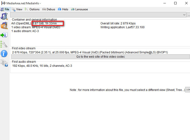

    Originally Posted by loa909 View Post
    Well I have now tried AVS2DVD on a 1.87GB avi clip it took 3 hours 26 minutes to convert is that normal as seems a hell of a long time just to comvert a avi clip
    The file size of your source is irrelevant. What counts is its running time. How long is it?

  13. Member loa909's Avatar
    Mar 2007
    How do i find out how long the running time is
    sorry my mistake it says at top of media info 1hour 33 mins it seems
