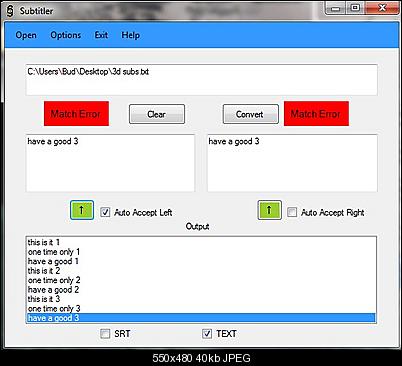

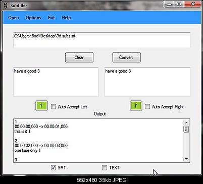

    Sorry a little late seeing this? Is this a one time thing or do you need on regular basis? I wrote a quick 3D to 2D converter for text but could probably convert quickly to SRT if there is an on going need.
Name:	ScreenHunter_190 May. 08 23.15.jpg

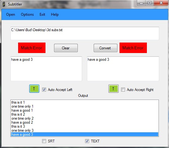

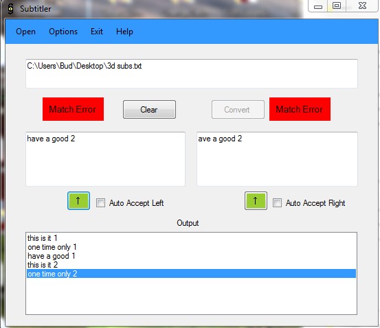

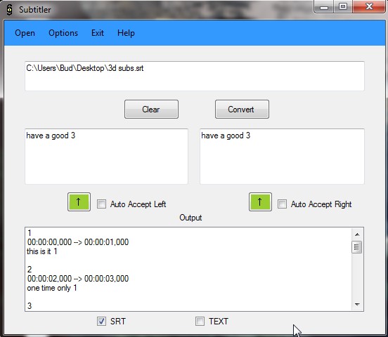

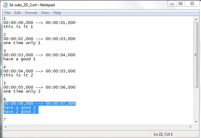

    phred1, Okay its quick and dirty but it works on TXT or SRT now. The checkbox will change to whatever you drag and drop in the input window. Also, it will work for up to 3 lines of subtitle text as shown in item 6 below that shows 2 lines with the same time frame.
    Bear in mind if the line (3D) has extra spaces on one side or the other, it may give you wrong text since it splits in half for each side. Theright side is Left trimmed so there will be no spaces on the left of the text. This should help for slight differences.
    It will show you if they mismatch. Just check whichever side auto that looks right or manually click the right one.
    I can make changes if you see things that could be corrected or don't work right.
    Right now the file is a ZIP file containing only an EXE. Feel free (I encourage it) to scan with antivirus since zip and EXE can be bad but I assure you there is nothing in there except Visual studio compiled exe.
    The link is https://files.secureserver.net/0sw3QrpPLI2UVc and should require no password.
Name:	ScreenHunter_190 May. 10 00.10.jpg
ID:	36946Click image for larger version
Name:	ScreenHunter_190 May. 10 00.11.jpg
ID:	36947Click image for larger version
Name:	ScreenHunter_191 May. 10 00.11.jpg

    Thanks! I think your app works as it should. I've tried it on two subtitles and the first one was perfect. The second one didn't go as well since it had some linebreaks in the wrong places (from Subtitle Edits OCR). I cannot blame your app for not handling the linebreaks!

    If you can supply a sample of the failing subtitles, I can alter the code to work with this kind of problem.
    BTW.. if the parser stops on a mismatch you caN edit the text directly in the split boxes, like delete extra characters and then hit the green arrow accept for that side. The program copies whatever is in the split box for that matchingarrow accept button.
