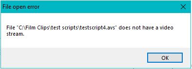

    I have zero background in programming and have been trying for days... and days... to get any of these scripts to work for me, and never get off the ground.
    When I try opening 8mm enhancement scripts in VirtualDub2 I invariably get a box saying 'File Open Error' File.... does not have a video stream. This regardless of what avi I try to open. Or, the scripts just shut down VD2 altogether.
    Yet, I am able to run Filters such as Deshaker in VD2. And I have been able to run some in VD1, too. But most of what I want to do with my clips apparently exists only as scripts, not filters.

    Fred - yes, I should have mentioned that, sorry. I first installed Avisynth as suggested in your video https://youtu.be/irbZewfz-SA?t=210 . Given my poor results, I thought I have done something wrong, so I then uninstalled that and used the instructions here: https://www.l33tmeatwad.com/avisynth101/software-setup
    John - I tried the simple script you posted above, and now it works. Which I don't even understand, because until now I literally could not open a one-line script using AviSynth; I could do *other* things using Vdub1 and 2, but not run scripts. One of my last tweaks must accidentally have solved part of the problem. Until now I only received the error below, and I don't understand what it is trying to tell me. The path is correct, so what does "does not have a video stream" mean? Image
    [Attachment 71162 - Click to enlarge]
  19. Originally Posted by matyas View Post
    That usually means that you are not using the correct DLL to open the video. Every video uses a codec (coder/decoder) to encode the video. In AVISynth, you have to use the right DLL call or the video will not open.
    In my example, I used AVISource. It will open some AVI files, but if the AVI file uses a codec that it doesn't support, it will fail, probably with an error message similar to the one you posted. FFVideoSource is another way to open videos. You can use Mediainfo to find out what codec your video uses. You can also post a short clip and people can tell you what AVISynth call will let you open the video.

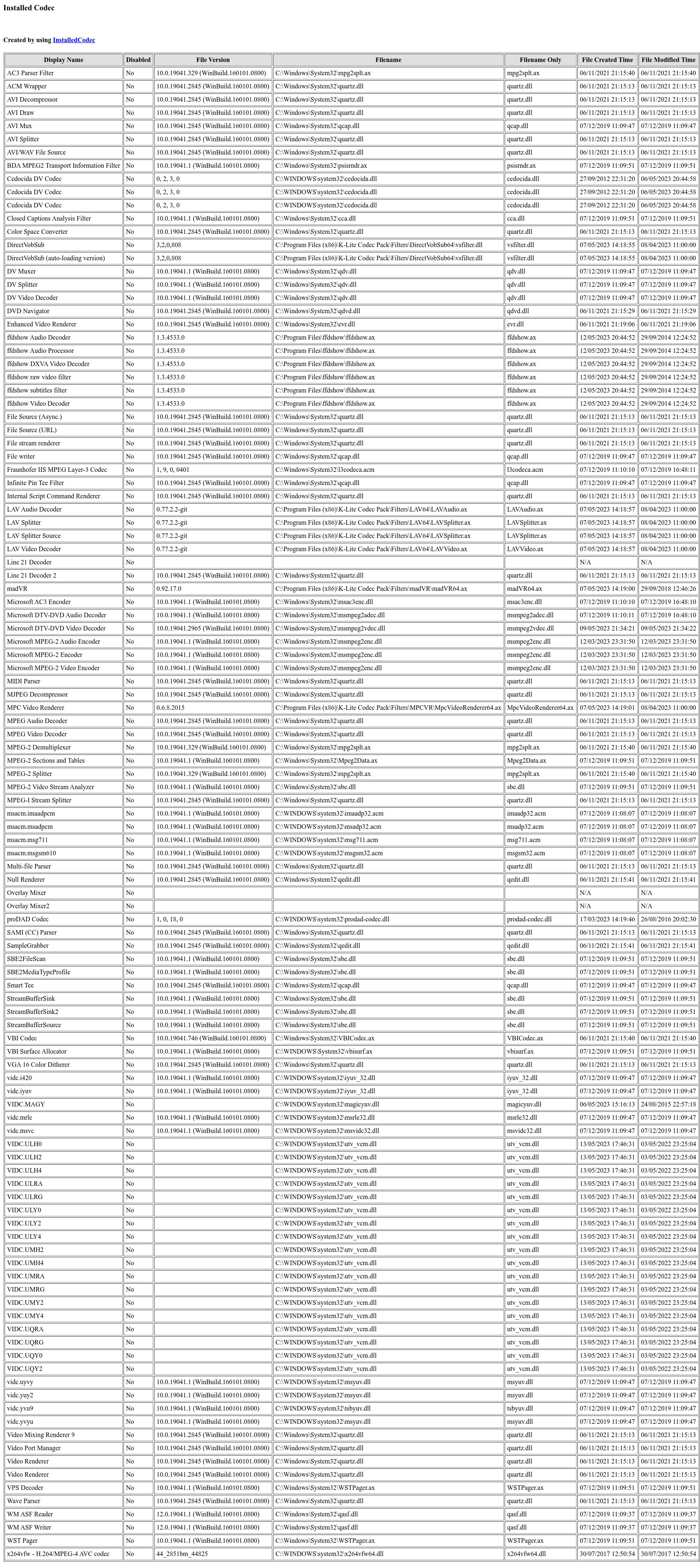

    Re: Codecs, I have installed every Codec I saw recommended as useful to this project - but I am not sure if I installed/unzipped them in the right place. I cannot seem to find a definitive answer (using Google at least): do all codecs need to uniformly be put in a single location? Or do different codecs need to be installed in different folders?
    Attaching a list below. Many of them are in C:\Windows\System32\, but also several in other locations and I am not quite sure now how they ended up there. Some are in Program Files (x86)\ - is that right?
