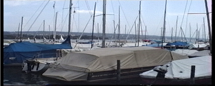

    I was interested to identify if high end Hi8/video8 decks could be or not a better player than Digital8 Camcorders for capturing video8.
    I tried to look for evidence about the effectiveness of prosumers Hi8 decks for this use but information was scarce and was difficult to arrive to a definitive conclusion.
    So I decided to try to find out for myself .It took me some time to find a high end video deck with an acceptable price and that theoretical could be in good condition. I recently decided to bought the flagship Sony prosumer deck EV-S9000E ( PAL) (manufactured between 95-99 ) . I have also considered the Sony EVO-9800P, c2000 and S880 but the EV-S9000E had apparently best specs, was easier to find and I got it for a reasonable price.
    The deck has almost all the bells and whistles, namely edit function, TBC, Picture noise suppressing ( off, standard and maximum-only works if TBC enabled) picture control ( Color, Sharpness Y/C delay ),Digital comb filter , drop-out compensation, voice boost,stereo HiFi, PCM, Tracking adjust ( slow,-slow and x2 ) , F- Mechanism and a lot of other goodies that I will probably not use.
    Even If I had some expectations I was prepared to get no better results that the ones I already had with a Digital8 Camcorder as it is a refurbished older unit and the condition even if announced as very good , could not be as announced.
    Iīm putting in some samples if anyone is interested to compare. The video8 tape was in medium condition and has lots of straight vertical lines so must be adequate.
    Preliminary thoughts
    Pros
    . Less noise - It seems to provide captures with less noise ,even with NR disabled. If enabled NR seems to works reasonable well and it can put eventually the question if it will be better to capture with or without NR enabled.
    .Color restitution – It seems the color reproduction is more accurate*namely if using picture color control but it depends on tapes
    Vertical Lines – Seems more effective even without tbc , better than the D8 camcorder
    .Color edge issue the D8 have a significant right color edge issue, this sometimes has a top color edge issue but less omnipresent then on the D8
    .In a tape with quality problems where the D8 in a section almost captured no image and no sound , this one was able to capture the image almost without problems but was also unable to capture sound as the D8. However I feel that for problematic tapes ( but not very problematic) it can provide better results

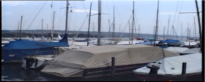

    CONS
    .It seems to deliver a little loss of picture detail related to the D8 Camcorder even with the picture control sharpness increased. But it depends on tapes .Getting a little more contrast seems to improve detail a little.
    It gets quite hot if working for more then 3/4h continuously even with a normal ambient temperature. It needs to be well ventilated.

    For me, the worst part of all these captures is the "sparkling edges". My own NTSC Video8 captures (played via Digital8 cam) show the same thing. I was expecting the Hi8 deck "Sharp On" to show this, but the "base" capture does as well. They look identical, apart from the typical playback inconsistencies. Are you sure sharpness was really set to off for the initial capture?
    Perhaps a capture from the Hi8 deck in EDIT mode would avoid this issue, though I'm doubting it now.
    My preferred Hi8 deck capture is the TBC+NR on version. The edges don't seem as grungy as the "base" version and there are no horizontal streaks of noise.
    The D8 adds white haloes around everything. I think the choice comes down to whether you prefer a more natural-looking scene where details look smeared, or a "boosted" version where details are clear. I'm not sure which I would go with.
