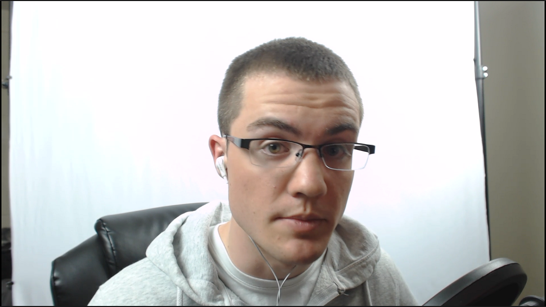

    I have an MP4 webcam video file taken with a Logitech C920 recorded with Logitech's proprietary recording software and the video I recorded came out just fine. Example: https://forum.videohelp.com/images/imgfiles/JA3jmQR.png
    I make gaming content, so its essentially just a face cam when I overlay it over an uncompressed lossless Lagarith codec recorded gameplay avi video.

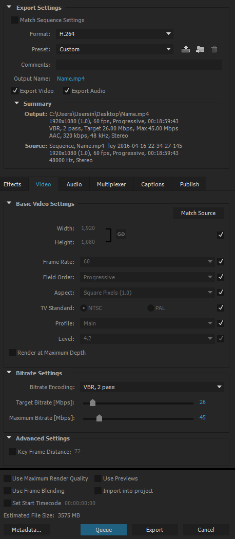

    I've also tried different encoding settings, but nothing I tried really made a difference other than the quality. The bitrate is kinda high for 1080p60 as I'm using it for archival purposes. Probably could go smaller but I don't really like messing with the rates. (Not that experienced.)
    I have a feeling it has something to do with Logitechs software I use to record it, as I don't know what codec its uses but then it wouldn't make sense because it plays just fine in VLC and Windows media player before put into Premiere.
    Here are my encode settings: https://forum.videohelp.com/images/imgfiles/qKAyCG3.png
