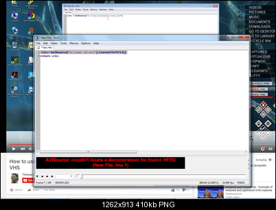

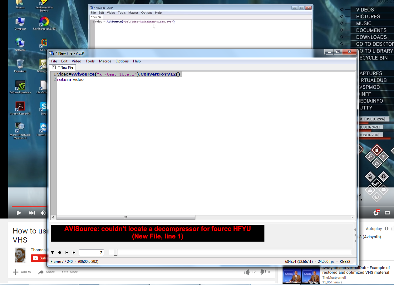

  1. Here I am trying to finally delve into the world of Avisynth and start to dabble with it, started by following this video, but did a step it didn't mention and created the .avs file first off with avisource("test 1b.avi") inside of it in the folder with the video. Followed the rest of the steps, got AvsP and...this error came up. Googling it is only taking me to foreign forums I have to translate and try to read, one of them pointed to install the huffyuv codec but I'm pretty sure I already did that because that's how I captured this .avi, with VirtualDub and huffyuv.
    Any insight onto what's going on?

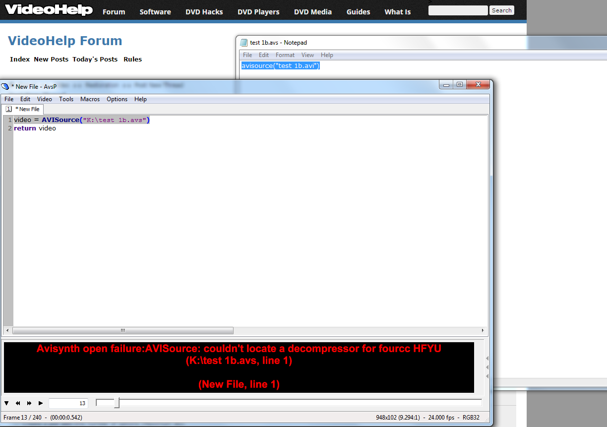

    By the way, you wrote .avs (I boldfaced it for you) instead of .avi for your AviSource line. That will keep it from opening as well. If you really meant to open another AVS file, you use Import and not AviSource.
  3. What happens if you add:
    .ConvertToYV12()
    right after (on the same line) as the AVISource line?
    Video=AviSource("k:\test 1b.avi").ConvertToYV12()
    return video

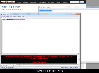

    The same thing happens:
    Hm, I was just following what the guy was doing in the video I linked to in the first post (and what's seen in the background of the ^picture) and it seemed to work for him the entire time. In the comments he even addressed that and that he also does it with the created .vdr file:
    "Why would the frameserver be running and .avi file but your AvsP is using a .avs source file?"
    Don't be afraid of that! But its true its a little bit too less explained. You can also use the path to the video.vdr file which you save when you create the frameserver with VirtualDub ( https://youtu.be/WXhLmH_ul94?t=64 ).
    The video.avs file I use in the video just includes the video.vdr file as an avisource like this:
    #filename:video.avs
    AVISource("D:\Video-Aufnahmen\video.vdr")
    So in your avisynth script you can directly include the video.vdr file.
    video = AviSource("D:\Video-Aufnahmen\video.vdr")
    video = ConvertToYV12(video)
    video = AssumeTFF(video)
    video = ...
    Hope that helped
  4. That script in the video is referencing a VDub filter which, as far as I know, isn't true in your case. That guy's whole thing is way too convoluted, in my opinion.
    HFYU is the Huffman codec. Do you have it installed? Can you see it in the list of installed codecs in VDub (Video->Compression)?
    What happens with just a simple:
    AviSource("k:\test 1b.avi")#.ConvertToYV12() ###Shouldn't really need to convert the colorspace just to open the video.

  5. That script in the video is referencing a VDub filter which, as far as I know, isn't true in your case. That guy's whole thing is way too convoluted, in my opinion.
    I would prefer to see a live preview of what is happening in the actual video as I'm adding codes and filters since I'm new to this, and his method with AvsP seems to do that...
    I do not, I thought that was referring to the Huffyuv codec I installed for capture (?).
    Inserted the whole thing into the first line once, same error happened. Erased everything from the ### and on, same error.
    edit: So huffyuv isn't even in video > compression when I'm in capture mode anymore, that's where it always was for me. I'm checking in SysWOW64 and both files are still in there, huffyuv.dll and huffyuv.inf. I literally just captured with it enabled a day ago, what happened?

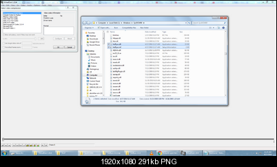

    I seriously must be doing something wrong here. I followed the text file instruction in the download and right clicked > install on huffyuv.inf. That did nothing, it still won't come back into VirtualDub. Then I moved both files and replaced them again in SysWOW64, still nothing. Everything worked a couple days ago when I first installed it by moving both files there.

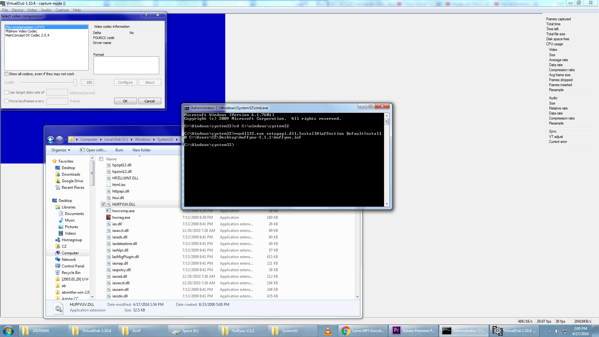

  8. Huffyuv was written back in the day when nobody had 64 bit computers. It needs a special installation procedure to work in 64 bit windows. This post is about Lame but the procedure is the same for Huffyuv:
    https://forum.videohelp.com/threads/271712-Lame-MP3-Encoder-on-Vista-x64#1723154

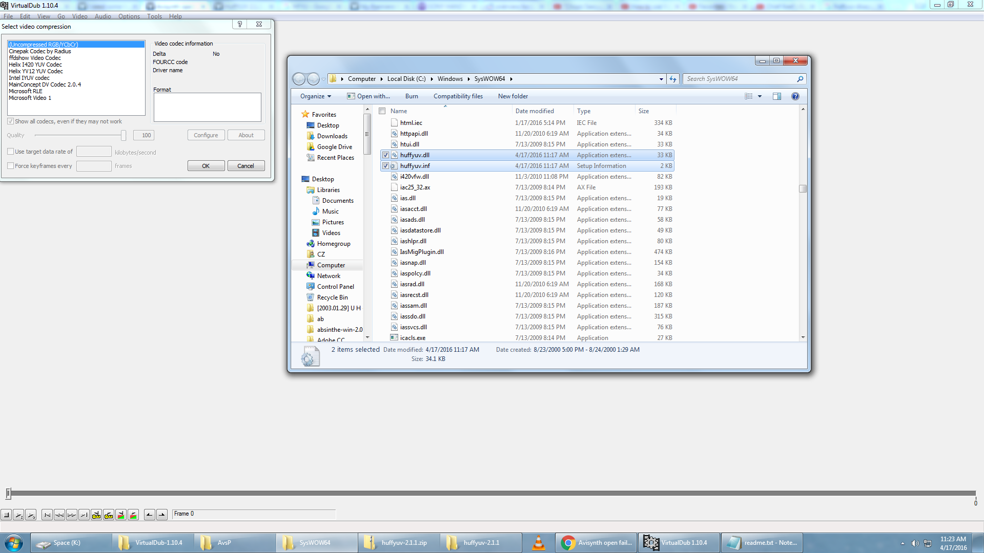

  9. What if I downloaded the 64bit version of Huffyuv and installed that the 64bit way in SysWOW64? Because now a 64bit *does* exist, I mean it's right there on the download page, and I followed this video and it worked. Until I tried to use Avisynth and uninstalled it and reinstalled, I think that's when the codec stopped appearing in Vdub.
    Now you're telling me to install the (direct link) version into system32? Or the 64bit version into system32 since I run 64bit? And what do I make of the fact that huffuv is already in SysWOW64, do I erase them..?
    edit: I seem to may have answered my own problem, it all changed when I was advised to switch to the 32bit version of Vdub because that one has more filters and such available apparently, which is odd because I never thought there'd be a discrepancy that large between a 32bit and 64bit version of something. Therefore the codecs I installed for the 64bit one would have no place working with the original 32bit version. I'll report back if I do the new huffyuv install correctly.
  10. I ran the command line your thread pointed to, computer made a noise like it was doing something for a second or too. Went inside Vdub to check and it's still not there.
    Opened up System32 and there's a HUFFYUV.DLL file and the date modified says a few minutes ago, so I'm guessing that's what the command line did, but it still doesn't work.
    [Attachment 36615 - Click to enlarge]
    Edit: thank you Jesus, I got it. Thanks to edt (no pun intended) and javaman for pointing it out.

  11. Jagabo is referring to 32bit codec on a 64bit OS
    If you plan on using 64bit version of huffyuv (or any codec), the entire application chain must be 64bit. This means 64bit vdub, 64bit avisynth , 64bit whatever, or there must be an application "bridge" of some sort to pipe 32bit<=>64bit
    Most avisynth filters are still 32bit (although there are more 64bit versions these days), and most avisynth/vdub workflows are still 32bit
