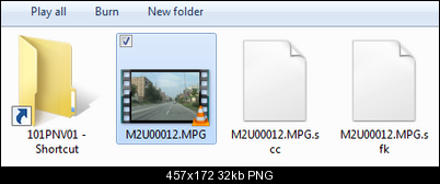

  4. Waking up this thread for some help as I got Vegas. I'm dragging a bunch of files into Vegas now and for every file I insert it places these 2 files inside of my source folder where the files are: .scc and .sfk files. What are these and why are they appearing? No such thing appears for PP or anything else I've ever used, this is odd.
    Then after manually erasing them, the .sfk ones seem to come back once I move around in Vegas. I even closed the new project, didn't save anything whatsoever and they're still there; they didn't even disappear from getting rid of an unsaved project.

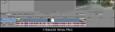

    Also this is very miniscule but in the Vegas timeline, even though I'm zooming in it's not showing frame by frame representation of the video, it's showing one frame every however many seconds followed by a grey streak. Is this normal or is there a way to get rid of the grey streak and have actual frame representation from the videos appear?

  5. .sfk are the drawings of your audio waveforms. .scc is subtitles - most likely your time and date stamps. Premiere does exactly the same thing, it just stores them in a different folder unless you specify otherwise.
    Did you mean thumbnails on the timeline itself on the video layer ? You can enable it in the options=>preferences => thumbnails to show in video events and check which option you want (e.g. none, or all, head/tail etc..)

  8. .sfk are the drawings of your audio waveforms. .scc is subtitles - most likely your time and date stamps. Premiere does exactly the same thing, it just stores them in a different folder unless you specify otherwise.
    Is there a way to make them not appear at all or in a separate default Vegas folder instead like in it's Program Files? I want this folder I have with all this source cam footage to be strictly that, I don't want 2x more the amount of meaningless data files in there with the bunch getting in the way of everything.
    Thanks for that, it was in Options > Preferences > Video > Thumbnails to show in video events > All
    I don't know offhand, not sure if you can change the folder, but you can have a look in the options

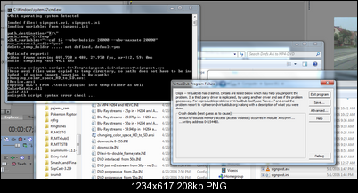

  14. Originally Posted by CZbwoi View Post
    when I try to do what you say I get this error
    Virtual Dub crashes when Avisynth script is loaded into VirtualDub because of your Avisynth problems. You use different Avisynth flavors etc. I use just the one downloaded from this website.
    Btw. I deprecated that VirtualDub function, loading lately and replaced it with avsmeter. VirtualDub is not needed anymore in that script. You can try to download AVI to MP4-DVD.zip again and try it.
    I think that's what _Al_ was talking about, besides the repeat audio glitch at the end , it also resamples to 44.1Khz - those were the reasons for prerendering audio
    There are possibly three bugs for audio in total, they can occur or not, God knows what it depends on. Vegas version etc.
    1. That audio frequency is one.
    2. Second is silent audio. If frame server is ran second time (after encoding or even after testing avs script by software, audio is silent). So frame server has to start to generate audio as a absolute first thing, which is sometimes not possible. But doable if done manually. Like command line or even if software that does not do anything with avisynth script before.
    3. Possible audio glitch at the end of audio track.
    It is not a problem to pre-render that audio, Vegas generates AAC audio (in m4a container) or AC3 audio (192kbps without DVD Architect licence) without any problem. And I even adjusted my script for that, it can take that AAC or AC3 prerendered and create MP4 or VIDEO_TS

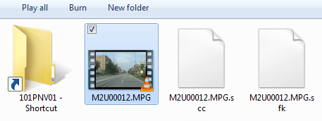

    Btw do you know how to get rid of or move where these .scc and .sfk files get placed by Vegas so that they're not next to my original files anymore? I can't find anything that says this in the preferences. (I do not even understand why it's making closed captioning files when there are no closed captions or subtitles in them)
  17. Yes Vegas,
    I just looked - precisely, It is called MainConcept avc (mp4) , whatever not MainConcept mpeg4, I have a box there that says Include video so I uncheck thta box, you have to have something like that in there in custom setting
    That wave choose 48000 16 bit stereo.
    I vaguely remember that location of those files cannot be changed. But just set folder priorities to type, they would pile up separately, click "type" is windows explorer. It is really no big deal then. On the contrary. After editing you just select them easily and delete. Or grabbing just avi's you select them all easily as well.
