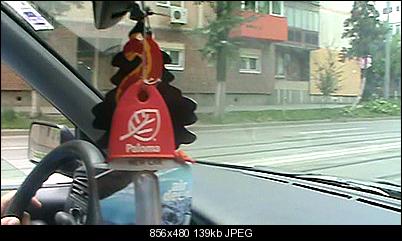

    Yeah, got some chroma problems. This is a smaller copy of the image posted in #56:
    Is the frame size really 1920x1081? Can't work with odd numbered pixels in YUV, bro'. I think that was mentioned.

  5. Is the frame size really 1920x1081? Can't work with odd numbered pixels in YUV, bro'. I think that was mentioned.
    No, VLC says that the display of the file is 864x482 and the display resolution is 854x480. That picture is from me going fullscreen in VLC and pressing the print-screen button.

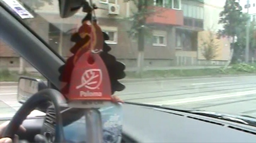

    This is the same frame from the attached mp4, at 16:9:
    M2U00012_16x9DAR_480p.mp4
    Yes, that actually looks better! Did you do this through Vegas? The only thing wrong here is that the borders are back, but I suspect that will be fixable doing the Square Pixels route I learned here, right? Should work the same as in PP...

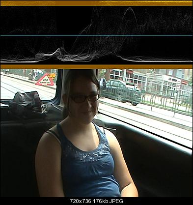

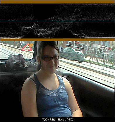

    For people that don't know avisynth I included encoded square pixel versions below of the comparison for LMotlow's videos, no audio. (Looks like some matrix , color differences, between the 2, maybe RGB in deshaker wasn't accounted for, but I realize it's just a demo). Only pay attention to the motion characteristics, because this is a lower bitrate multigenerational copy. Yes, it's pros/cons, and maybe for the OP's goals he doesn't want to zoom in even a bit, but based on those motion characteristics I would stabilize it a bit.

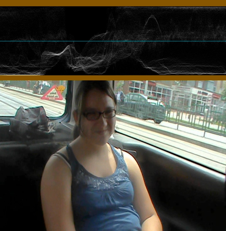

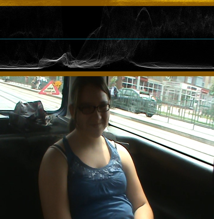

    I'm not saying you should do this, I'm just throwing out some ideas . Obviously the passenger in the back is an important subject, at least in this clip, so personally I would try brighten it up a bit
    To brighten the backseat, several ways you could do it - with curves, most NLE's have some sort of shadow adjustment (e.g. shadow/highlight filter), or even through masks/compositing but it's more tedious that way. More difficult to do in avisynth, because you have to Trim() or apply through a range and you can't easily "keyframe" values. But to do it in avisynth alone you could use masktools with a shadow mask to cover a Y range, and use mt_merge. Dogway has a nice lumamask() masktools wrapper function where you can pick the range, so you can selectively filter a range differently
    Here is a rough example in avisynth to demonstrate , non PAR corrected (ie. 720x480 1:1). All I tried to do is compress the range to 16-235 and brighten the shadows, as you can see from the waveform (It's just histogram() in avisynth but flipped). It's easier to do levels, color manipulations in a NLE for most people, because there is a GUI and most importantly , easier to keyframe or adjust over time. Because these settings here wouldn't be valid in other parts of teh clip.
    original
    reduce highlights, brighten shadows
Name:	reduce highlights, brighten shadows.jpg
    But pay attention to the blown out areas on the street (you can see pavement details now that were "not seen" before). Interior is a bit brighter, but you can only go so far before you reveal "dirt" and compression artifacts from the shadows, so you might have to denoise the shadows depending on how far you manipulate it, and you usually have to color correct it a bit afterwards too - I didn't do any of those, it's just a quick levels demonstration
    The point is try not to discard details that are recorded. One benefit of vegas, is it uses studio RGB for most native camera formats, instead of "regular" sRGB. This means coming from a YUV source, you won't clip those overbrights right away when working in RGB. PP has a YUV capable timeline, so you can "fix" them as well. But some other editors convert to sRGB right away without allowing access to YUV and you lose those detailsdetails.

    Good points, Poisondeathray. The quick way I used was hdragc but toned it down with heavy adjustments and SmoothLevels and then a touch of ColorMill later. Yeah, those street details would take time, they kept going in and out depending on what I used. Curves would be more precise. Usually I would've gone with a mild contrast mask and curves. Great filter.
    As you suggested, there is low light noise in the MPG's shadows. EZDenoise took pretty good care of that. Thanks for the new demo.
    That whole post and your examples were awesome. Thanks for taking the time to do that and explain it, I will probably do the same now!
