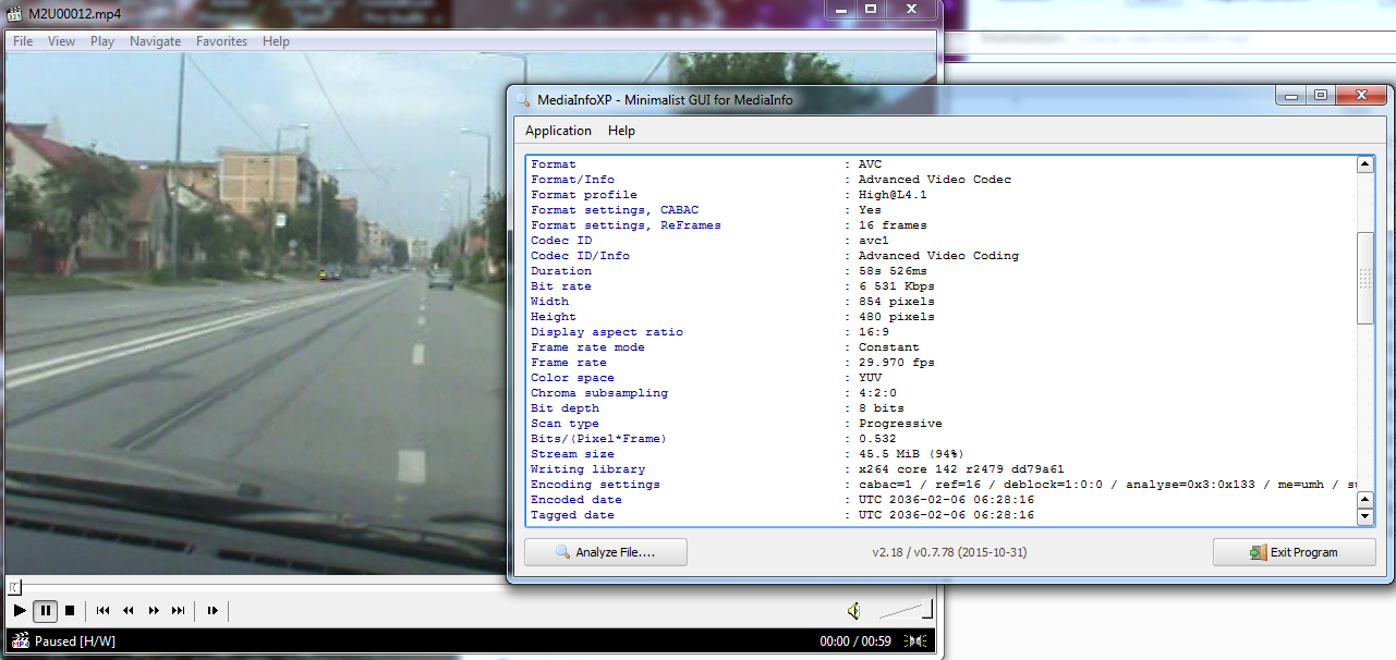

    an easy way to get your source file converted to standard 854x480p mp4 with no black bars top and bottom is with vidcoder. it handles your source file with no problem. once they are in standard mp4 you may find other programs work with them.

  5. People say the same thing about Premiere, yet we see how it confuses this video's aspect ratio with the standard.
    The short explanation is there are slightly different aspect ratio interpretations. PP uses ITU aspect ratio interpretation
    It assumes that NTSC 720x480 16:9 uses a pixel aspect ratio of ~1.2121 (or 40:33) which is slightly wider instead of non ITU aspect ratio interpretation which uses ~1.1852 (or 32:27)
    Your original is 16:9 (1.78:1). Your export has a slightly different aspect ratio of 109:60 (1.82:1).
    The export is incorrectly tagged as 109:60 instead of 16:9, which is causing the display discrepancy.

  6. Vegas uses ITU AR, just like premiere. You will get black bars unless you do workarounds, such as resize with square pixels, or frameserve out similar to PP. You will find most professional NLE's use ITU interpretation because that is the standard.

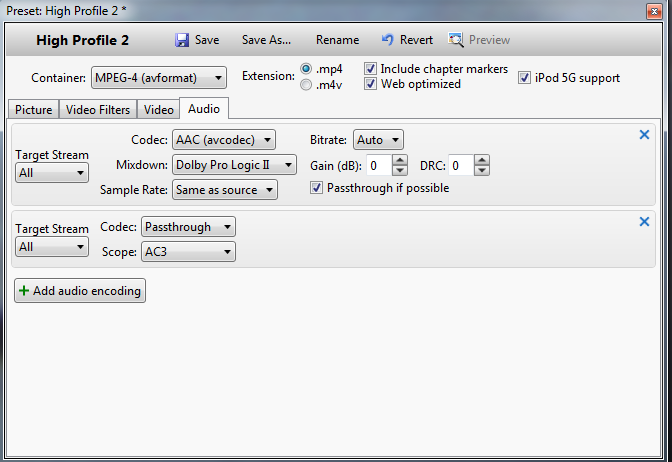

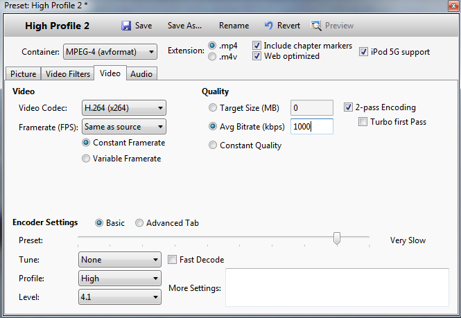

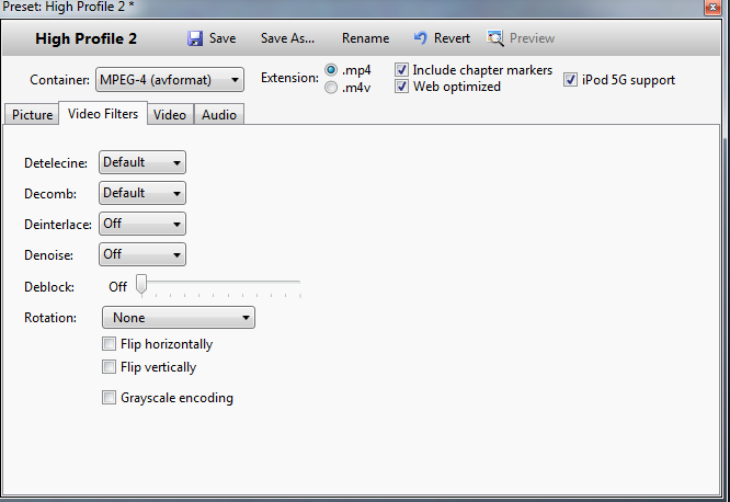

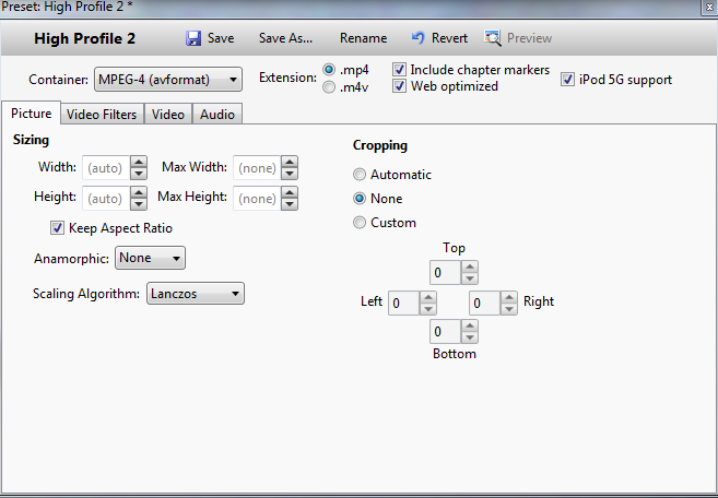

    Okay guys, so I've had VidCoder installed in my computer for a while, it's version 1.5.34.0 and this should be good to try out what you're saying. I dragged all the files into the bottom half of the screen. What do I do for the best quality and result in MP4 like you said but also with double rate deinterlace like what poisondeathray suggested? The preset is currently set to Normal (Modified).
    There's a Picture, Video Filters, Video and Audio tab and I'm assuming all will have to be dabbled in.
    Bonus question: This file that is exported out of here, or even the one I got in Premiere (which I made with 854x480 but it's not deinterlaced because it's not possible there), can I insert that into Avisynth and do some further altering to it like the overbright levels/stabilization you suggested, or would that be a no-no since I'd be re-encoding it or compressing it more than once? Bad idea?

    Vidcoder just an alternative GUI for handbrake, and you've used handbrake before. It's basically a GUI for x264 and can do few manipulations like cropping, deinterlacing, resizing. Deinterlacing isn't as good as QTGMC

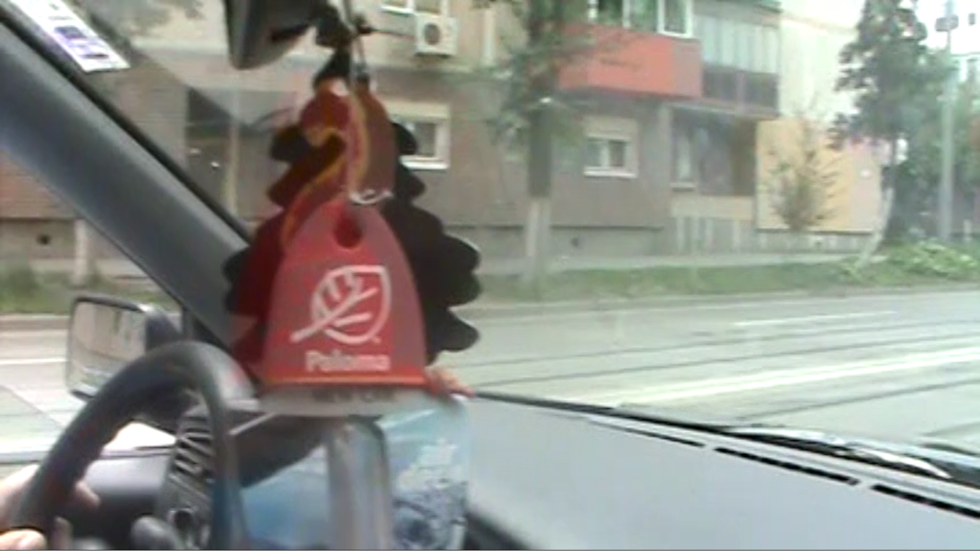

    If the same you uploaded was representative of the other footage, some other things you might want to address are the levels (you have overbrights > Y=235) , maybe some stabilization. The other things you might want to do are more subjective, but for sure you should fix the levels
    Is there a specific code you would point to to fix that?
    Yes, but you would ideally adjust it over time, because it's not overexposed all the time, only in certain segments. Often with consumer handheld footage, there is auto exposure going on. The "brightness" changes through the clip . It's more difficult to adjust in something like avisynth. In NLE's you typically keyframe the changes (the settings change over time). But the point is you have usable overbrights , most consumer cameras do. (there is usable data in that range, that won't be "seen" if you leave it as is)
    Huh? what isn't possible there? It's possible to deinterlace in PP, it's just that the quality isn't as good as doing it with QTGMC.

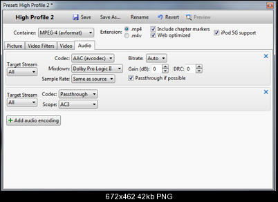

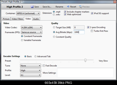

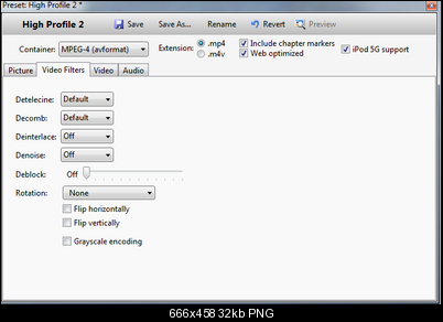

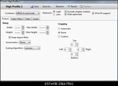

  16. aBigMeanie aedipuss's Avatar
    Oct 2005
    666th portal
    if you like the way the video turned out that i posted you don't need to change much in vidcoder. these pictures show the settings used.

    But try exporting 720x480 16:9 AVC from vegas ie. non square pixel, same as his original source.
    Vegas uses ITU AR interpretation, same as PP. Look at your project properties and export settings. NTSC DV 16:9 PAR is read as 1.2121, same as PP, which is the ITU 40:33, not the 32:27 that he wants
    40/33 =~ 1.2121
    32/27 =~ 1.1852

  29. So I got back home and checked on VidCoder and it finished with the files except...nothing was joined..? I thought this would join my files in addition to converting it, because that was sort of y'know...the idea behind what I wanted lol. Now instead I have 12 files turned to MP4 (regardless there's black borders on the side now instead, as if it were a little bigger than 4:3).
    And to get back to what's been my most perfect file so far thanks to Premiere, the size being right, screen finally filling up everything, deinterlaced each video in the timeline...and look at how bad this chroma effect is. I barely even understand what chroma is when you talk about it but look at all that leaked red, the after-image left by it. Back to our old friend, the car freshener.
    edit: I also just exported the file in Premiere with how you suggested:
    If you have the file and sequence interpreted as interlaced (ie as you do now), all you do is set "progressive" instead of field or TFF in the export options. Then it will deinterlace the export. If you have frame blending on it will blend deinterlace, if you have frame blending off it will interpolate. If you set framerate to 59.94p it will be double, 29.97 will be single rate.
    Except "Progressive" was selected instead of Upper First and Lower First, those 3 were in the option labeled "Field Order", Field or TFF weren't there. Framerate was set to 59.94. I didn't select Frame Blending as idk what that will do, but I'll do a separate export again with that one checked.
    My thoughts: some part of it look comically sped up because of the framerate, everything is all smooth and beautiful now with no jagged lines but it looks like people are hyper-actively Sonic the Hedgehog in some moments. I don't know if that's just my brain overreacting or something because I'm used to the blurry low frame one, but is this normal? It looks great but at the same time it moves around so much (I'm guessing this is because he's moving the camcorder around so much?)
    I tried adding the Warp Stabilizer effect to try to fix the stabilization, added it to the first clip and waited for the preview to process and while at first I liked what I saw, when I went back to see what it did I got rid of it. It zoomed in into the video significantly and cut stuff off just to stabilize it like parts of the road, sometimes parts of their heads too. I liked that it was more smooth and less jumpy but not at the expense of cutting off footage and zooming into an already low quality piece of film.
