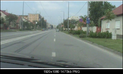

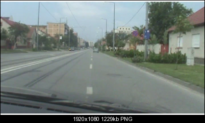

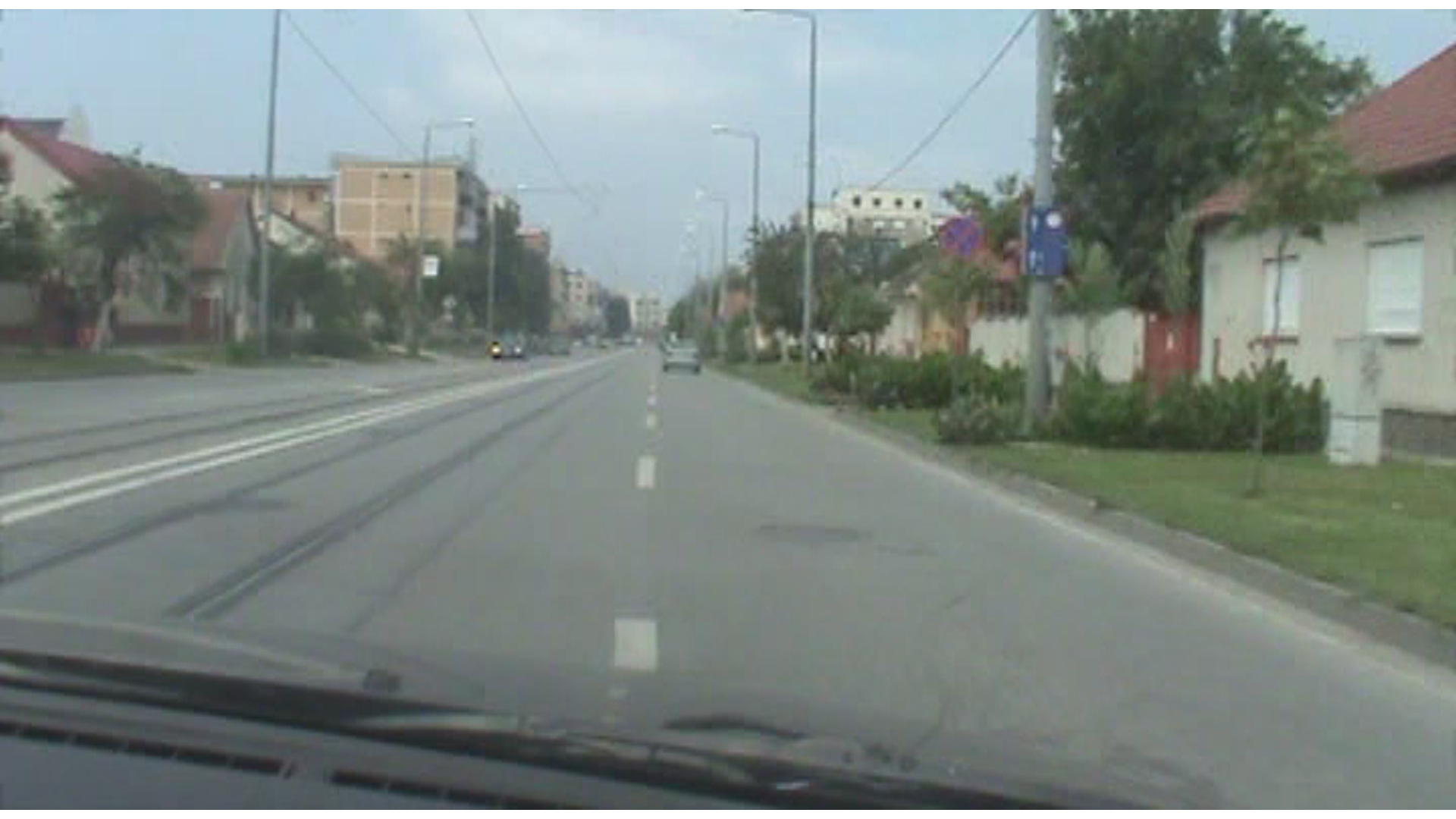

  3. Here you go, first is the original and second (newtest) is the export. They're both 58 seconds long since I had them done already before you asked me to, hope that's okay.
    Oct 2005
    666th portal
    it's just your video player adding borders. here are png's of the actual video.Click image for larger version

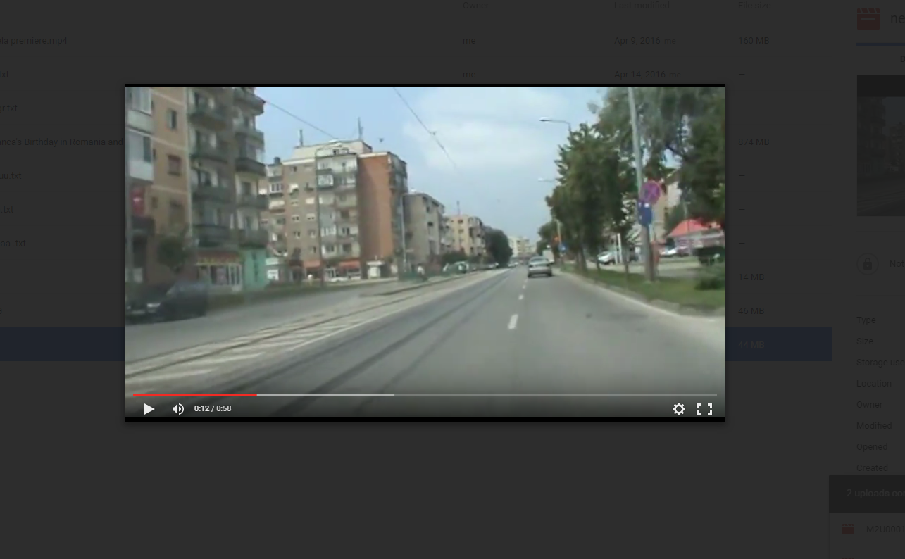

  5. It is not, I just tried them both in VLC and in WMP and every time the original would fill up the whole screen and every time the export would give me the two black borders. In both video players. If that was even the case that still doesn't answer why the borders "get added by the video player" when it doesn't do that to the original, I'm trying to stop them from appearing, everywhere.

  7. Originally Posted by CZbwoi View Post
    It is not...
    Yes, it is. Your original is 16:9 (1.78:1). Your export has a slightly different aspect ratio of 109:60 (1.82:1). Your 16:9 players are adding the bars.
    Edit: vaporeon800 beat me to it. But I have the pictures to prove it!

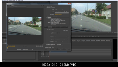

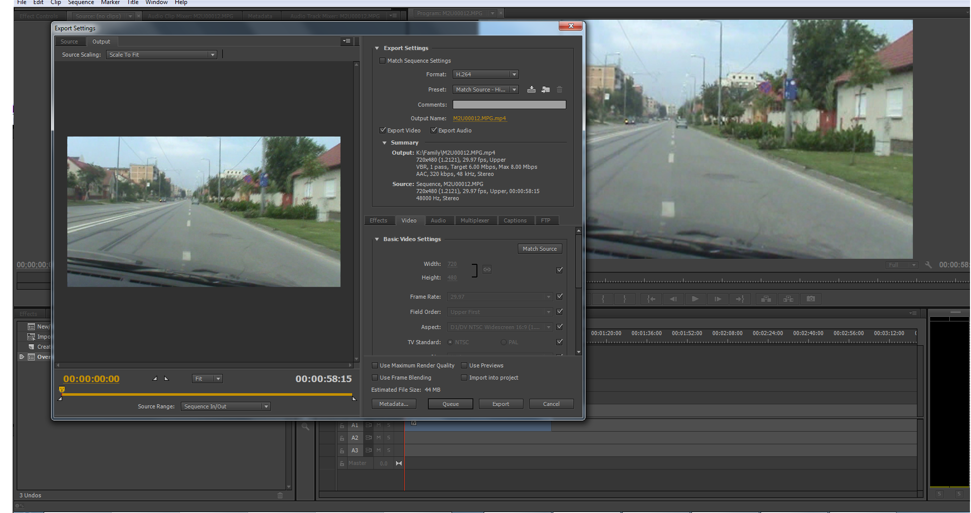

  9. Even if I selected match source and others as the presets this was always the case, this is odd. How exactly do I edit the files to make it be 16:9? Or do I have to change something before the export and do them all again? I see no option in Premiere that mentions it's changing to 109:60.

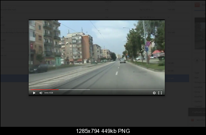

  10. Or if you believe VLC, the Resolution is 720x482 and the Display Resolution is 720x480. Huh?
    So I take it you're as baffled as I am?
    And to solidify my worries that it's not just happening in my video players, they play on Google Drive (where they'll all be for everyone) with Google's YouTube player the same way, original has no borders and the exports do.

  12. The short explanation is there are slightly different aspect ratio interpretations. PP uses ITU aspect ratio interpretation
    It assumes that NTSC 720x480 16:9 uses a pixel aspect ratio of ~1.2121 (or 40:33) which is slightly wider instead of non ITU aspect ratio interpretation which uses ~1.1852 (or 32:27)
  13. I'm getting the same strange results exporting from Premiere. Trying Adobe Media Encoder now to see if anything changes.
    Phew, I'm not alone. Tried it in Encoder as well and no difference, same thing. Even if there was a difference it wouldn't matter because the only reason why I'm inserting multiple clips into Premiere is to combine and cut stuff out before creating the single video.
    So...how do I change this to the right one? Is there a way to select the original aspect ratio? The answer can't be "don't use Premiere Pro", I think this program is more advanced than this little bug it has. I mean I'm even selecting match source over here and everything else under the sun. :/

  17. Within PP the best you're going to do with an h.264 output is 854x480 square pixels.
    For editing, set your project to match your source -- 720x480 widescreen

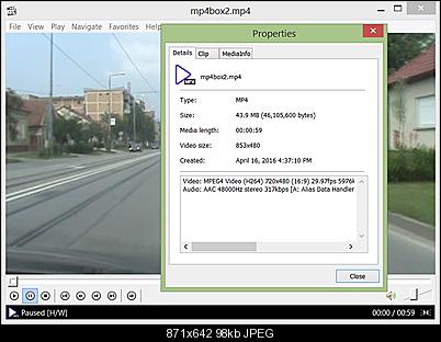

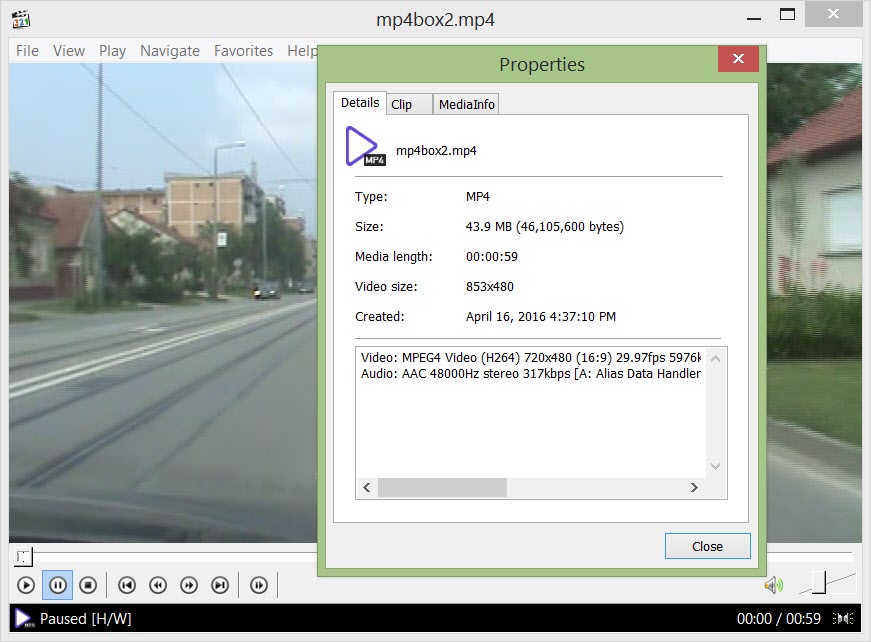

  18. mp4box works fine to patch the AR on your files. It's not re-encoding (not losing extra quality), it's just re-wrapping the audio / video, it's very fast, basically you're limited by your storage transfer I/O . So you should be able to batch process say a folder of mp4's that you exported with AME/PP with a mp4 batch script
    MP4Box.exe -par 1=32:27 -add "newtest.mp4#1:fps=29.970" -add "newtest.mp4#2" "mp4box2.mp4"

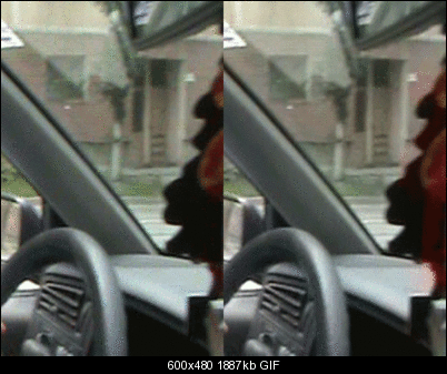

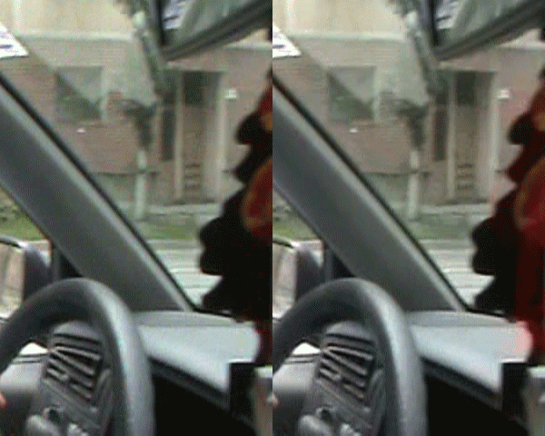

  19. How did you create "newtest.mp4" ? Because the chroma is messed up. It looks like the chroma was mistreated as progressive instead of interlaced at one point, this results in "chroma ghosting" artifacts
    Here is a gif illustration, cropped and simple bob deinterlace, slowed down. Left is original mpeg2, right is your "newtest.mp4"
    Inserting it into Premiere Pro and exporting it with match source to H264 and either the default bitrate of 6 or I dropped it down to 5. I'm gonna say it was the default of 6.
    But thank you for noticing that, you have some good eyes, what do you suggest that I do? And if Premiere's giving me all this trouble is there another program I should use to join clips together and cut stuff out of, one that won't give me these aspect problems and this chroma problem? Idk, does Vegas or Avid not have this ratio problem?

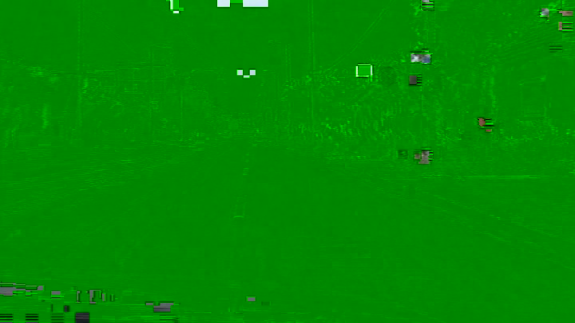

    Would you also think it's best to convert to another filetype for the long run as mpeg2 is outdated? They'll be on Google Drive ultimately. Why I'm saying is that a weird thing happens when you open up these .MPG files in VLC, it splats the screen with green artifacts for half a second upon opening up. In WMP it doesn't do this, only in VLC. So idk, weird things like that are because it's MPG?

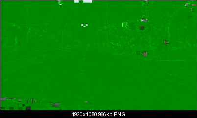

  26. So something weird is happening in VideoReDo. I dragged the 12 files that are gonna be joined together and the final time in the program says that it is 7:55.16 long, when in actuality it should be 26:24 long. I press play in the program and after the first video ends it fast-forwards like through 2 or 3 videos before stopping, like someone presses a FF button. What?
    The program I recorded the screen with exported it as .flv, hope that's okay.

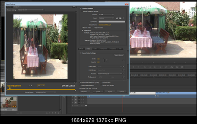

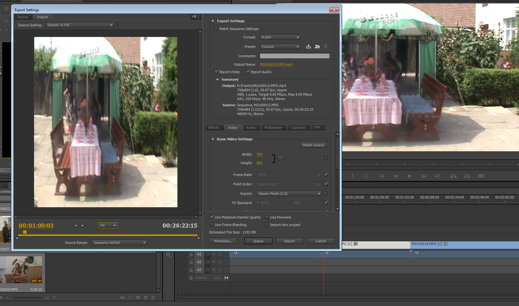

  27. (Responding to question at top of post #20)
    Export like you did in your image in post #9, but unclick the check mark next to the dimensions and change them to 854 and 480.
    Then unclick next to the Aspect drop down and change it to square pixels.
    Choose stretch to fill instead of scale to fill at the upper right.
    The easiest way to make sure your timesline matches your clip is to drag your first clip onto the new item icon at the bottom of the project window.
    (edit: 480 was incorrectly typed as 720 originally. Thanks pdr.)

    Export like you did in your image in post #9, but unclick the check mark next to the dimensions and change them to 854 and 720.
    Uh...like this? Are you sure?
