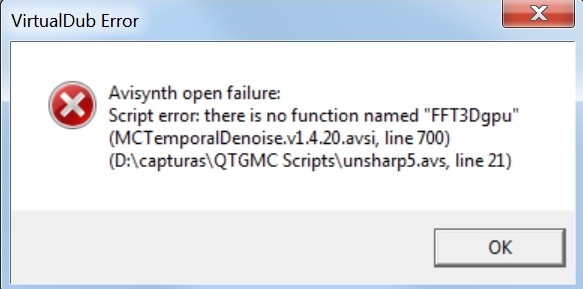

    Related to MCTD is it possible to use also the GPU ? if possible it could speed up the script, I tried gpu=true and even if I have the FFT3Dgpu in the plugin folder it gave me this error
Name:	avisynth error.jpg
  10. Originally Posted by FLP437 View Post
    Do you have the FFTW3.DLL where it's supposed to be? Depends on the operating system. In my 32bit Win7 it's in the System32 folder.

    Well, theoretically yes . I have a windows 7 , 64 bits so it is on the C:\Windows\SysWOW64
    However the error says no function name FFT3Dgpu it seems related to a not identified function on the script , but itīs strange as gpu is one standard variable ( by default is false but can be true ) and the script with the gpu=false works fine
    If you're using QTGMC in your script, why not have it use one of its denoisers? DFTTest is very good.
    I have made preliminary tests with EZdenoise and Neat video (external filter) and both work also fine I only need more in depth tests to decide which one to retain between MCTD, QTGMC denoisers and Neat Video, I have not tried yet DFTTest I will include it in my tests also.
  12. Oh, GPU=False works okay? Then you're sure you have a compatible video card? Not every card works.
