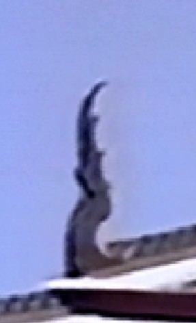

    • There is some sort of ghost or color bleeding I don’t know for sure ( see detail image) that in some way prevent the image to look sharper .In the event that this is indeed color shift I included an additional line to try to prevent the situation .It seems to have improved a little, but I don´t know if it´s due to this probably not

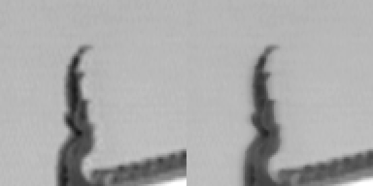

    The image shows two problems: oversharpening halos and color bleeding.
    Consumer video tape formats are all low resolution horizontally so most players include a sharpener. Those usually cause overshoot. On a transition from dark to bright there are bands of over dark on the dark side, over bright on the bright side. The oversharpening isn't too bad on your video. But it's best to avoid this by turning off the sharpening filter in the playback deck. Or switching to a player that doesn't do it. If neither of those is an option you can reduce them (at the cost of losing a little detail and shaprness) with a dehalo filter like dehalo_alpha(). A 4x greyscale (to eliminate the color smear) enlargement, before and after dehalo_alpha(rx=4, ry=1):
    [Attachment 36703 - Click to enlarge]
    Consumer tape formats also have very very low color resolution, only about 40 lines across the width of the frame. That is the cause of the color smear.

    Related to the over sharpening halos and color bleeding I tried Colorshift and with a C value of about -4 the color bleeding is substantial reduced however I don’t know how to select the Luma value I tried several values but didn’t see any difference.
    I tried the dehalo_alpha() it works fine but picture detail suffers a little. I was thinking to try also exorcist to see if it will do anything but perhaps is not applicable for this problem.

  30. You're video doesn't really have any super blacks of significance but it does have super whites. A lot of your super whites are totally blown out so bringing them down doesn't really make any difference. It's only those superwhites that are between Y=235 and Y=255 where detail can be recovered. That can be hard to spot.
    Dehalo_alpha() has some controls that help keep more detail. BrightStr and DarkStr control how much bright halos are darkened and how much dark halos are brightened. LowSens and HighSens determine how pronounced the halos have to be before they're dehaloed -- something like that.
    ChromaShift only shifts the chroma around, it doesn't sharpen the chroma. For example, if you use ChromaShift(c=100) you'll see that all the colors move 100 pixels to the right. The "l" value in ChromaShift() isn't the luma it's the number of lines up or down to shift the chroma. So ChromaShift(l=100) will move the chroma 100 pixels down.
    With your Hi8/video8 deck try the sharpness all the way down or in the middle. Either of those could be neutral. The detail that that sharpness filter adds is not real. You can do better in AviSynth. Ie, you can sharpen without creating halos.
