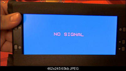

    black tape on the viewscreen at the appropriate size. film only inside the tape. crop while rendering to your output.

    i wasn't joking.Click image for larger version

    added lenses will only make crappy video. use the part of the original sensor that's 2.39/1. any other way will result in blurry/unusable video. "near normal focus" is not good.
