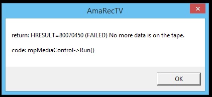

    I've been using AmarecTV 2.31 for capturing VHS tapes from my VCR with a PINNACLE PCI VIDEO CAPTURE CARD / FIREWIRE 1394 IEEE / 51015777 / BENDINO V1.0A
    My only problem was the audio being always ahead of the video by anywhere from 0.5 to 3 or 4 seconds.
    I found version 3.1 and installed it hoping that the problem was resolved. However, now I'm getting this error when I exit the configuration.
    It says "No more data is on the tape" but the tape is at the beginning.
    See also attached ini files for version 3.1 (current) and my ini file when I was using version 2.31 (was working fine). They need to be renamed "AmaRecTV.ini" and placed in the installation folder if anybody wants to test them).
    Has anybody experienced this ?

    I don't get why AmaRecTV would ever say anything about a tape, unless you were using Firewire controls.

  5. Originally Posted by vaporeon800 View Post
    I have rebooted and the problem is gone (duh ..).
    However the audio sync problem remains.
