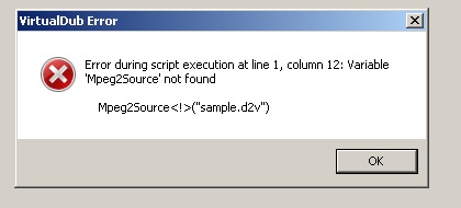

    I have VirtualDub 1.10.4 (portable) with the mpeg2 plugin. It plays mpg and vob no problem. However, the command File/Run Script gives me a blank box until I change 'All scripts' to 'All Files'. Then, when I click myscript, I get the error shown attached. Any idea why?

Name:	vdub error.jpg

    I opened Notepad, typed “Mpeg2Source("sample.d2v")” and called it myscript.avs. Is that effectively the same script as you created?
    That might work. You already have the DGDecode.dll, right? Open the script in VDub and if there's an error message, give us the complete script and what the error message says. Make sure you open your AVS scripts with File->Open Video File.
    File -> Run Script is for VirtualDub scripts, not AviSynth scripts. An AviSynth script is a video file to VirtualDub. So use File -> Open Video File to open AviSynth scripts.

    Presumably you mean I should have DGDecode.dll within Vdub? I didn't but now I do. Also, after something I read, I've replaced 64bit Vdub with 32bit. After twigging that I had to include a proper file path in the script, I can now open a d2v with Vdub.
