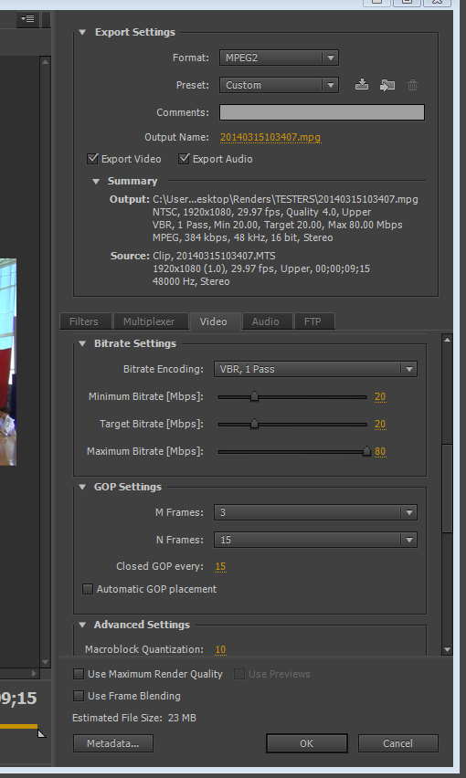

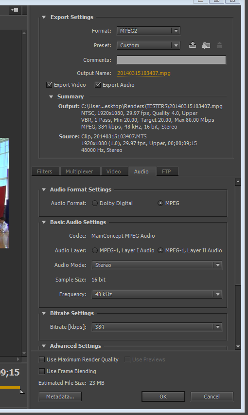

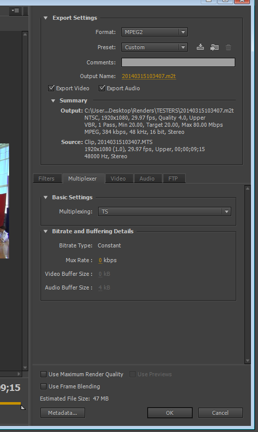

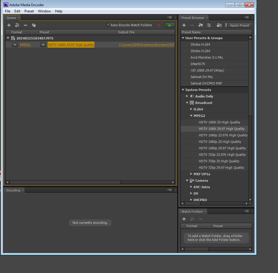

  6. In Adobe media encoder selct the mpeg2 preset that best matches your requirements.
    Drag it onto the title of your file in the queue.
    Then click on the preset in your queue to access the customizable video, audio and multiplexer tabs.
    Once you create a preset you like you can save it as a user preset.
    https://helpx.adobe.com/media-encoder/using/export-settings-reference.html#exportsetti...logboxoverview
    [Attachment 36542 - Click to enlarge]
    [Attachment 36541 - Click to enlarge]
    [Attachment 36543 - Click to enlarge]

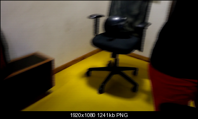

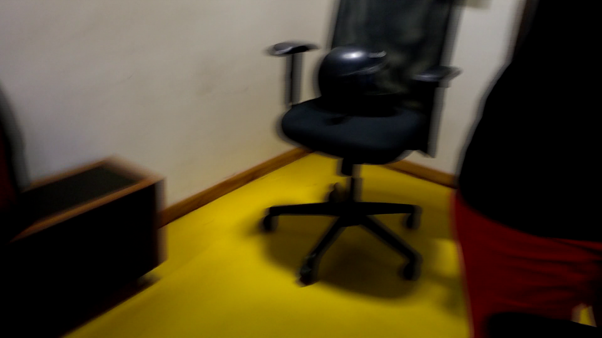

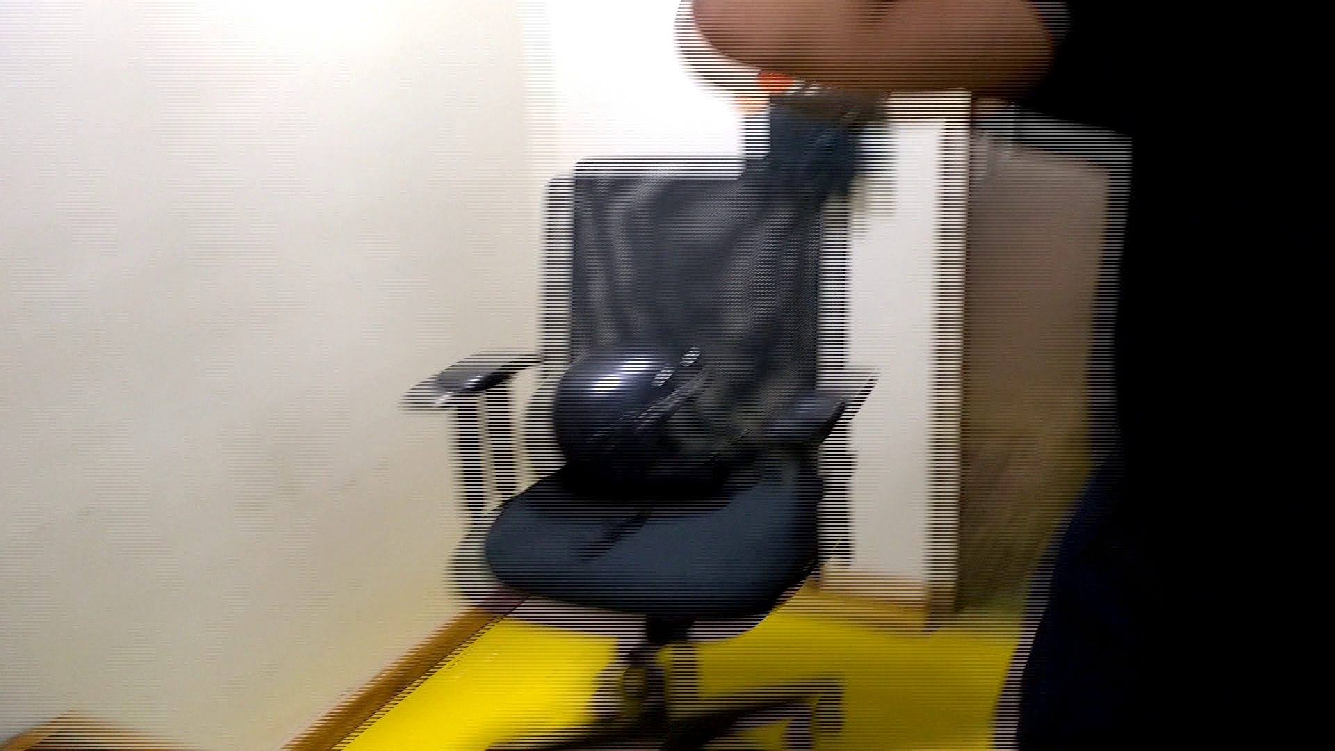

    and after render I found something like this.Click image for larger version
ID:	36545Click image for larger version
  8. You can manually set the closed GOP duration under the video tab (see previously posted image.)
    The other issue is blended frames from either changing the frame rate rate or improper deinterlacing. The best solution depends on correct diagnosis of the problem. Adobe is not particularly good at handling either one.

  10. Originally Posted by maxfan View Post
    for closed GOP I have to set 0 in Closed GOP every option.Right?
    No, you set it to the duration (or a multiple) of your GOPs. In the example image above, 15.
