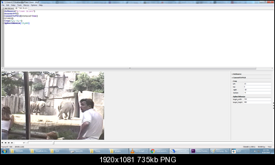

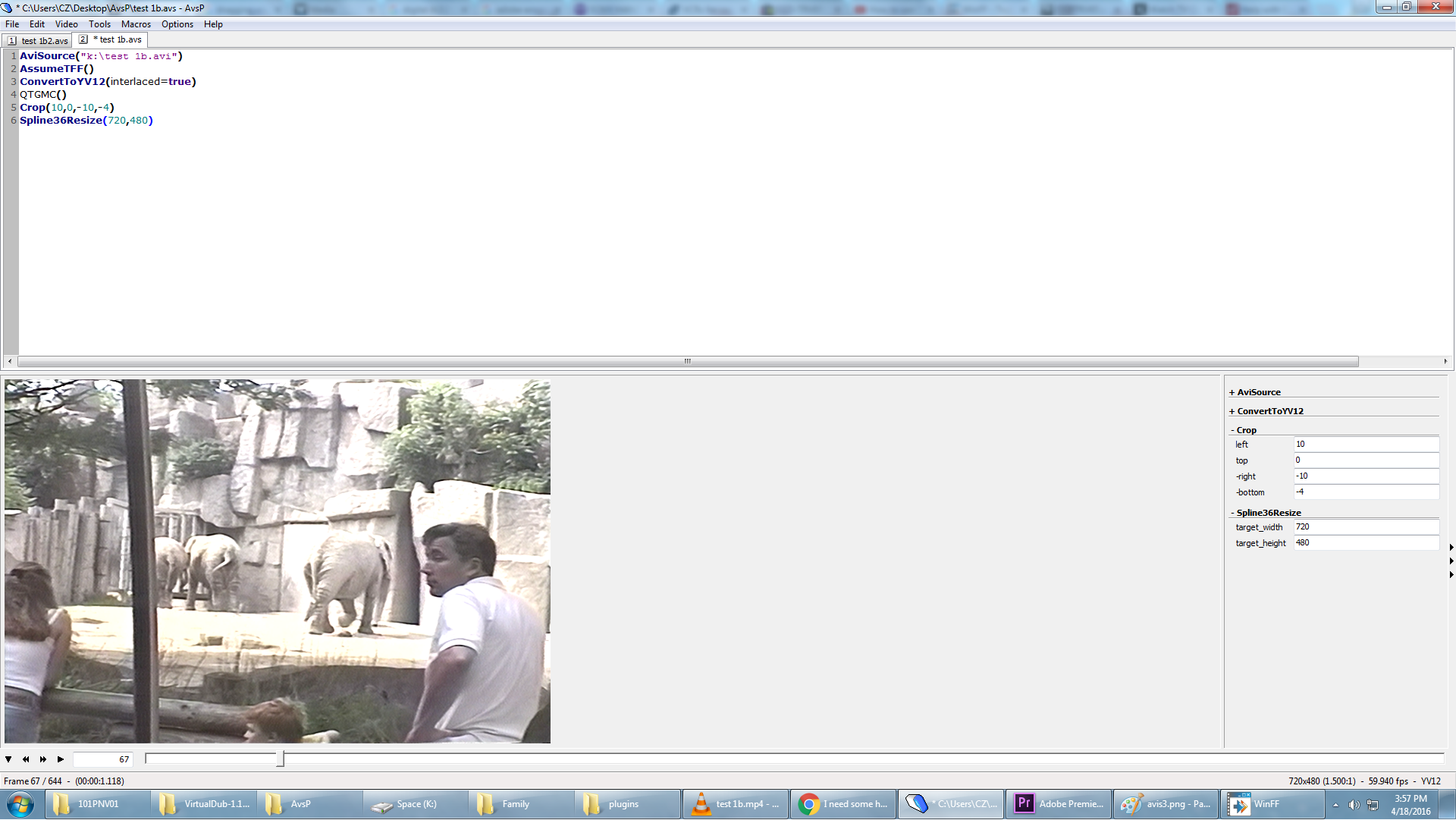

    Ok, so I attempted to use the resize script because I realized that if I cut off borders, I'd get a different size than the original 720x480. So I added that size into the settings:
    And the result seems wider (?) than the original unless I'm seeing things? Am I resizing it wrong after the cropping, how do I make it exact (should I be resizing)?
    The file is attached. Btw I used this guy's method of turning the script into MP4 using his preset and WinFF. Would you say this way is okay or not as good as your x264 route?
  4. You didn't account for the sample aspect ratio or display aspect ratio when you encoded. That's why your picture is too wide. You should set the SAR (x264 setting) to 10:11 or the DAR (container setting) to 4:3.
  5. You didn't account for the sample aspect ratio or display aspect ratio when you encoded. That's why your picture is too wide. You should set the SAR to 10:11 or the DAR to 4:3.

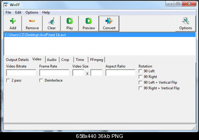

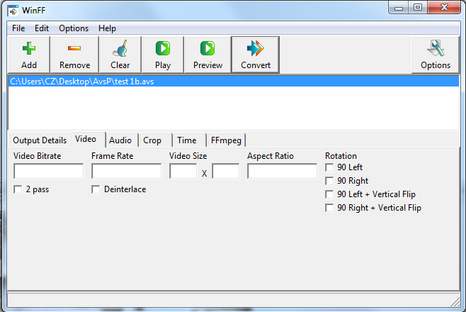

    I don't see that option in avisynth, so inside of WinFF?
    Anywhere to do it in here? I don't see any part stating SAR or DAR.
  6. As I said, it's an encoder or muxer settings. I'm not familiar with WinFF. You'll have to look for a guide that tells you the format to use.

    Here is what I did last night before going to bed:
    avisource("test elgato 4.avi")
    Spline36Resize(640,480)
    AssumeTFF()
    ColorYUV(cont_u=47, cont_v=118)
    ConvertToYV12(interlaced=true)
    QTGMC()
    Sharpen(0.21, 0.0)
    Crop(6,4,-6,-6)
    So, I resized it first to 640x480. Then at the end is when I implemented some cropping, 6 off the left, right and bottom, and 4 off the top. Does it matter if a part of it is not equal, does it affect playback on anything? 4 off the top is all I needed, but in turn I needed 6 off the bottom...does this mess with anything since it's not equal?
    Okay, so now my exported file (through WinFF, where I changed no aspect settings or anything) is 628x470 (attached file). Is this a bad ratio to stay at since it's uneven due to the 4 at the top vs. the 6 at the bottom like I said? Would it screw up playback on a device, TV, DVD/Blu-ray player?
    Or when I'm done with the cropping in that code I posted, should I cap it off with another resize to 640x480 in AvsP? Would that make things worse since I'd be "stretching the pixels or picture" once again but this time from a smaller state of 628x470?

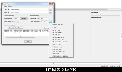

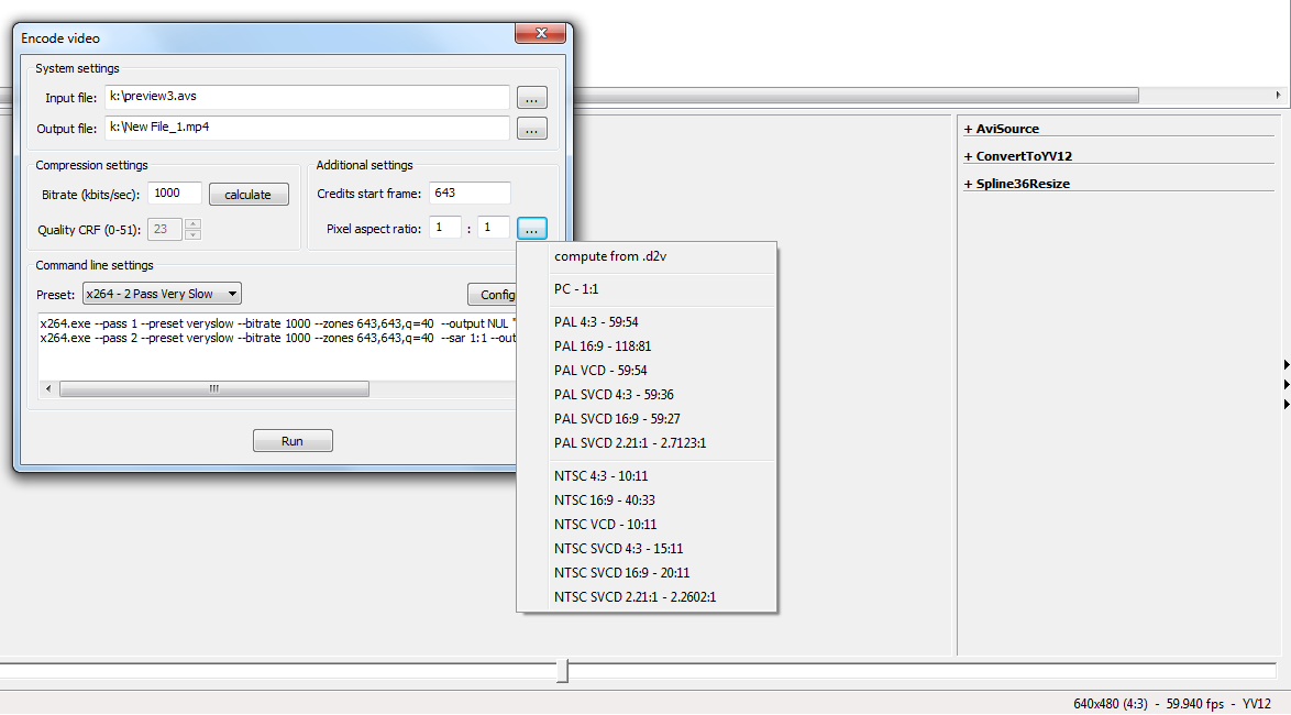

    Also I just learned how to encode it out into x264 inside of AvsPmod, and I see these options:
    I think this is what you were talking about. Say that I crop it out to a weird size again, 706x480, all I would have to do for it to turn into the correct aspect ratio and turn it into 640x480 is select NTSC 4:3 - 10:11? No matter what it will change it's aspect ratio to 640x480 and nothing else? And what's the difference between that one and NTSC VCD - 10:11, should I ever use the latter?
    [Attachment 36679 - Click to enlarge]
    That's the idea. No matter how much you crop, setting the PAR to 10:11 will cause the player to display the remaining picture with the right aspect ratio. But that's not necessarily a 4:3 frame. For example if you cropped down to 352x480 the picture will display with 2:3 frame but the aspect ratio of objects within that frame will be drawn with the proper aspect ratio. Eg, a circle will still be a circle, a square still a square.
