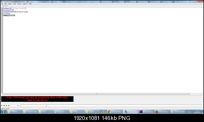

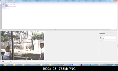

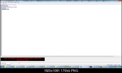

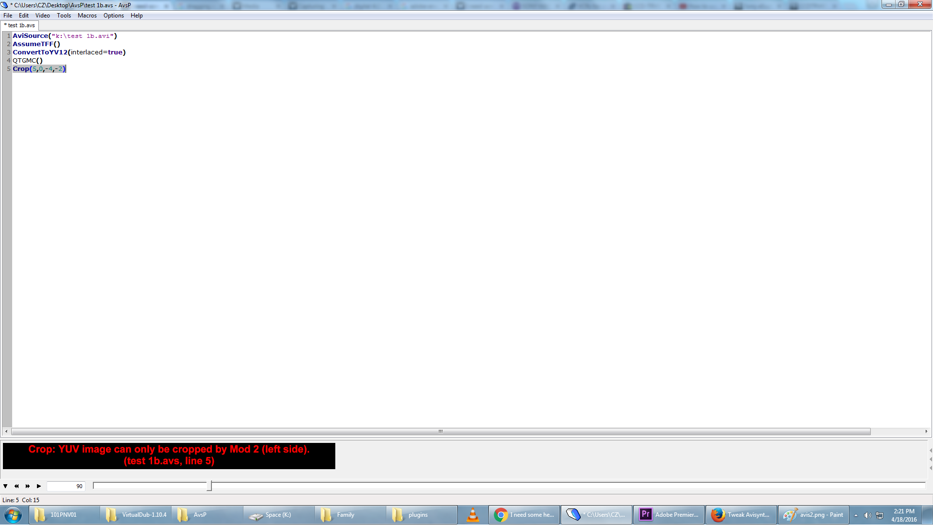

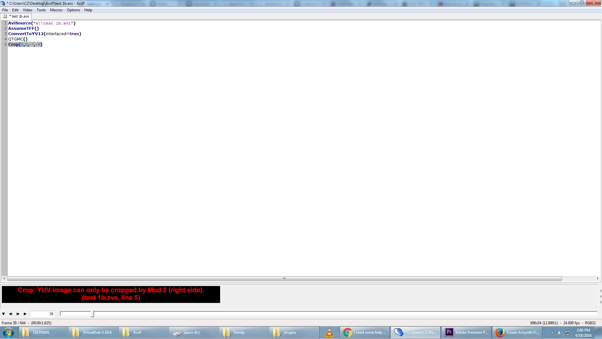

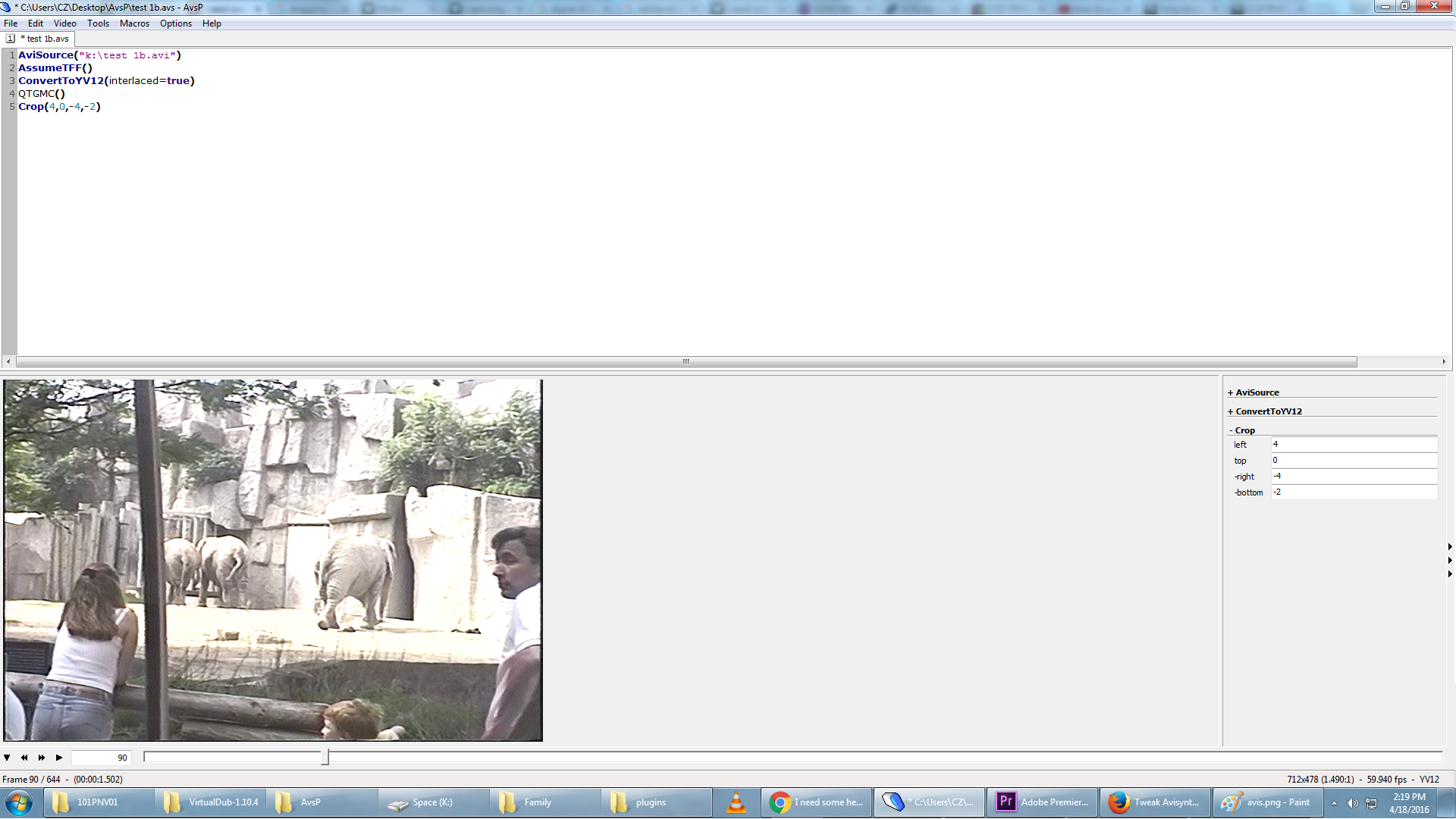

  29. Okay, so bear with me here please.
    I'm trying to insert some of your stuff from the first video clip you made and those codes into test 1b to try it out for myself but with the 2nd clip (where you barely did anything). I inserted the cropping line of yours and it cropped something, maybe too much I don't know, it was meant for the first clip you did. But every time I try to change one of the dimensions I get this error:
    But now as it appeared that I finally got the hang of it, I'm not able to erase the final bit of black border lines. Every time that I try to go a number up or down in the way it should to further continue the last bit of cropping I get the error:
    Does this mean it can be cropped in variables of 2 all the time? I.e. 2,4,6,8,10? Is that how all cropping is done in avisynth scripts, always by 2's?
    Also, could you explain how to use the x264.2692.x86.exe file I downloaded for that next step? How do I insert my script and original .avi into it? What exactly do I do and what did you mean by batch file? Basically, how do I turn it into x264 with this?
    *and are there other popular formats to turn it into when I have the completed avisynth script and other methods to do so when you have the avisynth script and original avi?
  30. Originally Posted by CZbwoi View Post
    You should familiarize yourself with the crop rules. To answer your question more directly, yes, progressive video in YUV has to be cropped by multiples of 2. And it's not just AviSynth.
