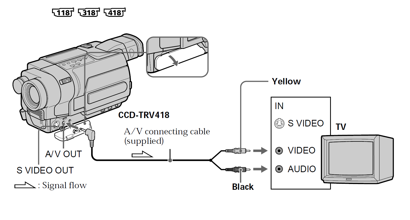

  9. All you need to do for the audio is get a Y adapter so you can plug the single audio line from the player into both the left and right audio inputs of the capture device.
    https://www.radioshack.com/products/radioshack-y-adapter-phono-plug-to-rca-jacks?variant=5717464773
    http://www.amazon.com/RCA-AH201-Y-Adaptor-Cable/dp/B00005T3G4/

    Unfortunately both of your camcorders are monaural, So if the tapes were recorded on them that's fine, if the tapes were recorded in stereo on other stereophonic camcorders and you want stereo capture you cannot use those camcorders, If you are ok with mono than like Jabago said just get an audio splitter cable.

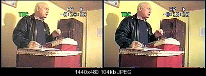

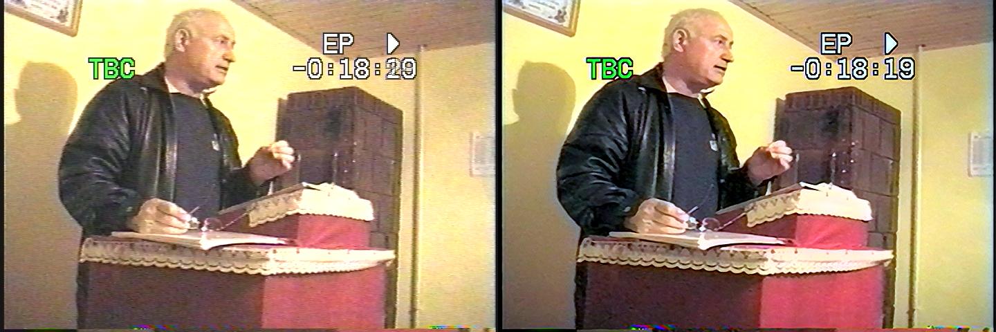

  26. Originally Posted by CZbwoi View Post
    When I was just playing them today it was on my LCD flatscreen. It looked good, as it does on the camcorder's little screen. And now I'm seeing that even Elgato in VirtualDub looks nowhere near as good, smooth, clear and crisp as on those 2 screens. So alas, I want to buy the best possible capture card, device, whatever now so I can get that same exact quality my camcorder shows plugged into my TV. What do I buy?
    For consumer video tape there's very little difference in picture quality between a middling $40 capture device and $1000 studio capture devices. The differences you are seeing are due to the way TVs process the analog signals they receive. They pump up the contrast and saturation, and apply sharpening and noise filters.
    The job of the capture device is to get a picture as close to what's on the tape as possible. You then apply whatever processing you want. Your original cap and a highly (over) processed image on the right:

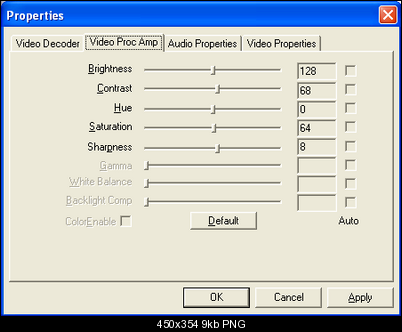

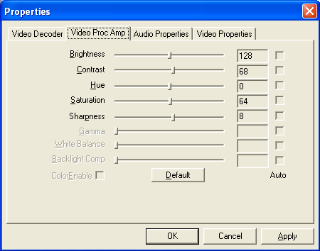

  29. In your samples, the black and white level are too high. That is causing the washed out look. You should start by adjusting the capture device's video proc amp to get decent levels, saturation, and hue. You should be able to find them in VirtualDub's capture module's Video menu. Look under Capture Filter, Crossbar, Levels, etc. You'll get a dialog that looks something like:
    Some capture devices also let you adjust sharpness, gamma, etc. Sharpness should be set to a neutral value -- it will just increase noise with low res tape sources. You should also disable sharpening filters and auto contrast etc. filters in the capture device and the VHS deck. All those will do is screw up the video before your capture it.
  30. In your samples, the black and white level are too high. That is causing the washed out look. You should start by adjusting the capture device's video proc amp to get decent levels, saturation, and hue. You should be able to find them in VirtualDub's capture module's Video menu. Look under Capture Filter, Crossbar, Levels, etc.
    I'm doing so right now for the last 15min and I can't get anything to work, colors simply aren't matching. Blues are a light purple, then they turn to bright white in some settings, greens aren't bright or alive, I'm trying everything here. It also doesn't help that whenever I enter this proc amp settings my video capture that's playing and that I would rely on to see a live preview of what I'm changing, disappears.
    And once again it looks like there's frames dropped or something, it's not as smooth as on the camcorder and TV at all. Edges of even faces are jaggy and noisy, and now I'm noticing lines breaking in vertically occasionally, like a mirrored sword slash for half a second.
    It's grayed out for me :/
    Not even using a VHS deck yet, that's after these smaller tapes, but there are no settings like that on the camcorder which I'm using. Also when I was playing them on the TV I turned all those things off on there and the video still played as well as it does on the camcorder's screen, vibrant and smooth. I simply need advice on something better to buy than this Elgato thing, a capture card that's good for my computer and I'm a n00b in that field.
