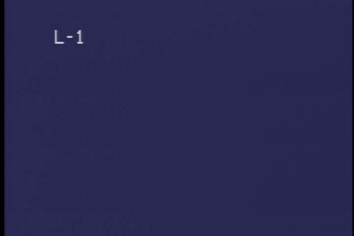

No, your capture device's drivers should have a YUY2 (or other YUV) option. All capture devices capture as YUV (the native form of analog video). Conversion happens when you specify RGB -- ie the device captures as YUV and the driver converts to RGB. That conversion to RGB has crushed all your blacks.
And see if you can adjust the capture device's video proc amp to bring the black level up. -
I can't seem to find anything in the manual to do this, or It's really complicated. I will have to do this in post.And see if you can adjust the capture device's video proc amp to bring the black level up.
The proc amp is in the capture filter, capture pin, or crossbar filters. Just go through the different items in VirtualDub's Video menu.

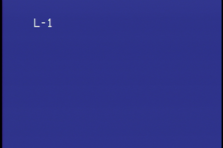

Yes, I have to play around with the brightness and contrast a little. Here's the blue screen I'm getting off the TBC, and the one below is directly from VCR.
