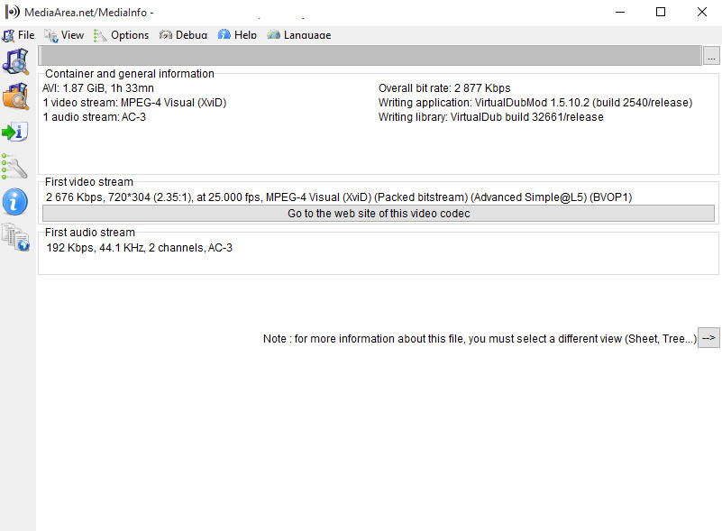

    this is the movie video and audio
    I just need a very simple program or programs to do this so video is much louder
