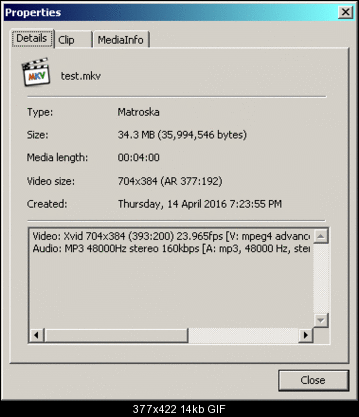

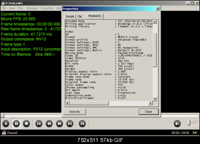

    Having said that, MediaInfo made a liar out of me first go.... partly at least. I took an AVI I had handy, remuxed it as an MKV, setting 393:200 for the aspect ratio and changing the frame rate from 25fps to 23.965fps. MediaInfo displayed the aspect ratio fairly accurately, but not the frame rate.
    MPC-HC has a MediaInfo tab and displays the same info as MediaInfo's GUI would, but MPC-HC's File/Properties menu doesn't always agree, so for checking frame rates and aspect ratios accurately, I've developed the habit of using MPC-HC's File/Properties menu.

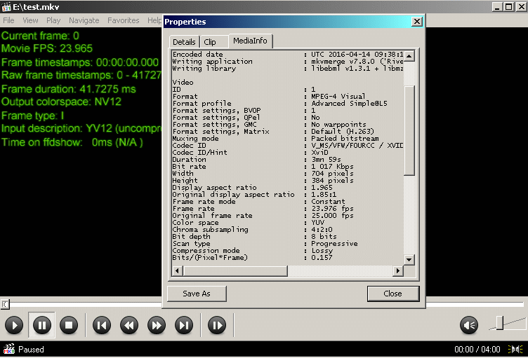

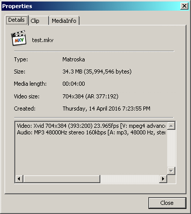

Name:	frame rate 1.gif

Name:	frame rate 2.gif
    In this case both aspect ratios are pretty close but 1.966 would have been more accurate for the aspect ratio and 1.833 more accurate for the "original aspect ratio", so that's where my "rounding" theory originates. I've never tried to work out if there's rules for how much or when it'll be out, as I just use MPC-HC instead. If I can find an example where the aspect ratio is very inaccurate I'll report back.
    When I opened the MKV in question with MeGUI it reported the aspect ratio as 785:384, which is accurate to the nearest whole pixel, but unfortunately it went with 23.976 for the frame rate too. I don't know if it obtains both from MediaInfo for MKVs.

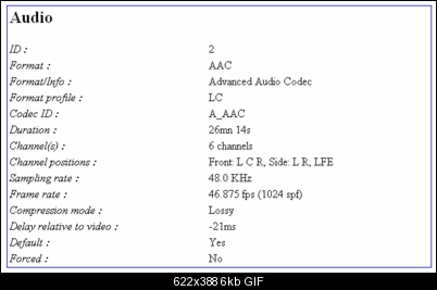

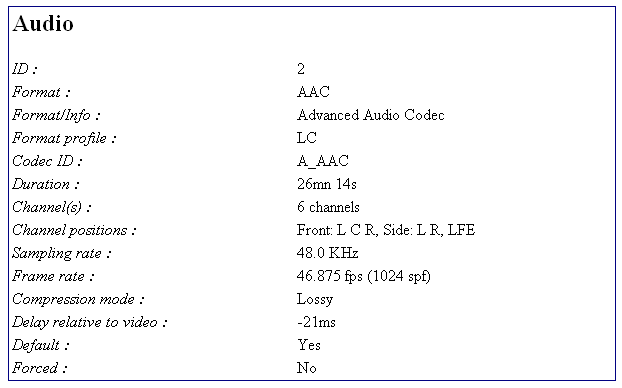

    While we're here, can I ask how audio delays are saved to MP4? I'll probably have to try to make an MP4 with an audio delay if you want a sample as I've got very few of them, but I do have a fairly large MP4 on my hard drive and as I remuxed it recently it was fresh in my mind. When I open the MP4 with MediaInfo, it looks like this:

    I'm not saying the audio delay reported for the MKV is wrong, in fact I'm confident it isn't, but I've noticed that happen enough to wonder why the original MP4 doesn't seem to have the same audio delay.
    Edit: gMKVExtractGUI indicates the audio doesn't have a delay, which I should have realised as it's a negative value, but there is a positive 21ms video delay applied to the MKV, so I guess the same question does apply.

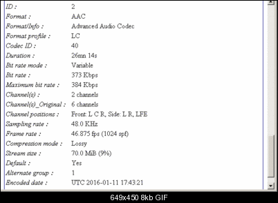

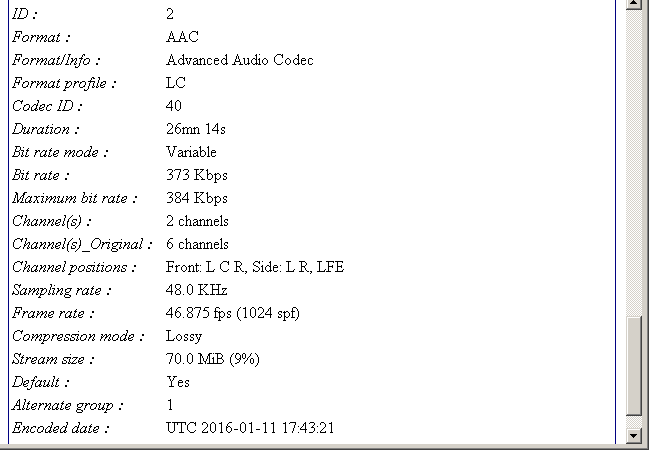

    PS Another question (sorry about sidetracking the thread) why does MediaInfo display 5.1ch as Front: L C R, Side: L R, LFE for all the usual formats except Opus, for which it displays Front: L C R, Rear: L R, LFE? I understand the surround channels could be interpreted as either side or rear, and I understand why you went with side (I read the old doom9 thread) but I was just wondering if Opus is interpreted differently for a reason.
    There's also a few 5.1ch types MediaInfo gets wrong, if you're interested.
    5.1ch ALAC in M4A encoded by ffmpeg is displayed as 6ch, but when created by QAAC, MediaInfo gets it right.
    5.1ch Ogg and WMA 10 encoded by WMAEncode.exe are both also identified only as 6ch.

    DAR = FAR * PAR
    DAR = display aspect ratio
    FAR = frame size aspect ratio
    PAR = pixel aspect ratio
    I'm also curious regarding my posts #14 and #15 and why the same media player (MPC-HC) would change it's mind about the aspect ratio according to the splitter or decoder being used? Is the splitter responsible for interpreting the aspect ratio information, or passing it along correctly etc?
    Yes, each filter along the way must pass on AR information.
  28. Thanks, although when I said I didn't understand how the aspect ratio was calculated, I just meant I didn't understand where the pixel aspect ratio was coming from.
    Maybe the developers of software players don't think it's worth teaching them to read mpeg1 PARs properly because it's not all that common now, and so they assume the standard mpeg PARs instead?
    Whatever the reason, it seems MediaInfo was getting it right.
  29. Originally Posted by hello_hello View Post
    With analog video capture they come from the ITU.601 spec (AKA BT.601). With DVDs you aren't given a pixel aspect ratio, only the frame size and the display aspect ratio. Officially, you derive the pixel aspect ratio with PAR = DAR / FAR. The problem is that DVDs made from analog video tapes are usually captured via the 601 spec and written directly to DVD, ignoring the ~2 percent difference between the two specs. So some software assumes DVD PAR, some ITU PAR.
