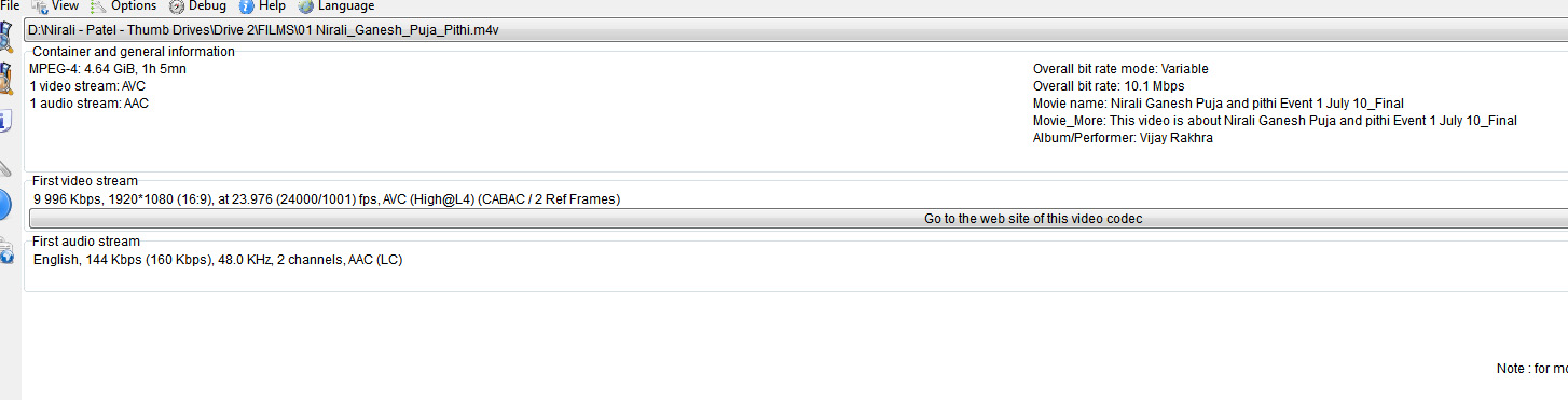

    I have a few different MP4 files that were given to me by a friend to create a bluray, sure, easy enough I thought.....Oh I was wrong. I didn't originally realize that the files were PAL HD 1920x1080 23fps. I am using Premiere Pro 5 and Adobe Enocre, but I'm running into major syncing issues with audio and video. My workflow is creating a new Adobe Premiere project, but when doing this I notice that I only have options for frame rates for PAL of 25 or 23.976, not 23 like the file says it is. I've tried test clips with both frame rate sequences, but when I test the file in Encore they audio and video never match up. I have a good amount of knowledge with SD NTSC, but not that much knowledge with PAL HD. My goal is to put these video files onto BluRay discs that are region free. Thanks in advance.
    Mediainfo says 23.976fps?

    My fault, media info does say 23.976
    And did it work better if you choosed 23.976 in premiere? or still sync issues?

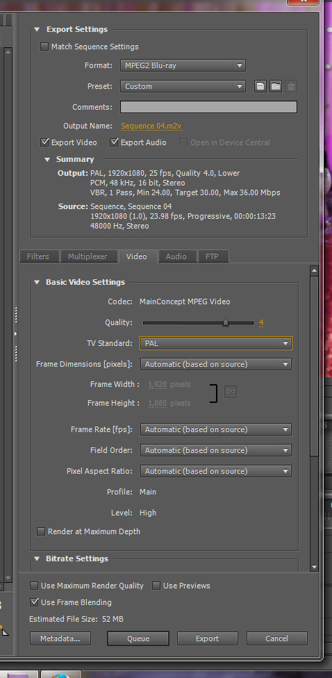

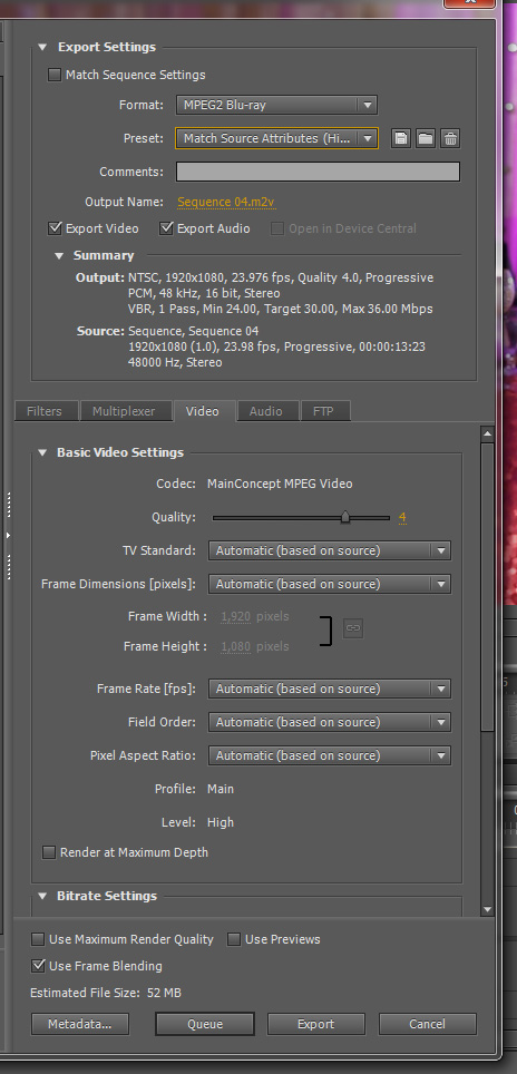

    I changed the sequence settings to match the frame rate of the clip and I'm still getting the same issue. I've attached screen shots of the two different output settings that I've used for Adobe Media Encoder. I'm then using the M2V files to import into Encore and burn. The one issue in Encore that I notice, when choosing PAL or NTSC, the PAL option only gives me a frame rate of 25, not 23.976? I exported small clips choosing various options but haven't even made a little bit of progress unfortunately.
