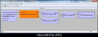

    In my opinion, Catalyst Media Center isn't fully compatible with Windows 7. I could install Catalyst Media Center, and it would work for a while using Vista compatibility mode, but eventually it would stop working. I could install Catalyst Media Center again, and it would work for a while using Vista compatibility mode, but eventually it would stop working again. After the third time around, I gave up.

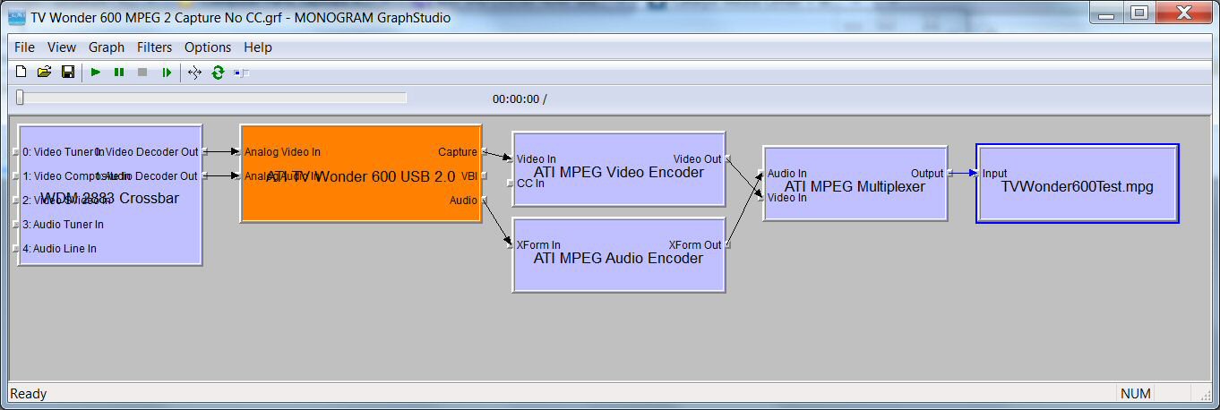

    I have an ATI TV Wonder 600 HD USB. I have read that the software encoder doesn't encode PAL video, but I cannot verify it. I have no devices which are capable of generating a PAL video signal to record. If you know how to build a build a filter graph in GraphStudio, you can try capturing from a PAL video source without using Catalyst Media Center.

    Graph Studio is a program that allows building capture graphs from components provided with a capture device's drivers, and by the operating system, various other software, plus some encoders. Capture software does the same thing internally. These graphs are for capturing using MPEG-2. You would use different encoders and different muxers and file writers for other video formats and container files.
    Here is a general description of how you might proceed using GraphStudio:
    The graph is built from left to right by adding filters and dragging an dropping with a mouse to connect "pins" (little nubs on the filter box) to build the graph.
    One adds filters by clicking clicking "Graph" on the Menu Bar, then clicking "Insert Filters". This brings up the Filters window, and filters can be selected using the left-most dropdown list in the "Filters" window.
    The first filter in the graph is the crossbar filter for the capture device, found under "WDM Streaming Crossbar Device". The second filter, also for the capture device, is found under "WDM Streaming Capture Devices."
    The next two filters to add are the ATI MPEG Video Encoder and ATI MPEG Audio Encoder found under "DirectShow Filters".
    Next comes the ATI Multiplexer and the ATI File Writer. Look for them under "DirectShow Filters" too.
    The video and audio source are selected by right-clicking the Crossbar and clicking Properties. The video system is selected by right-clicking the WDM Capture filter and clicking Properties. The video and audio ncoder settings are accessible by right clicking the encoder filter box and selecting Properties.
    Choosing all the right filters and connecting them often requires some trial and error, as does configuring the settings for the filters themselves. GraphStudio can sometimes add a missing piece between filters to make a connection work.
    Once the graph is finished, and the options provided for the filters in the chain are set up, a user can click on the green arrow icon in the tool bar to start the capture. Clicking on the red square icon on the toolbar stops the capture.
