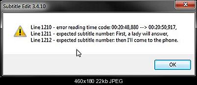

    SubtitleEdit says: Line 1210 - error reading time code: 00:20:48,880 --> 00:20:50,917,
    Seems to be an extra comma at the end of the line...

    My Subtitle edit got:
Name:	ScreenHunter_190 Apr. 09 00.31.jpg
    I removed extra comma and re-broke the line correctly in the next 2 errors and it tests ok

    The other 2 errors were because of the extra comma. Several subtitle editors and conversion programs do not like punctuation errors, lines ending in multiple spaces/commas, and the like.
