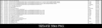

    I've tried using IDM, FFMPEG and LiveStreamer and end up with the 403 forbidden error. This is what I get from URLSnooper, but I'm not sure how to go from here. Any help is much appreciated.

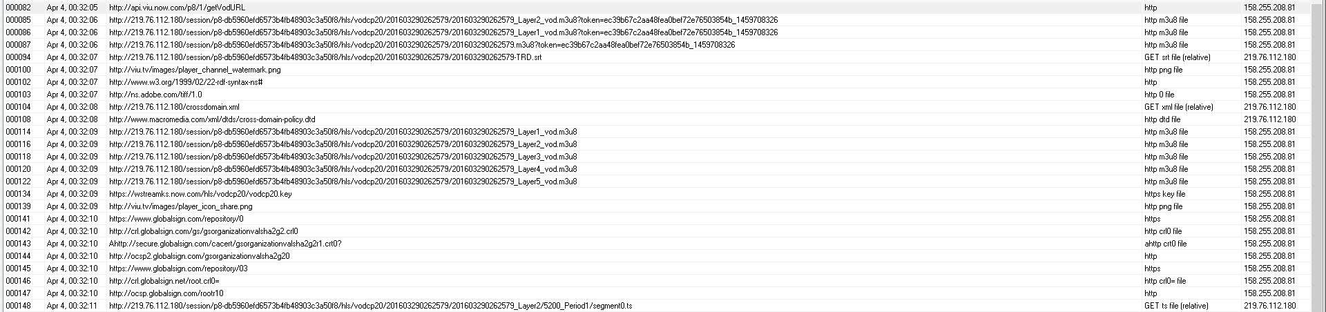

  2. The 403 forbidden error happens because your IP is not located in Hong Kong. I have success downloading many segments of the .TS and .AAC files but couldn't open them. I think it is DRM protected. Anyone else have success?
