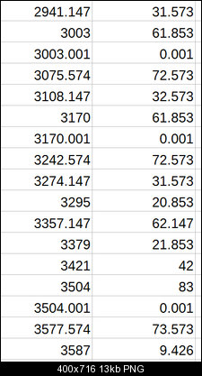

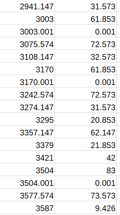

  6. The time codes in before.mp4 are screwed up. It will never play smoothly. If you step through the video frame by frame (ignoring the timecodes) you'll see there is smooth motion in the middle section. But if you step through the time codes in that panning shot you'll see they are displayed for random times ranging from 1 microsecond to 74 milliseconds.
    The left column is the raw timecodes in milliseconds. The right column is the delta from the previous timecode.
    [Attachment 36372 - Click to enlarge]
