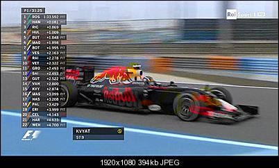

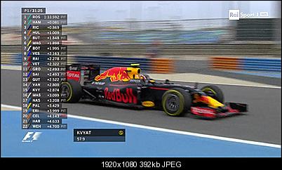

  1. Yesterday I recorded a Formula 1 video with my DVR, I edited with VideoReDo and deinterlaced with MeGUI using Yadif with Bob. For some reason, when there is a fast motion in the video half of the frames look good like this
Name:	160401_1722(Rai Sport 1 HD).ts_20160402_112732.921.jpg
    and the other half look sort of blurred, with the color fading like this.
Name:	160401_1722(Rai Sport 1 HD).ts_20160402_112743.750.jpg
    Is there a way to fix this?

  6. You should upload the original, to determine if the problem exists when recording, or if it was something done by videoredo, or megui
    But looking at the screenshots it looks the the chroma wasn't handled correctly .

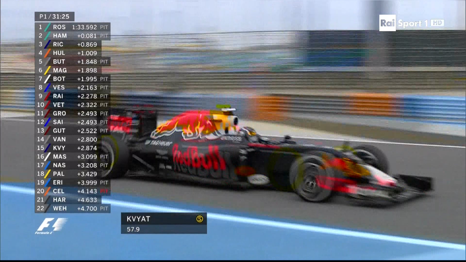

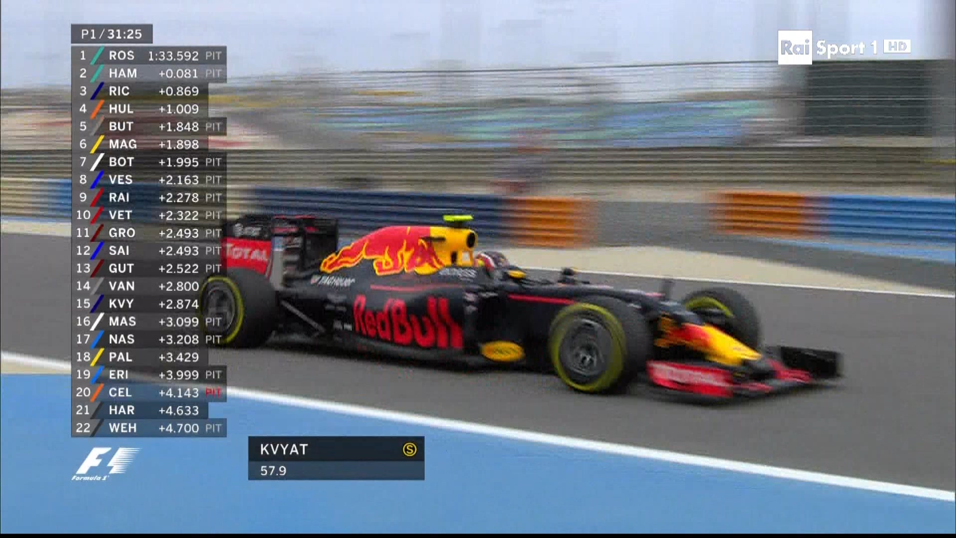

  7. I'm sorry but I can't upload the full recording because my upload speed sucks and it would take forever. This is the first time this issue has occurred in over 4 years of Formula 1 recording. These are samples BEFORE deinterlacing with MeGUI, just cut with Videoredo from the original recording.
  8. I was asking for you to cut a segment from the original (not upload the entire original), but it's unlikely that videoredo did anything negative
    This is chroma mishandling , resized in progressive manner to 4:2:0 instead of interlaced manner, when somewhere along the way it was originally 4:2:2 . Likely the broadcast was 4:2:2 or somewhere upstream in processing prior to broadcast. If it was broadcast as 4:2:2, the DVR or your equipment probably did the wrong conversion to 4:2:0 in a progressive manner
    There is not much you can do to "fix" it
