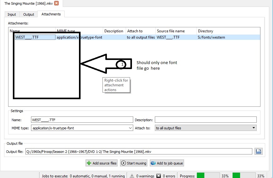

    Mar 2011
    Oregon, US
    [Attachment 36359 - Click to enlarge]
    fig 1
    As in figure 1 I have added 1 file in the attachments part of MKVToolnixGui. If were to add 4-5 more for files would I be able to choose which font will be used? Or would it automatically use the first one it came to? John
  13. Member netmask56's Avatar
    Sep 2005
    Sydney, Australia
    You can do it in the latest version if you wish - when you load a file into the input window to the right is the attachment tab.

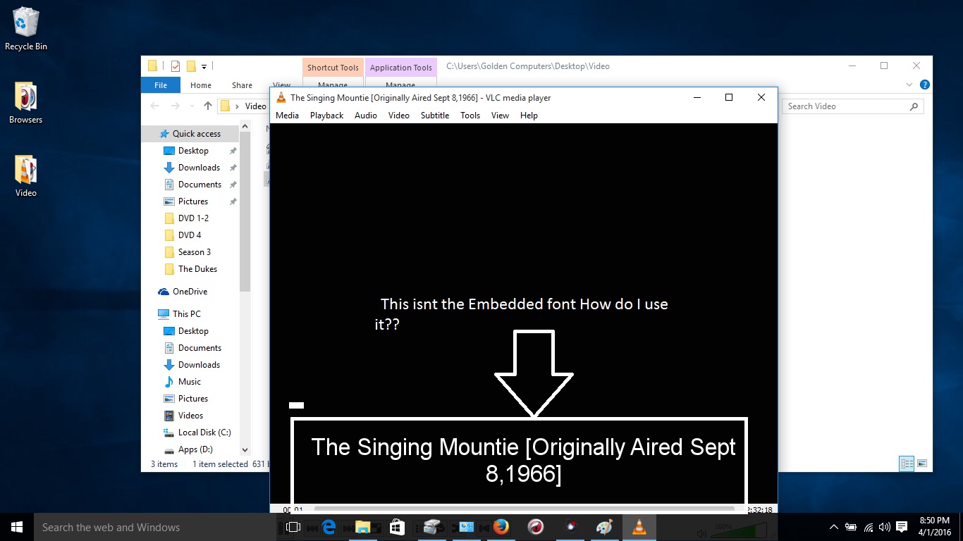

    Here is the fruits of experimentation. Image
    [Attachment 36360 - Click to enlarge]
    I first put the file in and then embedded the font and muxed ! Or was I supposed to save it humm !
    Mar 2011
    Oregon, US
    then I played it in vlc and the header was the original font!!!
  16. Member netmask56's Avatar
    Sep 2005
    Sydney, Australia
    It probably depends on the media player involve. VLC doesn't appear to support it and possibly MKV files don't support it other than for subtitkes. You may get specific support in the MKV forum in DOOM. OR try the MKV home page.
    http://forum.doom9.org/showthread.php?t=155732
  17. VLC does support using embedded fonts but it is not sufficient to simply attach the font to the mkv file. You have to convert the subtitle to ASS format and within the ASS format explicitly specifiy the font you want to use.
    Aegisub can help setting the style.
    http://docs.aegisub.org/manual/Styles

  19. DECEASED
    Jun 2009
    Heaven
    Originally Posted by RBCC View Post
    Do I put the ass file in MKVToolNixGUI?
    Yes.
    If so where? In the attachment section of the program? John
    Nope, it must be placed together with the other streams (video and audio).
