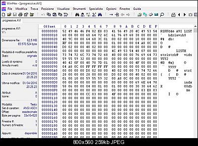

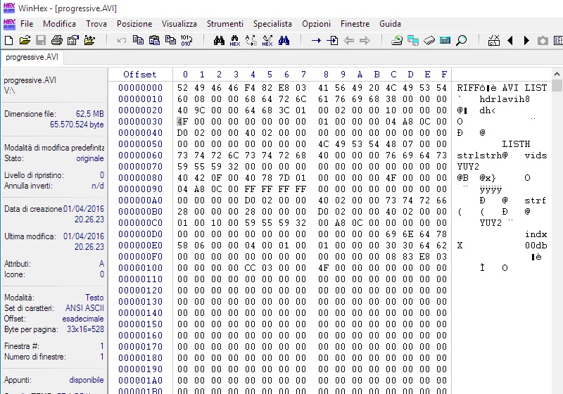

    please consider this 2 uncompressed video files:
    this is recognized from my NLE as progressive:
    https://www.dropbox.com/s/00dnango1nwn8h0/progressive.AVI?dl=0
    and this as interlaced:
    https://www.dropbox.com/s/06vvc4n5asr1iw9/interlaced.AVI?dl=0
    I wonder: in the .avi header where is locate exactly the flag that tell to the decoder if the videofile is interlaced or progressive. What is the hex values that signal if the video is interlaced or progressive?

    The AVI container does not have a flag or header information that indicates interlace or progressive. If the codec used in the AVI container supports interlace it would have to specified somewhere, usually in the bitstream or in the codec-specific data area "strd" chunk.
    Your screenshot shows the MJPEG codec. A MJPEG encoded video stores 2 images per frame for interlace and 1 image per frame for progressive. The NLE probably analyzes the bitstream and detects the 2 images per frame and displays it as interlace.

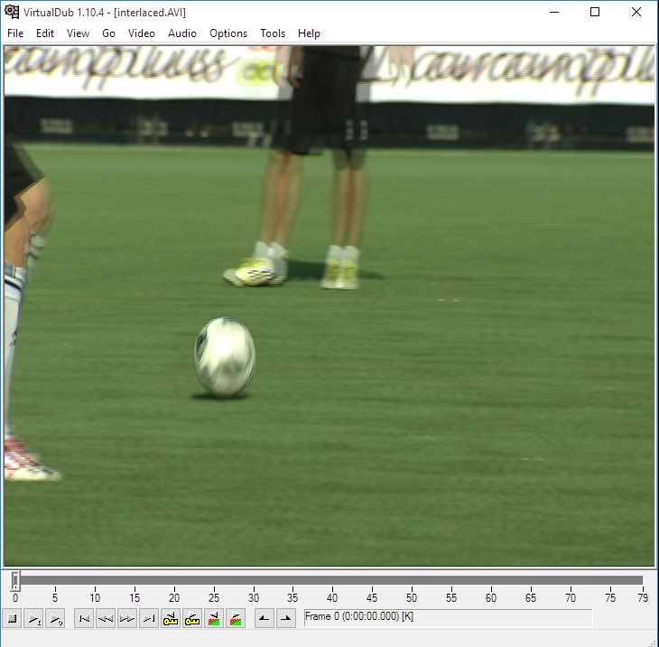

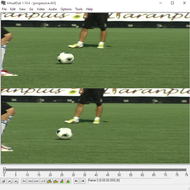

  3. oh sorry cat, I have export in mjpeg instead of uncompress, however now I have correct the post
    please can you tell me if there exist a program that analyze the avi header of this files?
    progressive
    interlaced

    Maybe I am having a senior moment but I thought that, generally, uncompressed video is always 'progressive'. Or to put it another way each frame is complete and contains all the information.
    I wasted some time downloading those samples and the one called 'progressive' is not as such.
