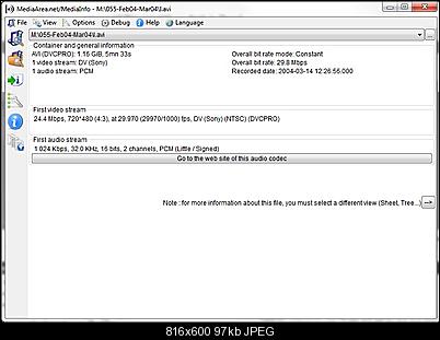

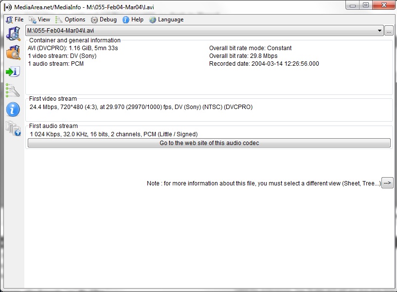

    Above is the MediaInfo report on one of the 'flawed' files. Hopefully that gives the needed information.
    Again, I'm just looking for peace of mind that these AVI files won't cause problems down the road when I'm ready to render larger, edited AVI files and/or when I'm ready to convert them into standard DVDs.
    Thanks again.

    Thanks for posting the info. The video in the AVI is indeed DV, which would be the recommended format for your project.
